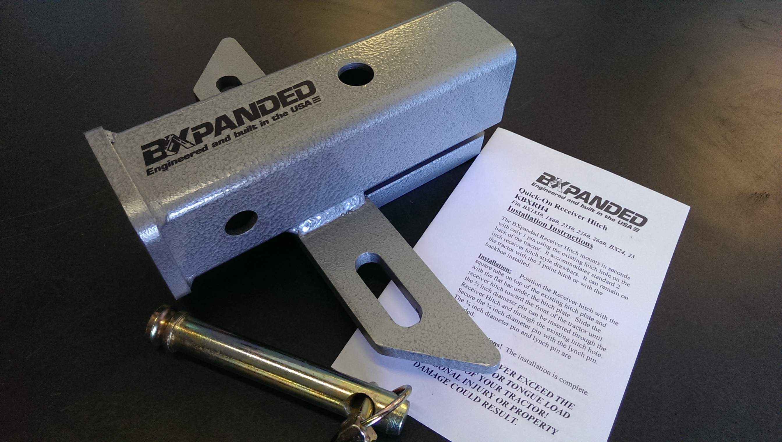

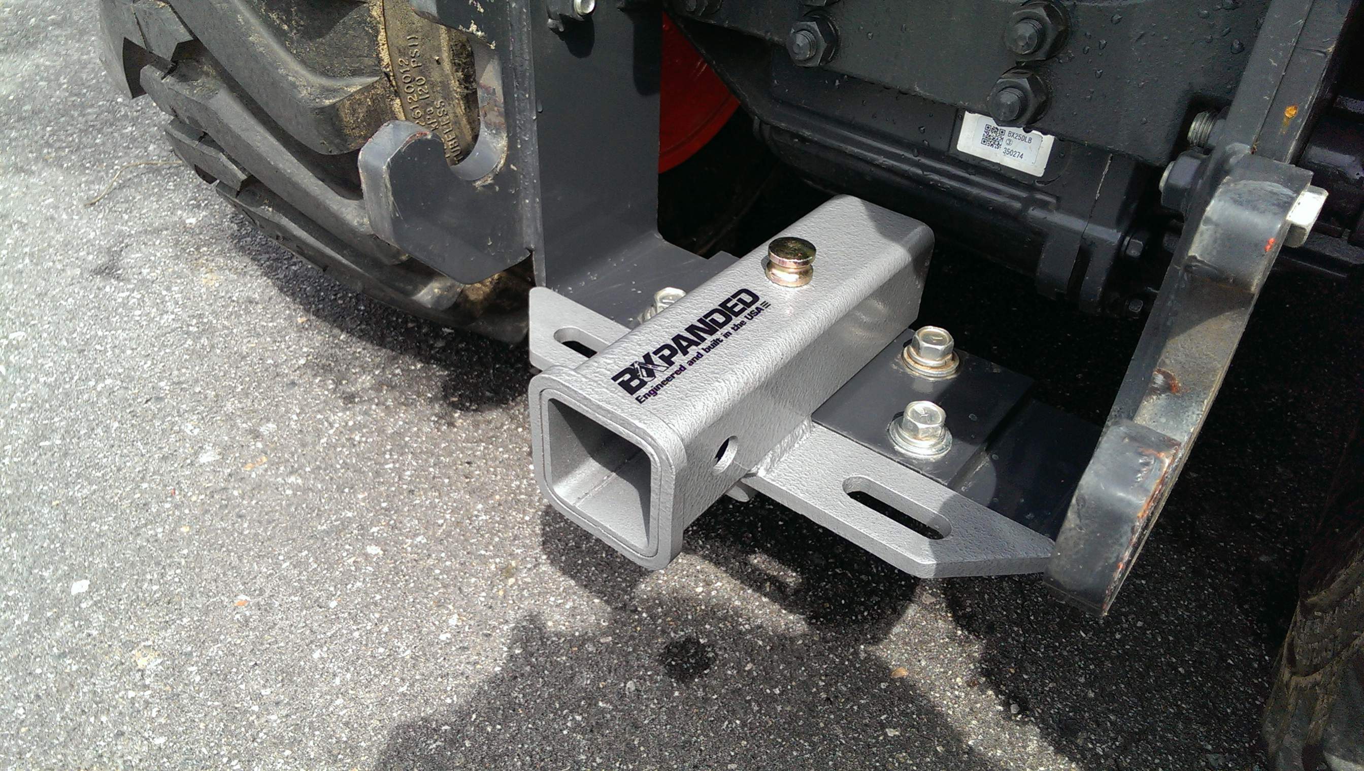

Can anyone think of a reason i shouldn't use this on my new bx2370? Sure would be handy for switching between my draws with different size trailer balls while also moving things a little farther back for clearance on the trailer. Thanks guys.

I modified a near identical one. There were two problems.
1. A regular insert transferred from a car or truck places the ball too low. I had to make up one with a rise instead of drop to match my trailer coupler height.
Then I had a new problem:
2. A regular length insert (inverted as above) placed the ball too far forward, so the quick hitch limited trailer tongue swing.
My cure:
Dual Hitch Extender
I got one of these on sale for about $20. I keep an insert with a tow hook in the bottom and a regular drop trailer insert in the top.

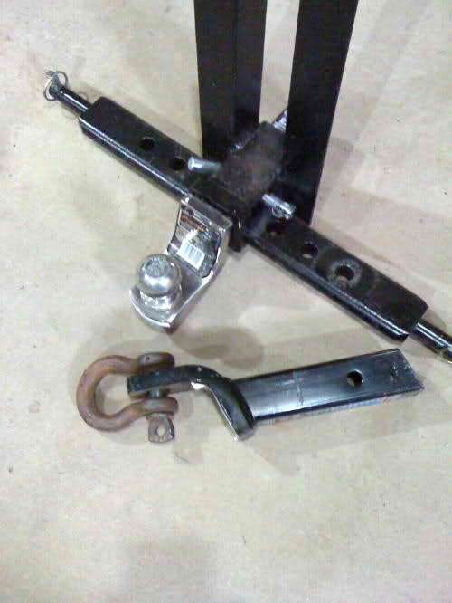

Im planning on making a 3ph set up too. I already have a cat1 draw bar i got from TSC and have a couple different bolt on Reese hitch receivers from old trucks etc in the barn that i will use as my fab piece. Plan on bolting one to the draw bar and then making and welding a top link mount bracket in an "A" frame shape to keep from spinning by attaching to upper link. It will be ugly but hopefully functional.

Made one for the 3ph,,, trailer hitch.jpg Have many uses for it.

If you use the 3pt to mount a hitch ball, consider tying the hitch to the fixed drawbar.
The 3pt on most tractors doesn't have down force and can rise up if the weight shifts to the rear of the trailer.
This can cause some really scary situations on hills or while backing up.
The chain from top link to drawbar prevents any unwanted lifting:
