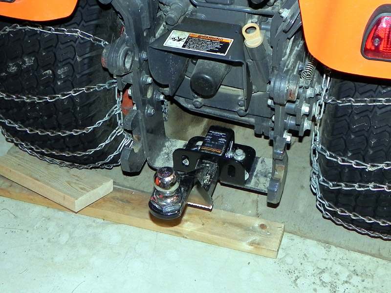

We have a pin/ball mount which is welded and bolted to the lower plate on our BX2660: Mad Dog Gear® Three Way Hitch - Tractor Supply Co. (was cheaper than that though).
You could also weld one of these one: Reese® Farm & Ranch Receiver Tube, 6 in. - Tractor Supply Co.
Or bolt one of these on: Reese® Farm & Ranch Step Bumper Hitch, Class II - Tractor Supply Co.
IMO, their price isnt that bad (based off of similar stuff st TSC).
Aaron Z

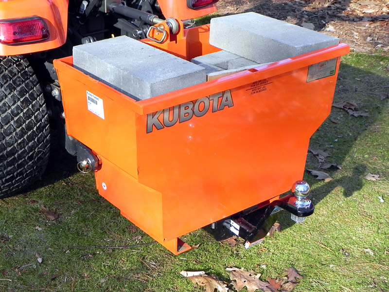

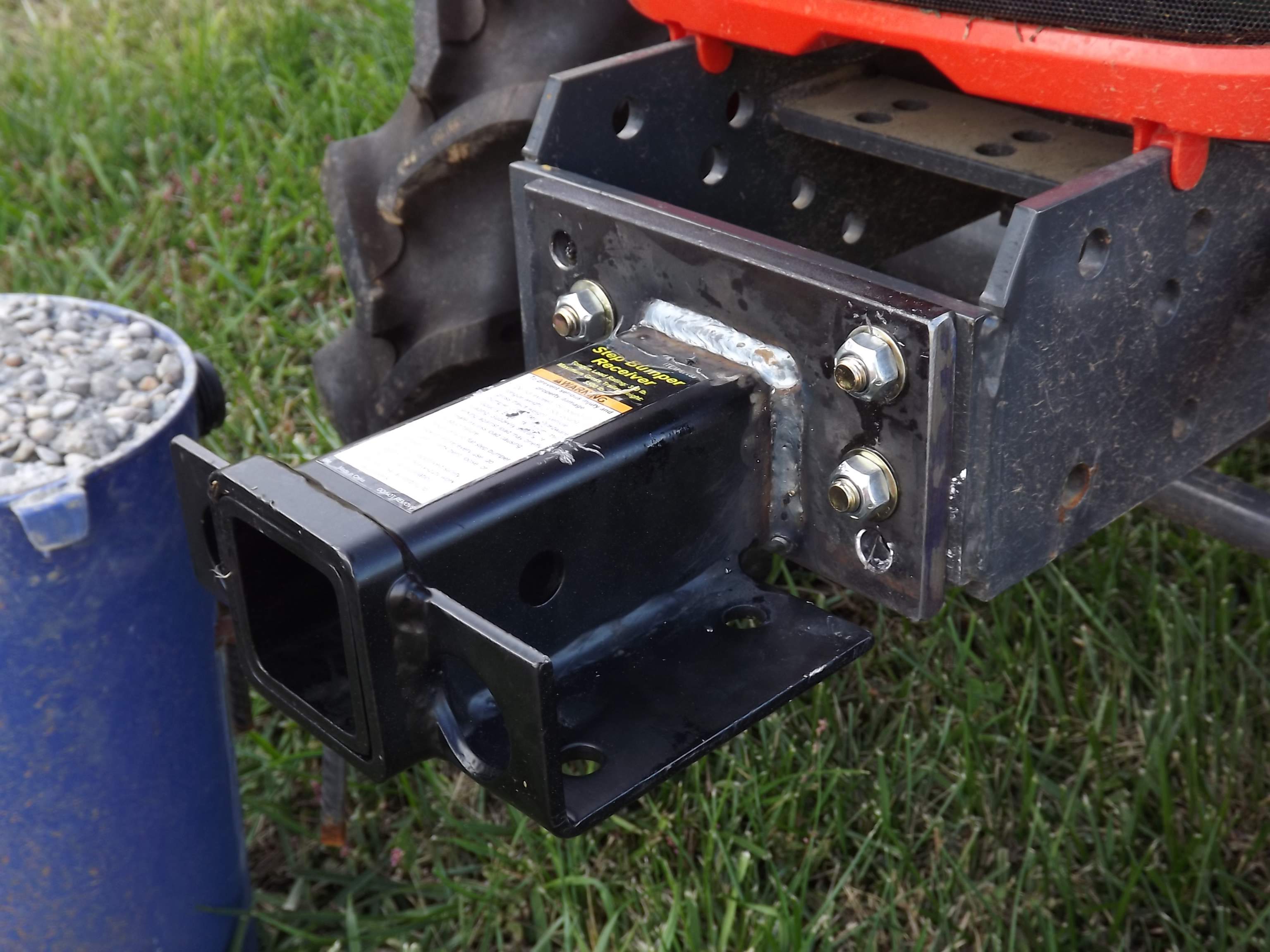

I installed that Reese receiver on my ballast box 3 years ago and move my 2000+ lb boat with 300 lb tongue weight all the time with no problems. It worked so well that I've added one to the rear of the tractor for when the ballast box is off. As I recall I had to open two of the bolt holes a little; the other two were a match. I seriously doubt any BX is strong enough to wreck this Class II receiver. You will lose traction first. That's 2 more cents.
