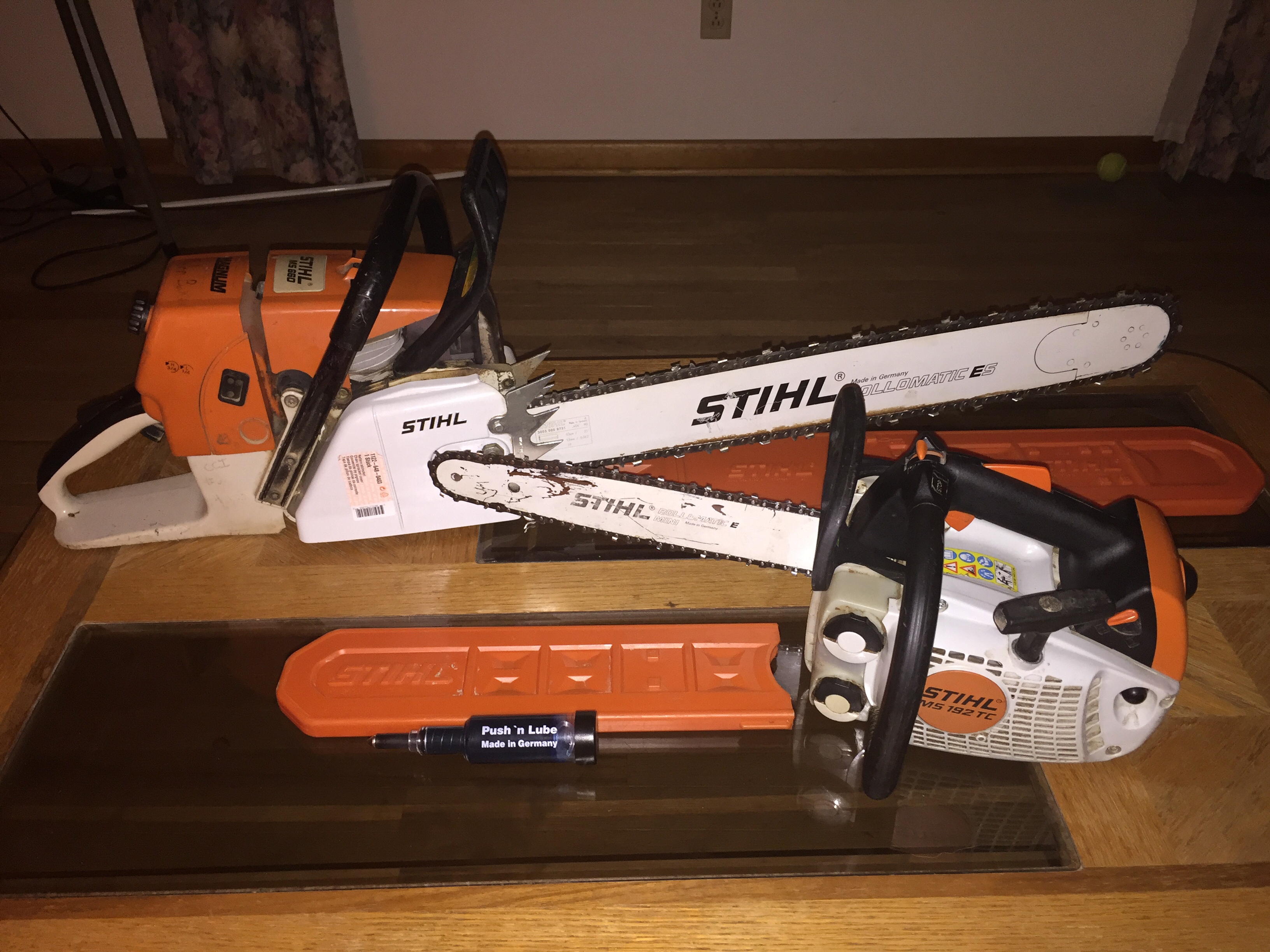

This what I use. My husky 545, which is lower end pro model, you can not great sprocket on bar. Probably gets enough from oil on chain.

I use this type also, works flawlessly.
Just last week I pulled all the saws out, cleaned them up, pulled the bars off, greased them all up and put them back together.

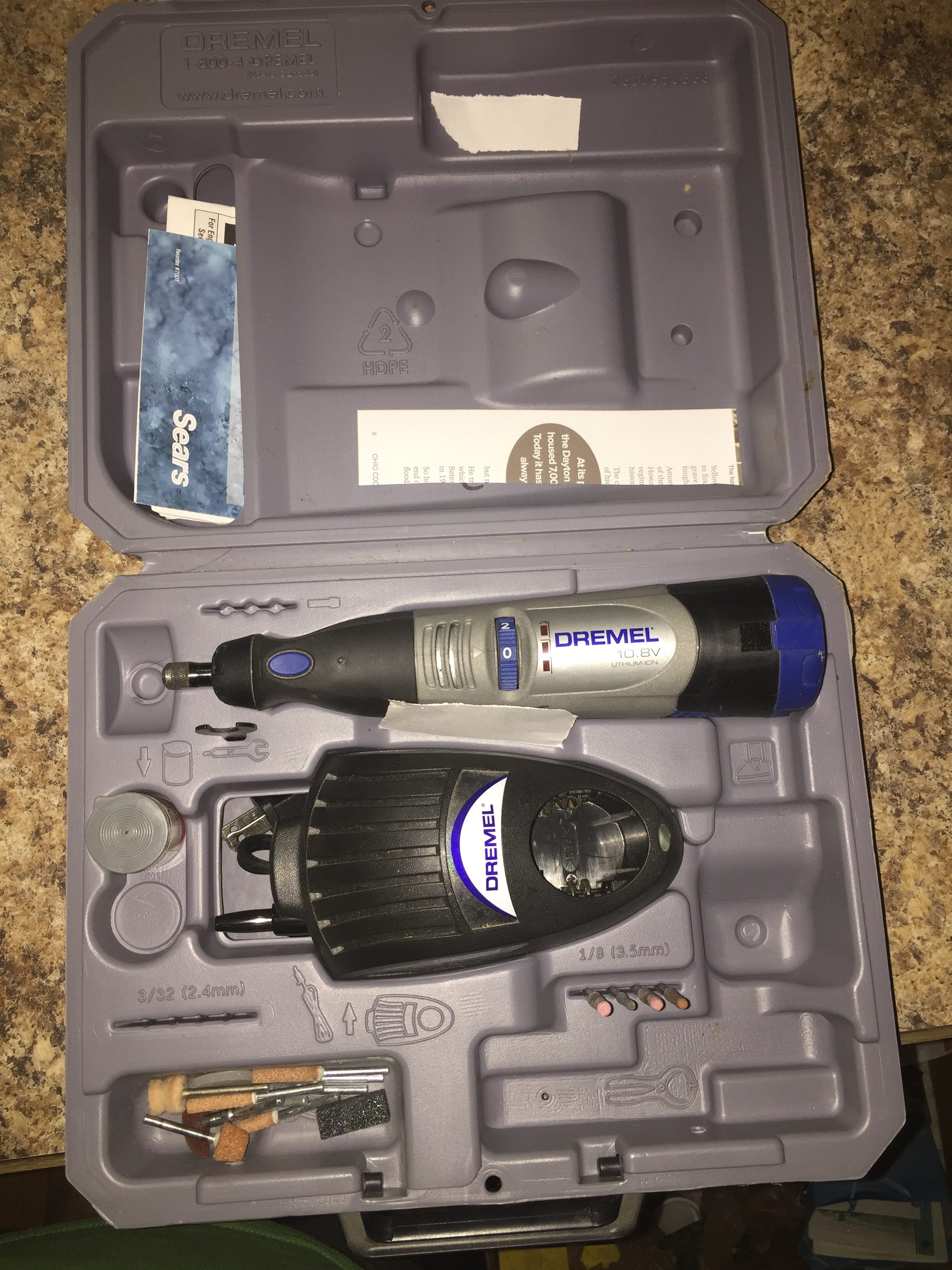

That's my method to sharpening blades, I take that in the woods with me to sharpen as needed. I can get about 6-10 chains sharpened before I need to recharge it.
