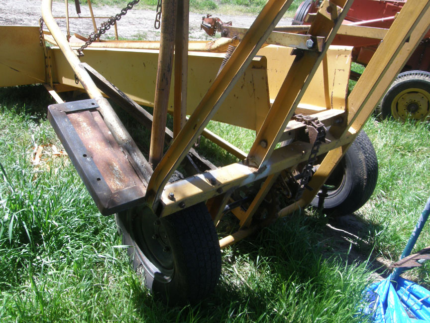

I think a lot of us would like to see the ground bale pickup elevator. I used to have one, never used it, and scrounged the chain sprockets off of it for other uses. Maybe I should consider resurecting it.

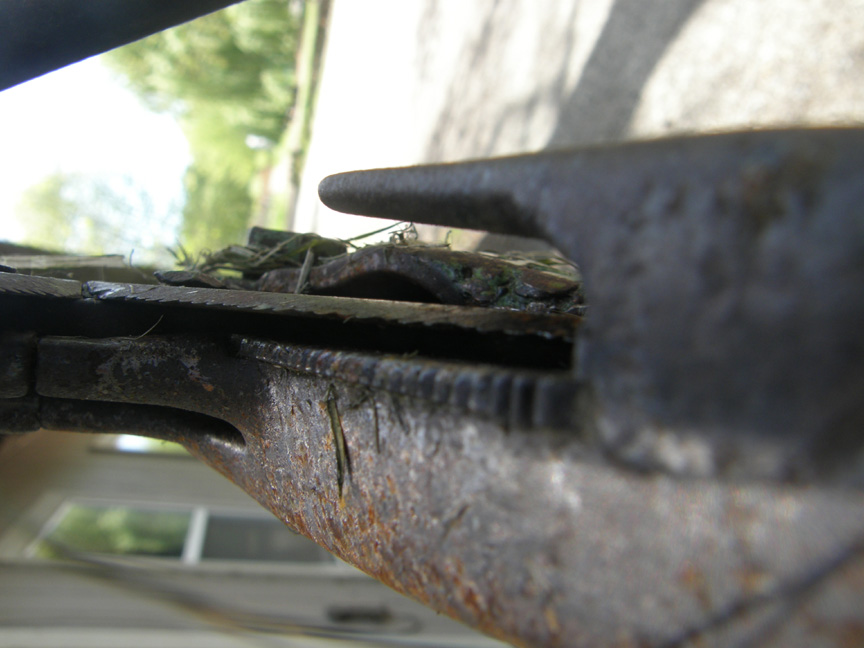

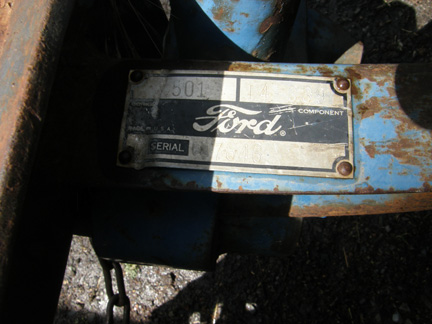

Turns out it is a NH 501 sickle mower - it was hard to identify from the drawings since many of the sub-assembly parts are similar to 45's and 451's.

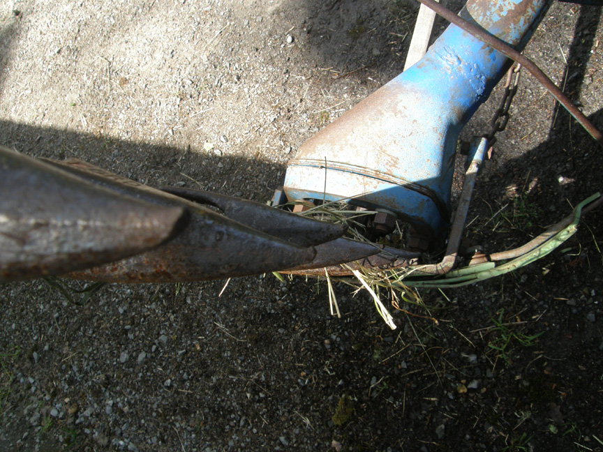

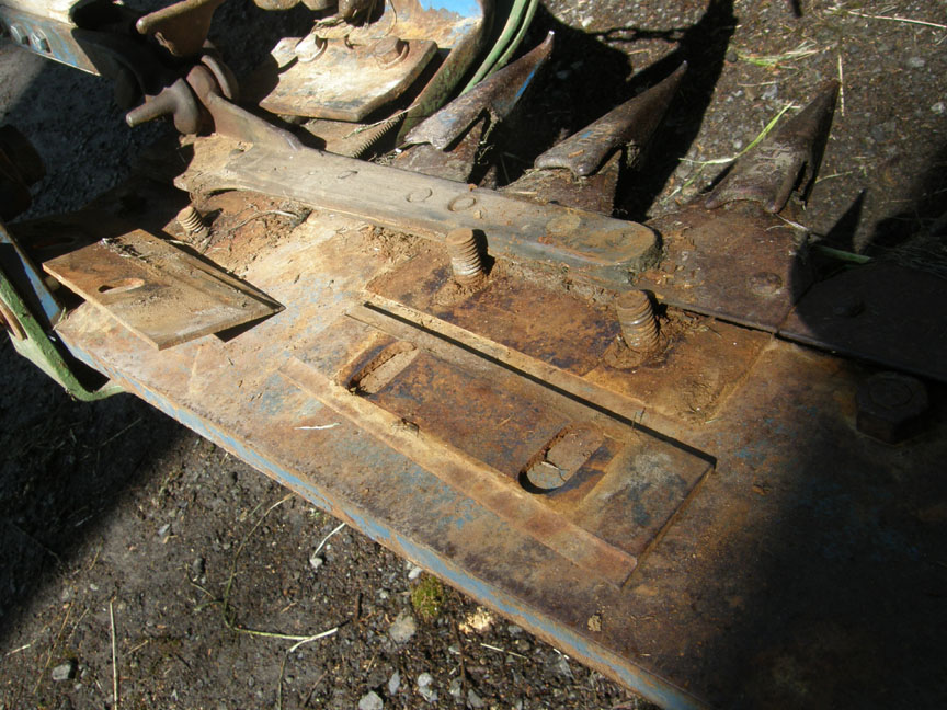

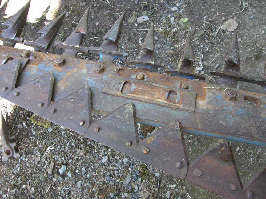

I rebuilt the bar over the weekend, but did not try riveting new cutter knife sections - only one section is broken so I let it be. But the guards are fairly worn and bent, several have been replaced with JD and MF guards which apparently fit but don't fit perfectly. The plates on the guards do have serrated edges but they are rounded over and not sharp at all. But they may still hold the grass, which seems to be their purpose.
Overall, I think I'm going to have to buy a better mower. This one has mowed many, many acres and will do for now, but its pretty worn out.
If you see anything I should fix in these pictures, please say so. Here are the pics:

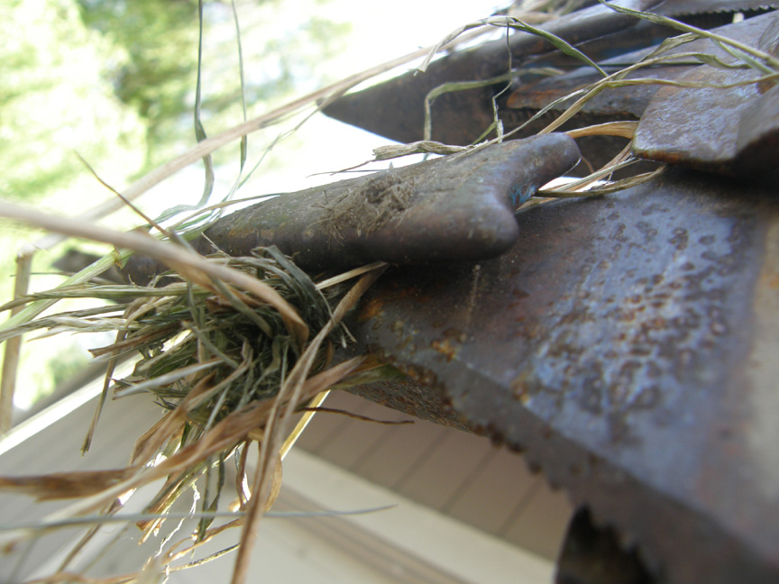

Here's some more pics showing the grass buildup at the tip of the guards, one of the guards removed, and the shims. I guess the shims are sacrificial, rather than wearing out the guards or the bar itself.

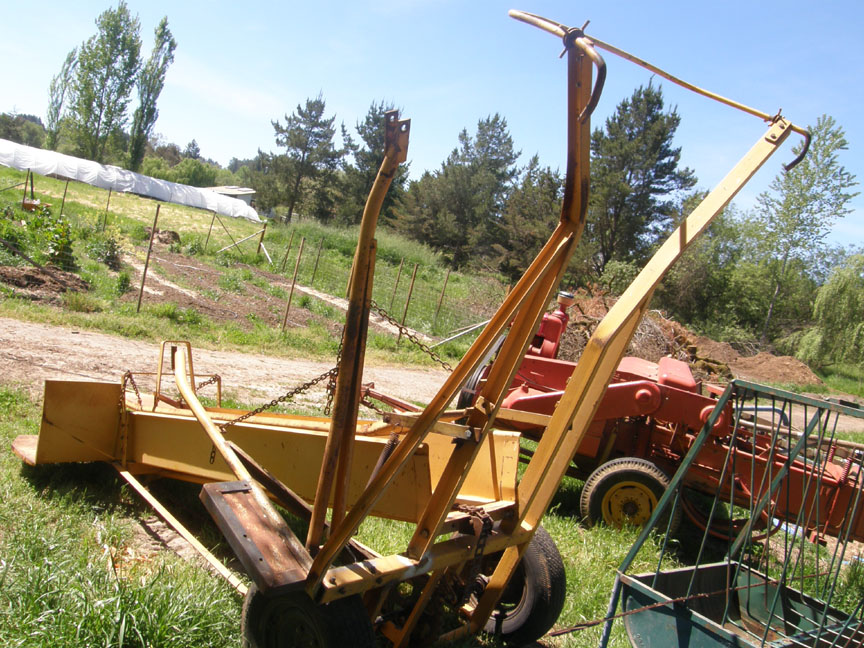

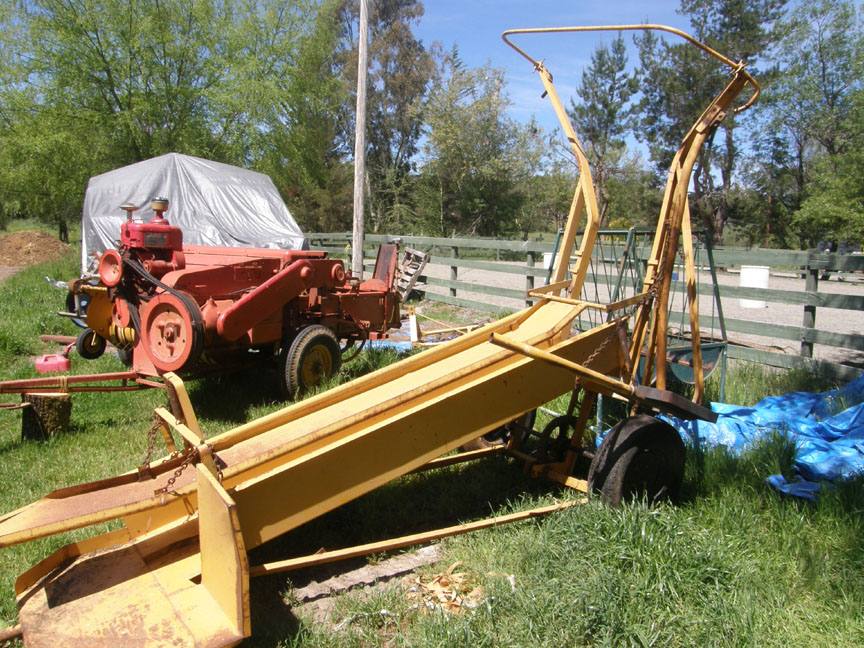

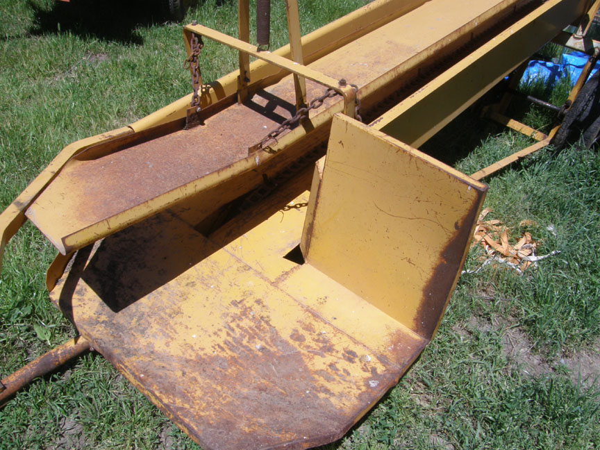

Also here are pics of the bale-picker. Its tipped down for towing, normally it runs with the chute sticking up in the air, and the opening (currently at top of pic) rides along the ground and guides bales into the chute. The chain going up the chute has teeth sticking up about 3 inches, about one per foot, that grab onto the bale. The chute has a floating top bar that keeps pressure on the bale against the chain with teeth, and is adjustable for various sized bales. But the baling machine, and probably this bale-picker, are designed for 50-60 pound bales, somewhat smaller than normal bales these days.
The chain is driven by the tires, and a solid axle (no differential) so it doesn't turn corners very well. There are several welded spots, presumably repairs, and it looks like somebody added a guard on the towing side, probably to keep it from running into the truck or trailer it is loading.

Actually, that'd be a F.O.R.D. 501. They pre-date the current "New Holland" tractor brand and go back to a time when New Holland and Ford had absolutely NOTHING to do with each other.
The Ford 501 is a pitman style mower, a totally different concept from a NH451.
Still a good mower though.

Looks like the guards align the bar at different positions. This makes it impossible to keep the cutter bar entirely in good register. New set of guards at a minimum. TSC has them in bins. Get the ones that work/fit with your knife bar.
You can stick a long length of 2" pipe over each guard tip and bend it up or down to get them all at the same angle.
Other than that, looks like a decent machine worth restoring to its full potential.

So you mentioned that the cutter knives should not actually ride on the guard plates. Are you saying they should touch, just not have much friction? Or should they be 1/16" inch apart or more? Seems to me that for scissoring action to occur correctly, the knive and guard should slide over each other. But at 540 slides per minutes, I can see how it would wear down quickly. Anyway, it seems like the tolerances of the knives and guards is the key to getting it to cut correctly.
You know, the first time I saw the bale-picker, I started thinking about what else I could make it into as well. Chutes and chains and gears have all sorts of uses. With old but working hay wagons selling for $3K, this bale-picker probably won't see much use.

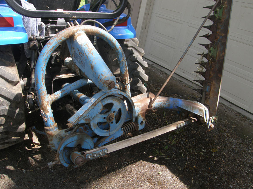

Yeah, I'm not using any of the stabilizing arms, and I have a hydraulic top link so don't need the heavy spring at the top of the mower frame. The only issue I have is the spring-loading holding up the bar is attached to these stabilizing links which pivot on the bottom of the frame. So, without the links hooked on to anything, the spring holding the bar has nothing to push against. But frankly, having the outboard end of the bar just slide on the ground seems to be working fine. I guess the whole bar can rotate out about 30 degrees if the end gets hung up, so as long as it doesn't do that constantly, it should be fine.
I was not able to remove all the linkage, so just used some baling wire to tie them out of the way. Seemed like an appropriate fix.

$2000 for all that neat stuff!!! Some guys have all the luck.
Seriously, you made an excellent buy. That baler looks like a winner. Wire or twine?
