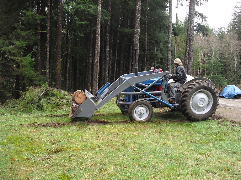

It stopped raining finally, so I was able to test things out a bit. I moved around some wood, and was happy not to be lifting them into the back of the truck, but just rolling them into the bucket.
One problem I had was that there was intermittent venting going on from the cooling system, although the engine was not overheating, apparently. I have seen the temp gage climb and fall in a way that should not be happening. No leaks in the system, so it went over pressure. I am going to drain it and check on the thermostat, which is my first guess. Perhaps it is stuck closed, or just not opening enough.
   / Refurbishing a Ford 850 #27
DO check the thermostat. Also check your coolant level, if you were low with a big bubble in there, it can cause similar issues.
