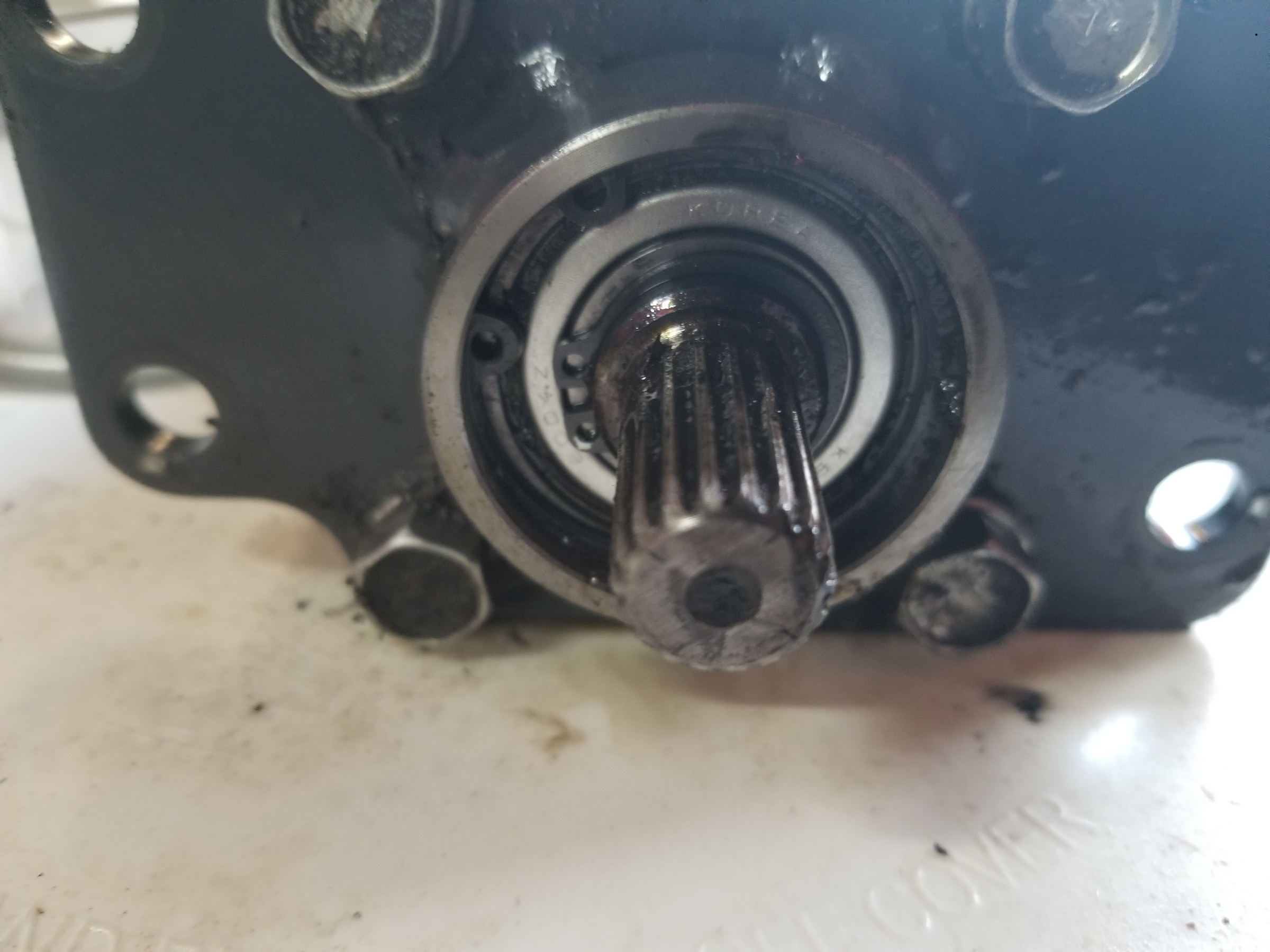

Get a seal then see if it's still leaking , Any play in the shaft.......
/ Refurbishing an L45 #22

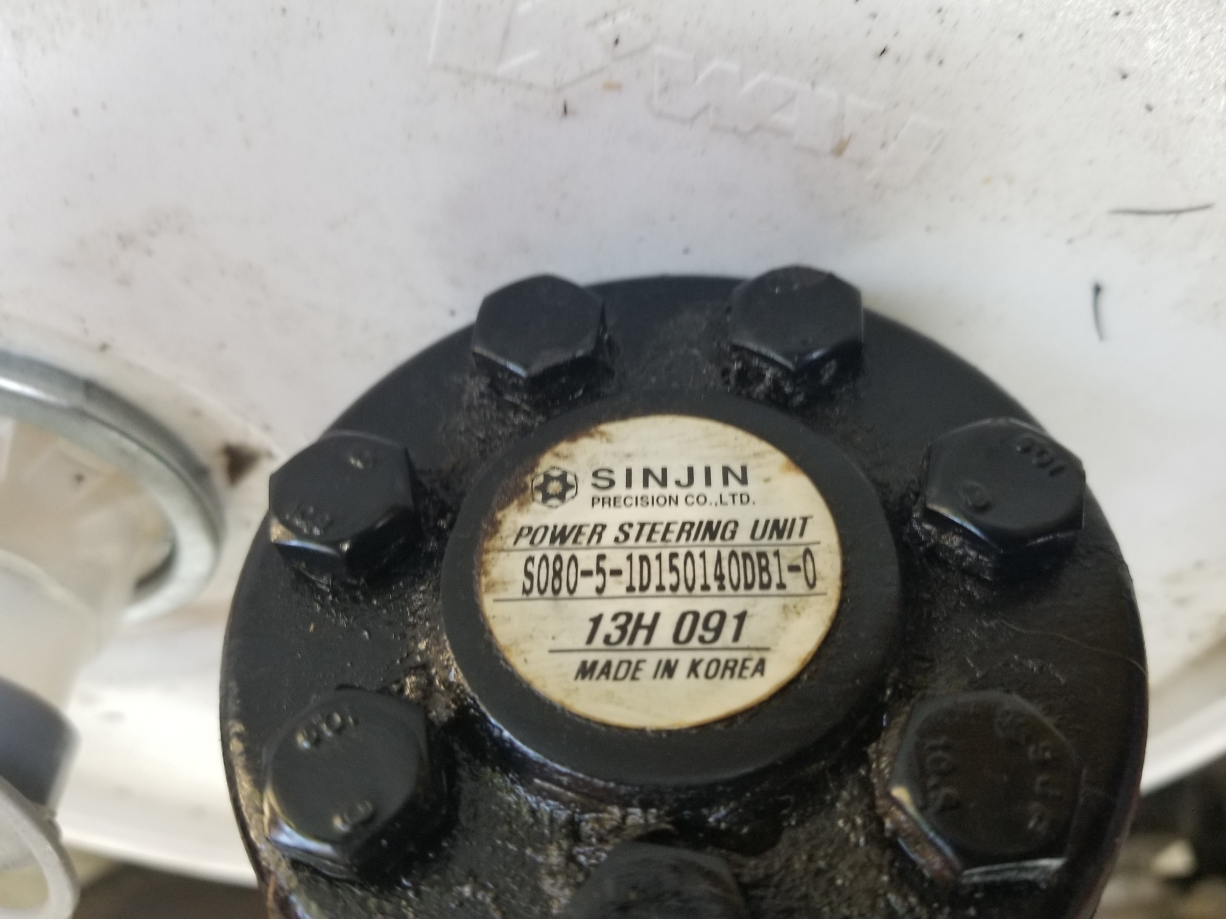

I believe this is only used on the L45.
I seems hard to believe that there is not another manufacturer worldwide, that uses that pump for something.
Have a seal kit coming from Kubota. No play
You would think, right? But I am unable to find anything and when I google the #s and manufacturer there are some unsavory websites pop up
You might take a look at E-Bay items: 273448179805, and 303339175142.
If not: The SIN JIN phone number in Korea is: +82 62 954 0951
Many Koreans do speak English, or perhaps you know of a Korean locally, who could make the call for you.
Koreans are generally very helpful people.

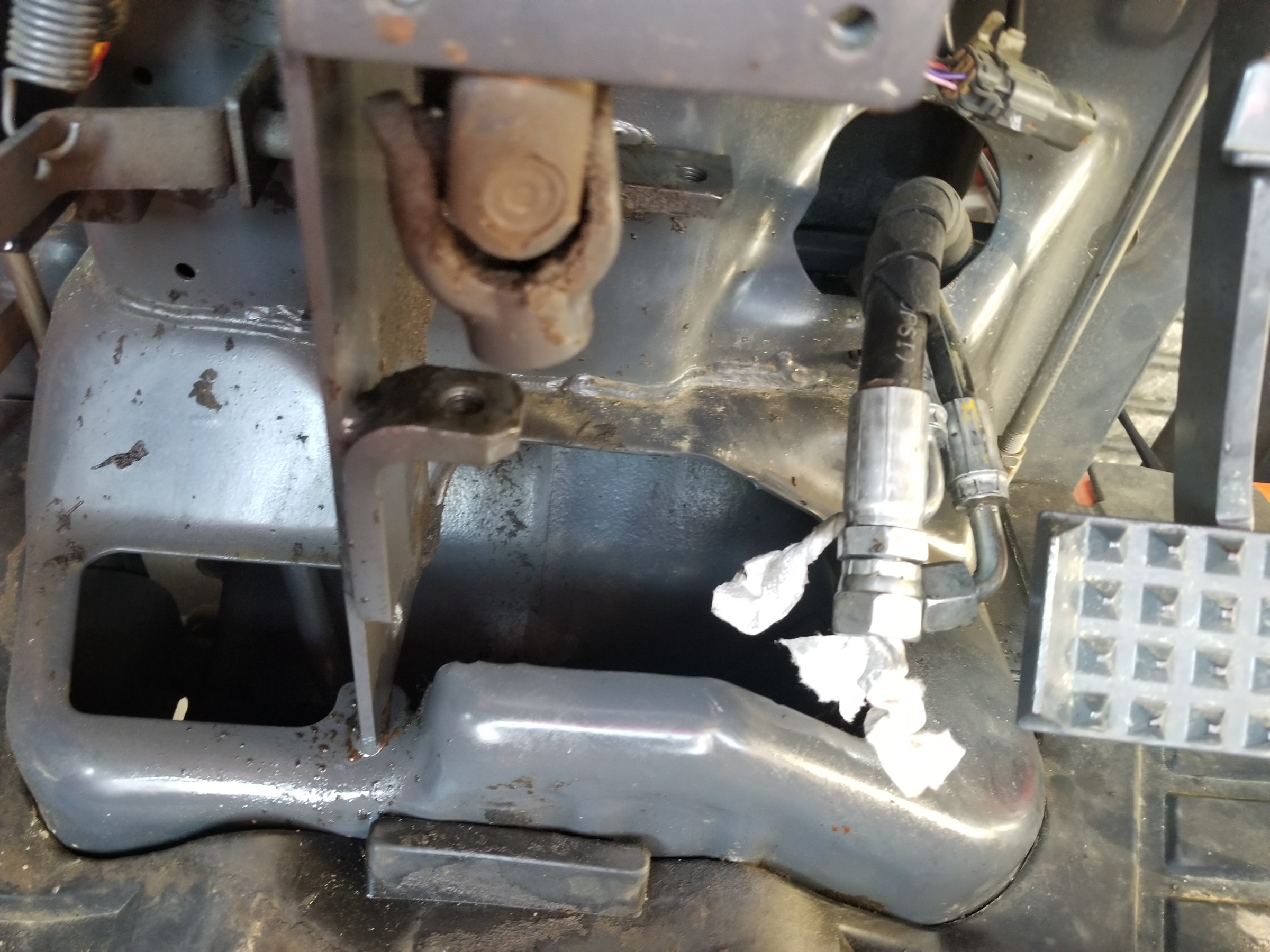

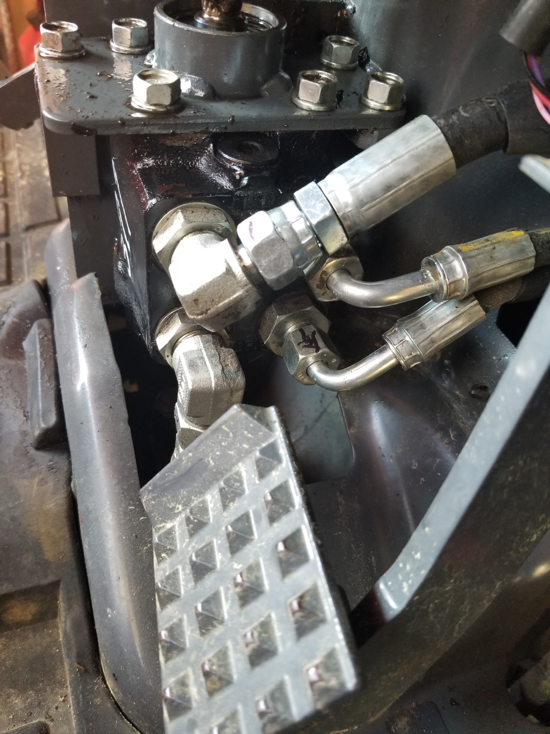

Going through this with an older Allmand (Terramite clone) TBL for a friend. Eaton steering valve, but its been discontinued for a while, as have the rebuild kits. They have a similar replacement, but an 8 month lead time. It's a bit funky with ports on the bottom instead of the more common side ports & a sense line.
They are pretty standard valves & you should be able to find generic replacements if you know the specs. May or may need to build a new mounting bracket. I've got a hydraulic guy trying to rebuild it. If not I'll find out how well I understand what I think I know when I source a new one & probably have to fab a new mount & hoses.

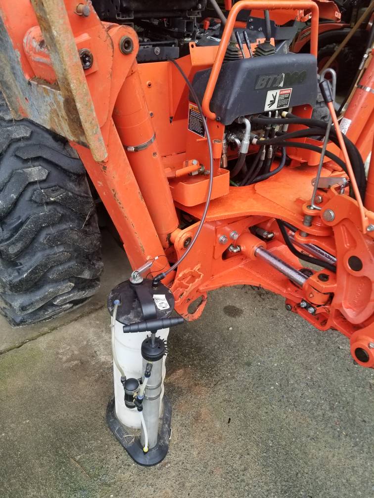

When my drain tub wont hold 12 gallons I use the Mityvac fluid evacuator. Helps keep things from getting messyView attachment 646420
Getting old here, but with the virus about I'll probably be doing my own maintenance for a few more years.
The downside is I'm not much interested in crawling under a machine and dragging an tippy oil pan through the dirt.
So I've been thinking about using some sort of fluid evacuator on all my vehicles.... and then saw your picture.
Is the Mityvac the answer?
When does it work and when not?
I'm ignorant on these things. For years I had a shop with a lift, but no more. I just started thinking about alternatives and haven't even done any research yet.
My first thought was to look for some sort of rig like the Mityvac but that mounted in the lid of a standard 5 gallon pail. It could be driven manually with a pump or via a small pump motor.
rScotty

You can buy inexpensive dipstick oil drain pumps on E-Bay.
I am too old to crawl under cars anymore, so I use one for car oil changes.
The pumps are 12V cheap Chinese junk, are quite slow, but they do work.
If the engine oil filter is under the car......you gotta problem.
Most tractors are much taller than cars.
For tractor draining, I just pull the plug, drain the oil, replace the filter, plug and oil.
Then back the tractor away, and pick up the pan with oil.
No dragging necessary.

That is a Mightyvac and it comes in real handy but isn't the end all be all. It wont suck the rear dry, only reaches about 6 gallons so I still have to get under the tractor
