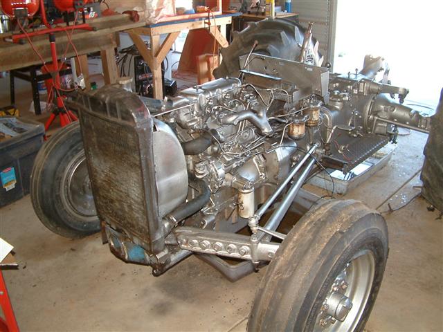

Because of possible rain I'm not going to paint today. Instead, I'm working on the fitment of the new sheetmetal I just purchased. Let me tell you. The fitment is not even close to factor specs. So get your drill out and get ready to pop a few new holes to get everything to line up.
I used a 1/4 20 tap on all my threaded pieces. The new peices come with M6 1.0 threads. Cheaper to buy SAE bolts and nuts. :thumbsup:

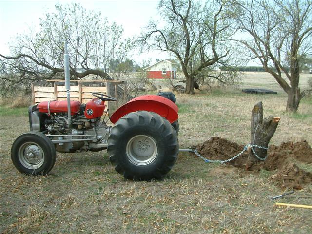

What size wheels to do you have on your 135. I have seriously thought of going with turf tires on mine. Mine are 12-28

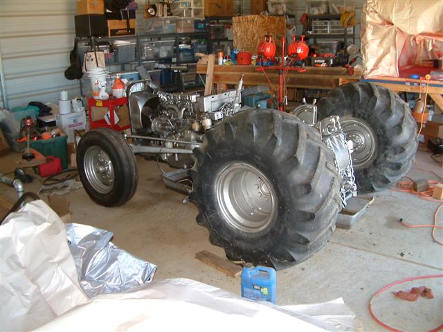

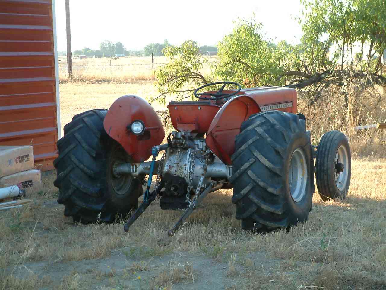

   / Refurbishing my Z145 135 #27

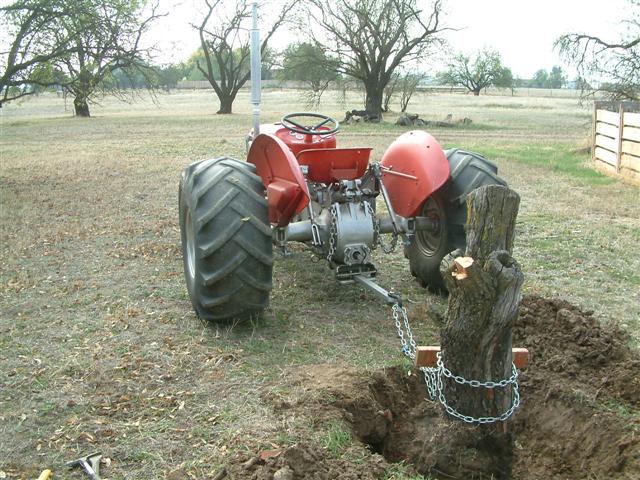

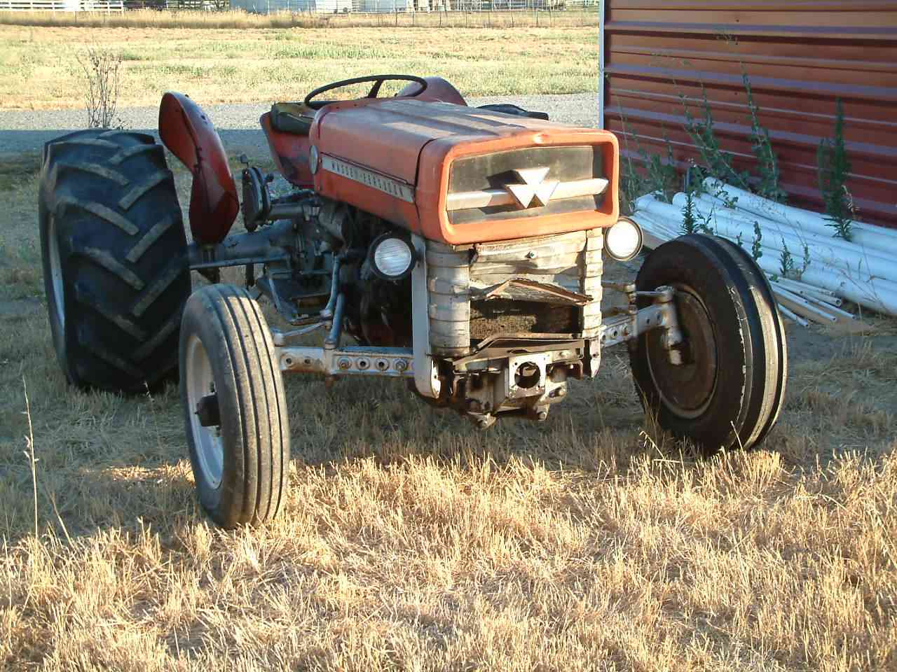

Those rears are BF Goodrich 18.4-16A 6-ply (18" wide, 16" dia rim, 40" tall overall). My 135 is a field tractor that has been converted to squat low for work in the previous owner's olive orchard (discing, flail mower work, etc). The front spindles are shortened to keep the tractor level. You can get those rears at most rural tire stores that service the ag community. That size tire is used on combines and other large ag equipment. It would make a nice, safe tractor for mowing steep hills (my place is a flat 10-acre parcel).
