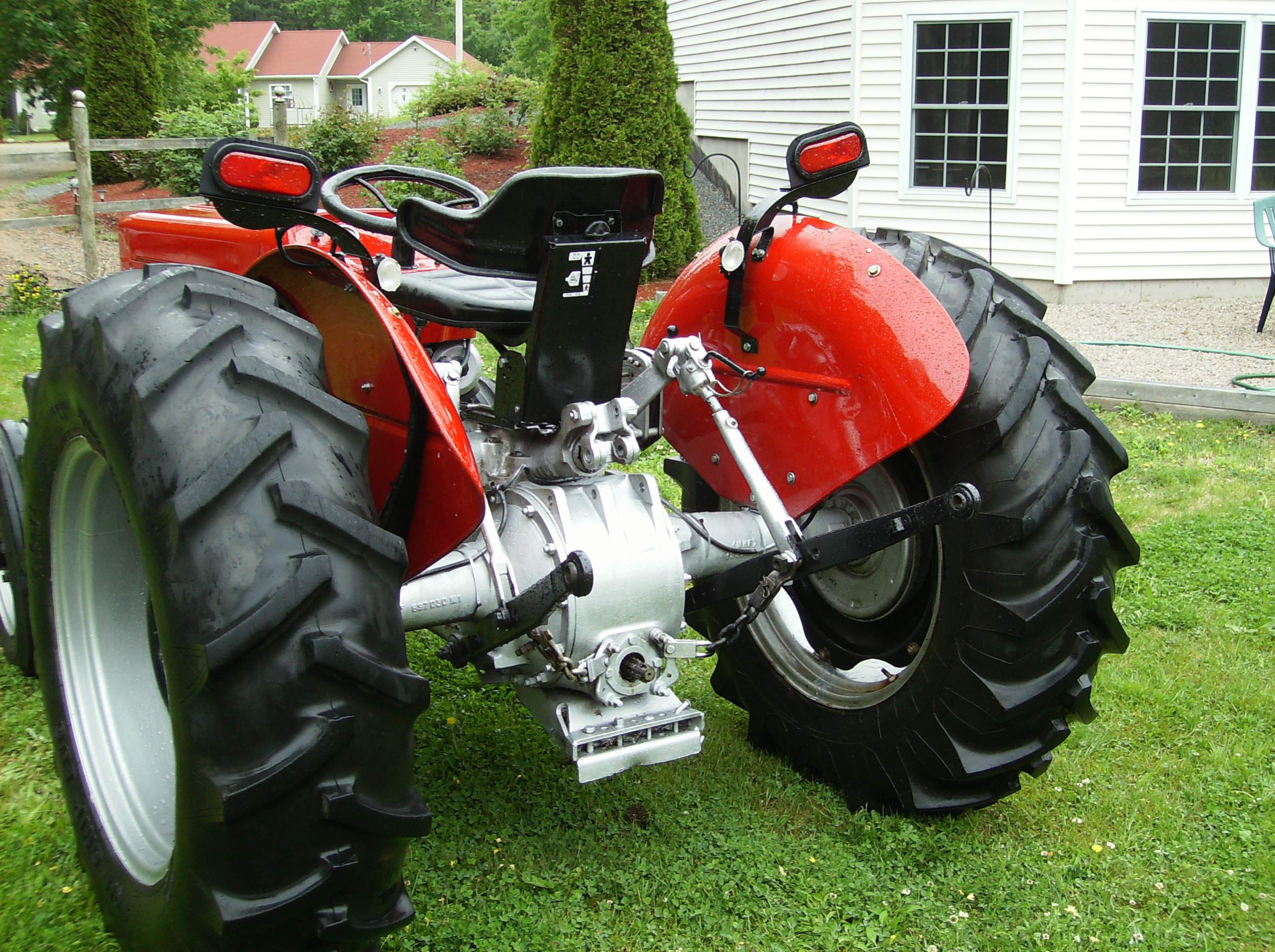

That paint is a nice match, looking good.
I did something similar to what you want to do for lighting. Snow removal for me involves working near a secondary highway and from the rear the tractor wasn't well lit and, as you state, I sometimes travel on the road for short distances.
I manufactured the two brackets, LED trailer lights and LED fog lamps made the world of difference. No brake switch but I did install a flasher and a switch so that I can either have them on steady or with the flasher, made a world of difference and draws very little current. The fog lamps are LED as well, they are small but throw a surprising amount of light behind the tractor, and provide a much wider field of view than the stock rearward facing light I had on it.
