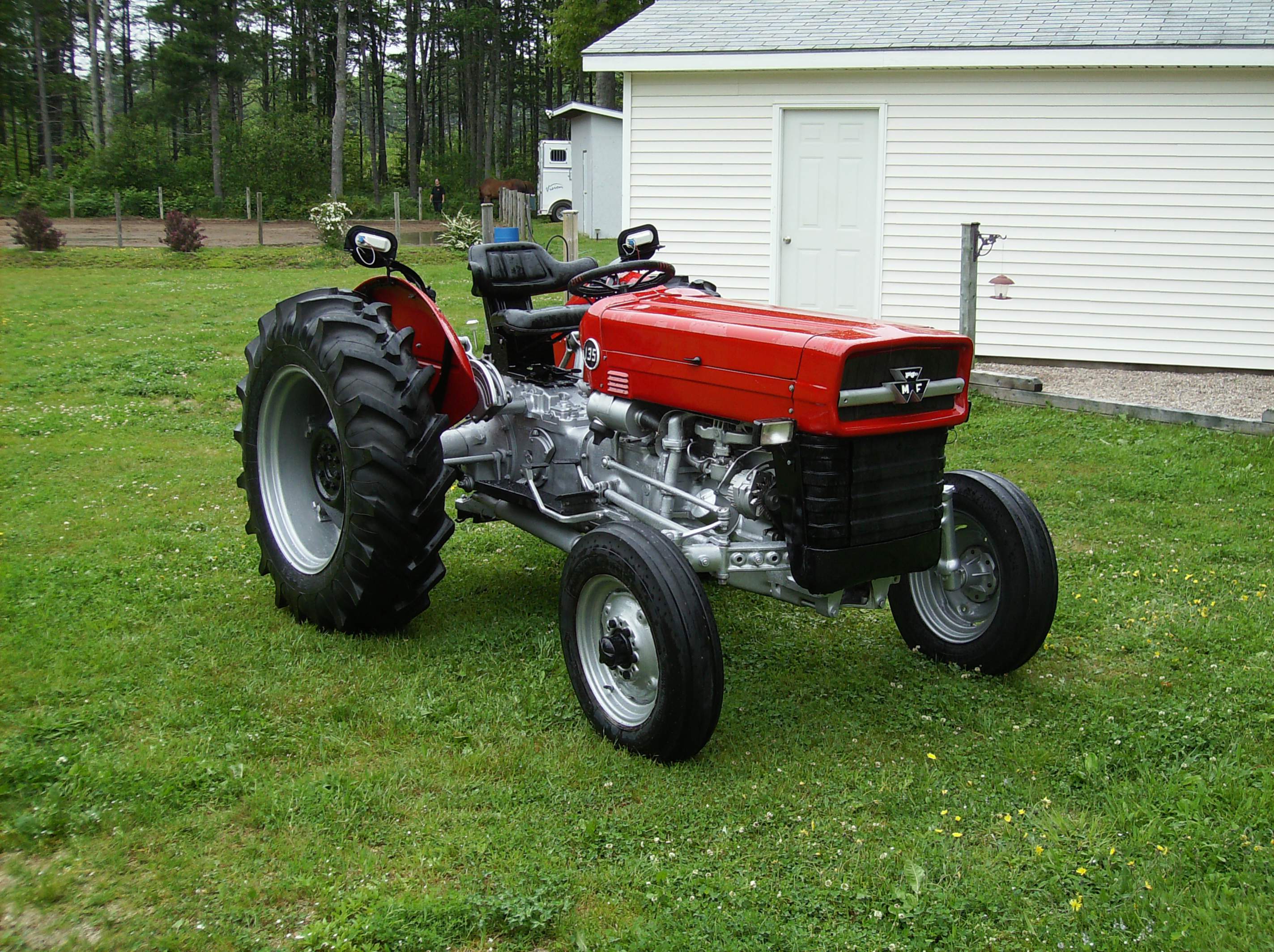

Sounds like what you have planned with the heat shield and re-routing of the filter should solve your problem. Having replaced the manifold gasket on mine I understand why someone may have become frustrated with the heat shield, it can be a bit of a pain to install but it is a necessary evil.
I wish I was home, I'd take a better photo of the shield for you to see how it is mounted. In the attached photo if you zoom you'll see the shield is mounted near the air filter at one point to where the tractor is split, and up around the top of the manifold. If I remember correctly there were three of the upper manifold bolts that are used as attachment points. It wouldn't be terribly difficult to fabricate, no compound bends to worry about.
Sounds like what you have planned will work as well, just thought a pic of what the original on mine looked like might prove useful.

I did something similar to what you want to do for lighting. Snow removal for me involves working near a secondary highway and from the rear the tractor wasn't well lit and, as you state, I sometimes travel on the road for short distances.
I manufactured the two brackets, LED trailer lights and LED fog lamps made the world of difference. No brake switch but I did install a flasher and a switch so that I can either have them on steady or with the flasher, made a world of difference and draws very little current. The fog lamps are LED as well, they are small but throw a surprising amount of light behind the tractor, and provide a much wider field of view than the stock rearward facing light I had on it.
