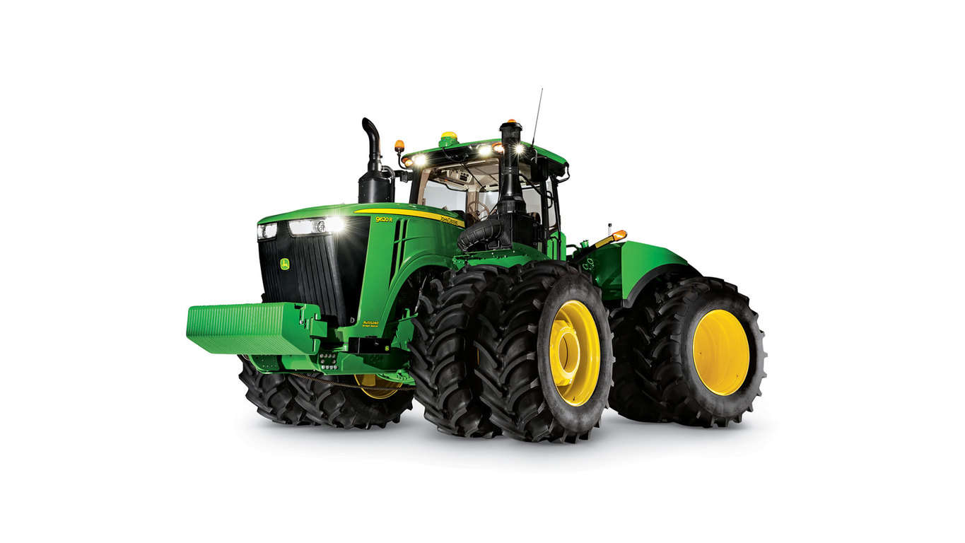

Large ag. tractors like this bad boy are 4WD all of the time.
Steve
That is a 4WD tractor.
Using the term 4WD with our tractors is a common mistake. But we have been doing it for so long that is has become the norm and some even think it is now factual. If your lawnmower or tractor is articulated and all 4 wheels are powered, it probably is 4WD. Everything else is Four-Wheel-Assist (FWA).
Just curious. I understand all true 4WD tractors have the same size wheels front and back, but are they all articulated?
Steve
Steve
In a word, yes.
Steve
There are a lot of differences between this and an FWA. #1 is weight distribution there is very little weight on the rear until it starts getting drag on the drawbar which is not when it is going down the road. #2 articulated steering which means the rear tires follow the same path as the fronts, i.e. the wheels have to go around the same number of times vs a front wheel steer where the rear takes a shorter path around a corner. #3 the entire driveline is built much heavier to take the slight variation between the axles. #4 Ag tires - the lugs flex a lot more than R4s or others.
To answer another question there were some early 4WDs that were not articulated - IH 4166, Case 70 series and a few others - but they all had drivetrain issues. Steiger and Versatile were articulated and the others soon copied.

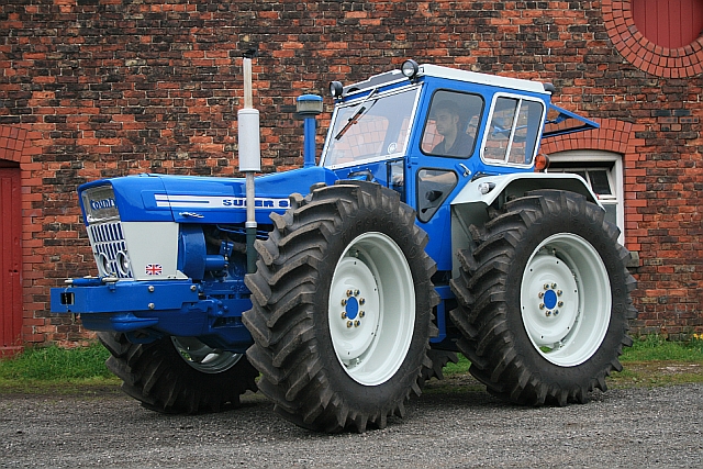

This reminded of a County tractor that I saw on a show from the UK that used to air on RFD-TV.

I don't recall windup being a problem on the counties. I think the driveshaft to each front wheel had a lot to do with it.

I'll bet that thing would hop around the corner!
sweet looking tractor though...looks like a Ford built in England
most of us have never heard of County tractors
