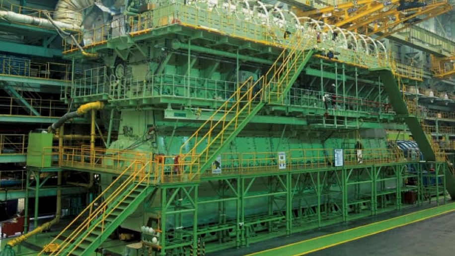

Torque, RPM, and HP are directly related. Easy calculation. HP = (Torque x RPM) / 5,252. Simple
HP is 550 ft-lbs.sec HP, torque is ft-lbs, rpm is revolution per minute. Easy and direct. HP is calculated from measured torque on a dyno. The two curves rather obviously cross each other at 5,252 RPM. Below that speed torque is higher; after that speed HP is higher.
So, a 2,000 rpm diesel is a torque monster, while an 8,500 rpm car engine is a HP monster.
No mystery. The highest rated diesel in the world is the Wartzilla.Sulzer RTA-96C with 14 cylinders. It has a displacement of 111,063 cubic inches or 1,820 litres. It makes 108,920 BHP (80,080 kW) and 5,608,310 ft-lbs (7,603,850 N-m) of torque. The rpm range is 22 - 120 rpm ... It is 3-stories tall!
Note the man on levels 2 and 3. Big engine. Will NOT fit into your basic Kioti NX. If it did, you'd have NO traction at ANY rpm, and very likely could never get on actual dirt.
