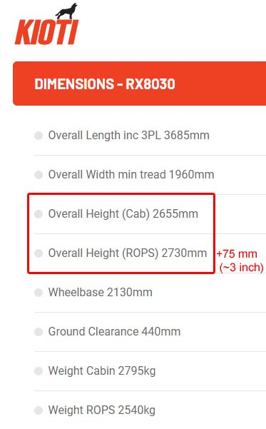

To go along with the pole saw comments, I would add check your shed clearance if you want to store it inside. I upgraded my little 755 John Deere to a New Holland TC40 with an after-market sunshade bolted to the roll bar. I didn't check the clearance until the tractor was parked in front of the shed. Now the sunshade sits against the shed wall and the roll bar is flipped down so the tractor can be parked in the shed. If it had a cab, it would be parked outside all the time. This does give me an excuse to build a bigger shed...
Two of the "musts" for me with the new tractor were (1) a cab, and (2) that it would fit in the shed.
Reference (1), with summer mowing/slashing for 30 or so acres of pasture, it's nice to climb in to the cab on a hot and humid day, crank up the (excellent) aircon, and get the job done in comfort.
With (2), there's not a lot of margin regarding the height - maybe 100mm (4"). Fortunately the roof slopes down a little at the front, so the Trimble satellite antenna mounts nicely without adding to the height. Interestingly, the ROPS version is 75mm higher.
