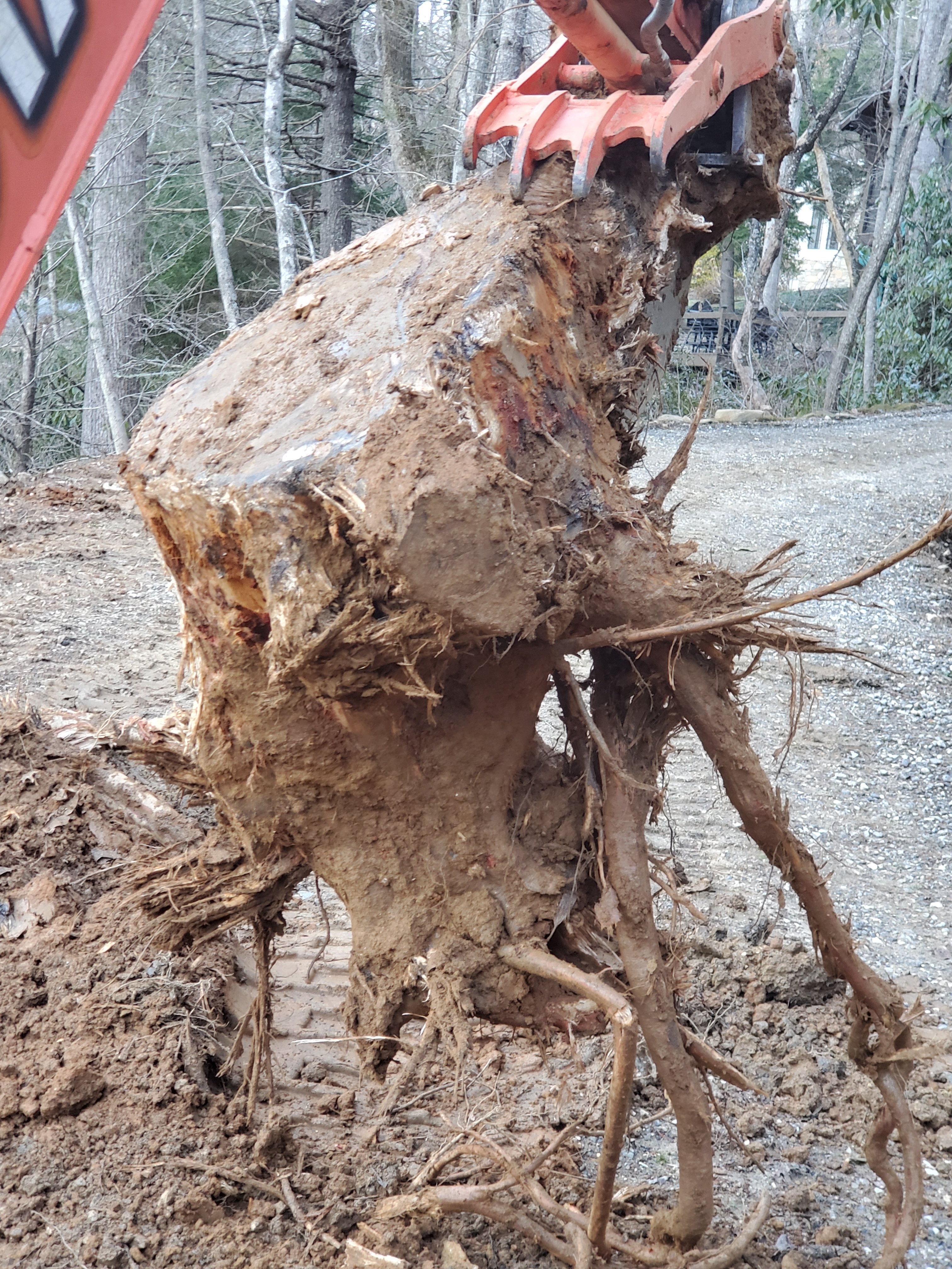

For those with a backhoe and a desire to tackle stumps from time to time, you might try a rock ripper with a sharpened edge to slice the roots and limit the hole size. In the past, I’ve found a bigger machine is better for stumps.
   / Regret not getting a backhoe for my tractor #76

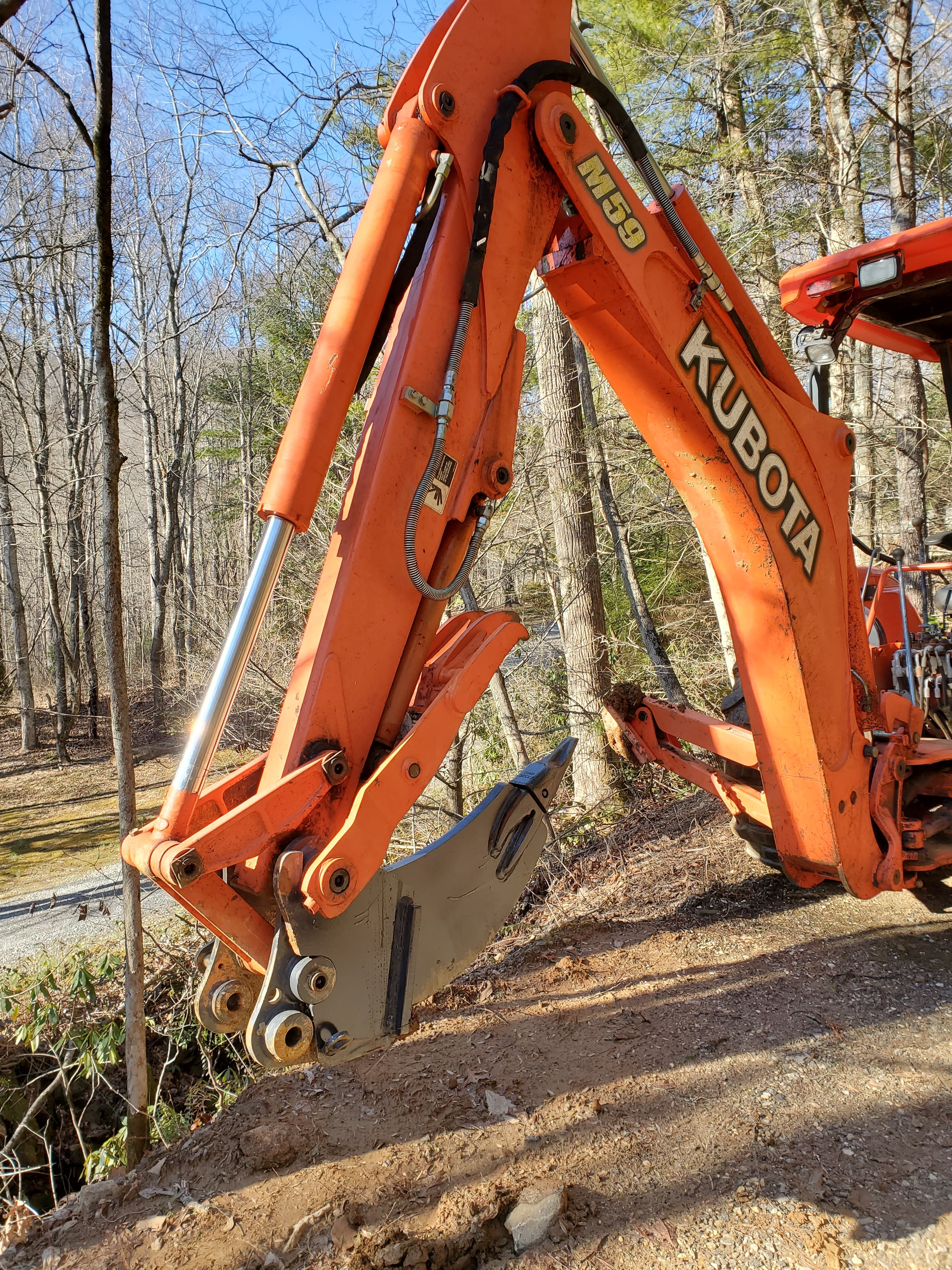

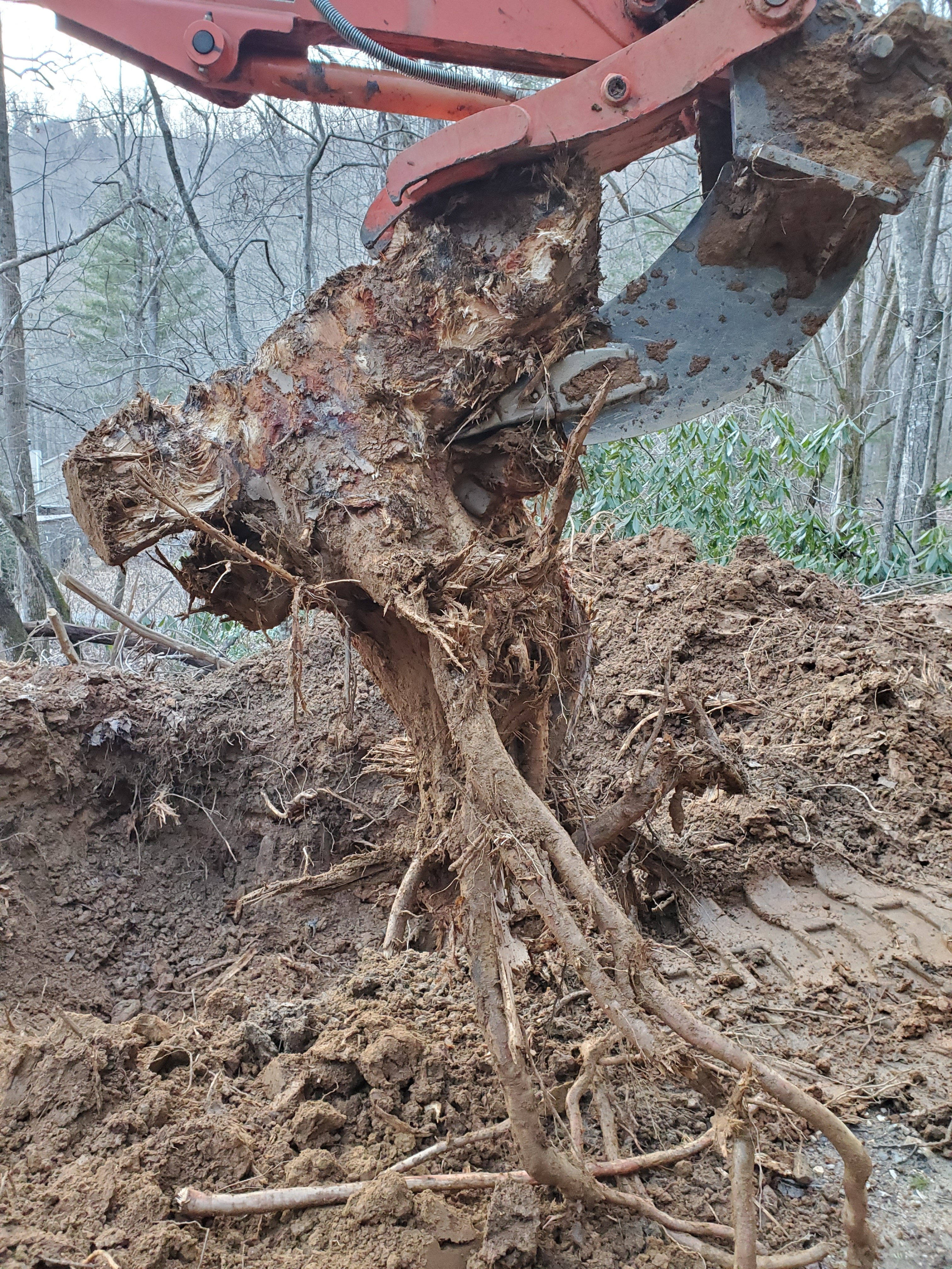

Root/ Frost ripper on custom quick attach that mates to the KX40 excavator tools and a few stumps. Stump with huge tape root was 24" plus dia

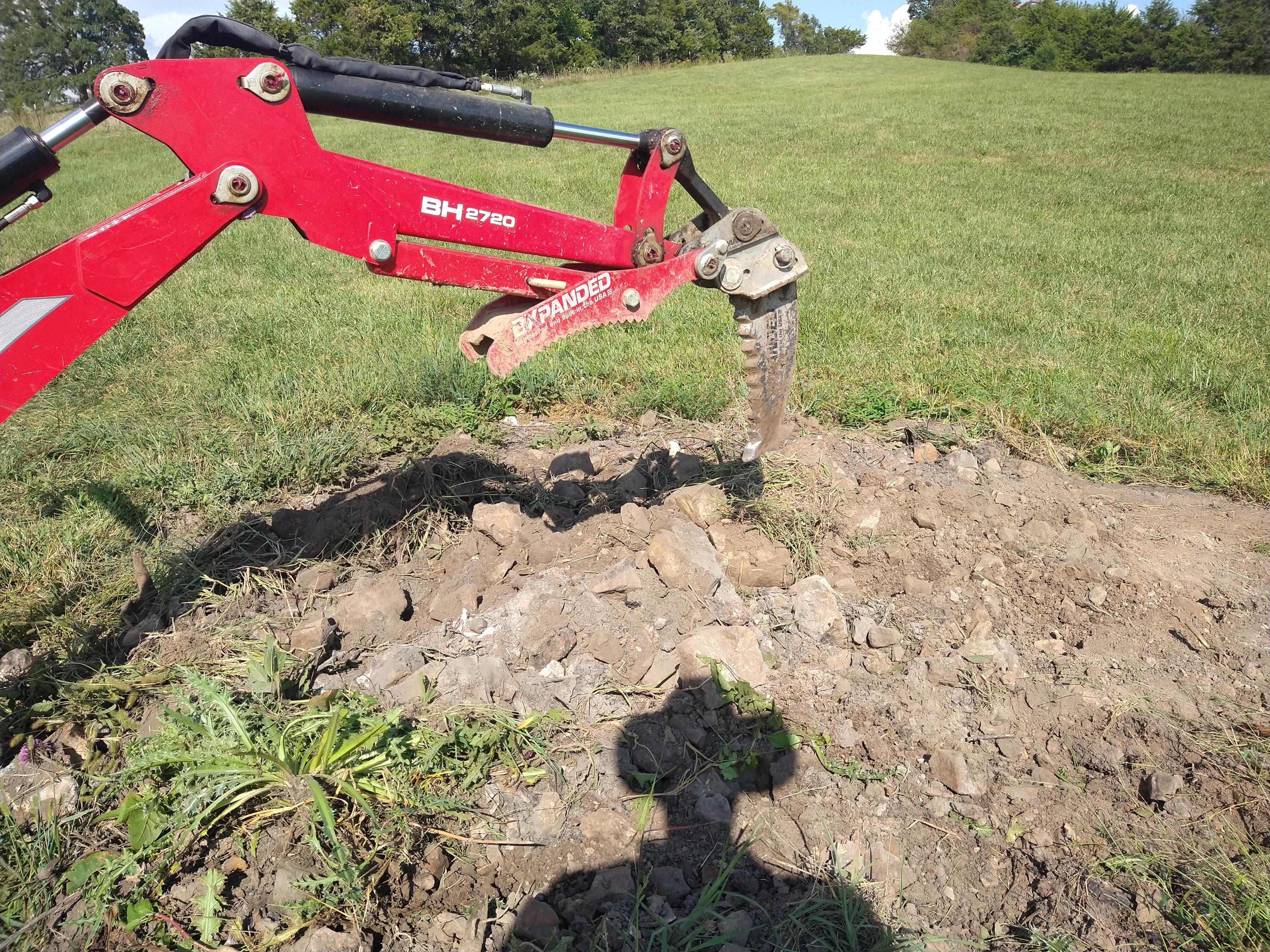

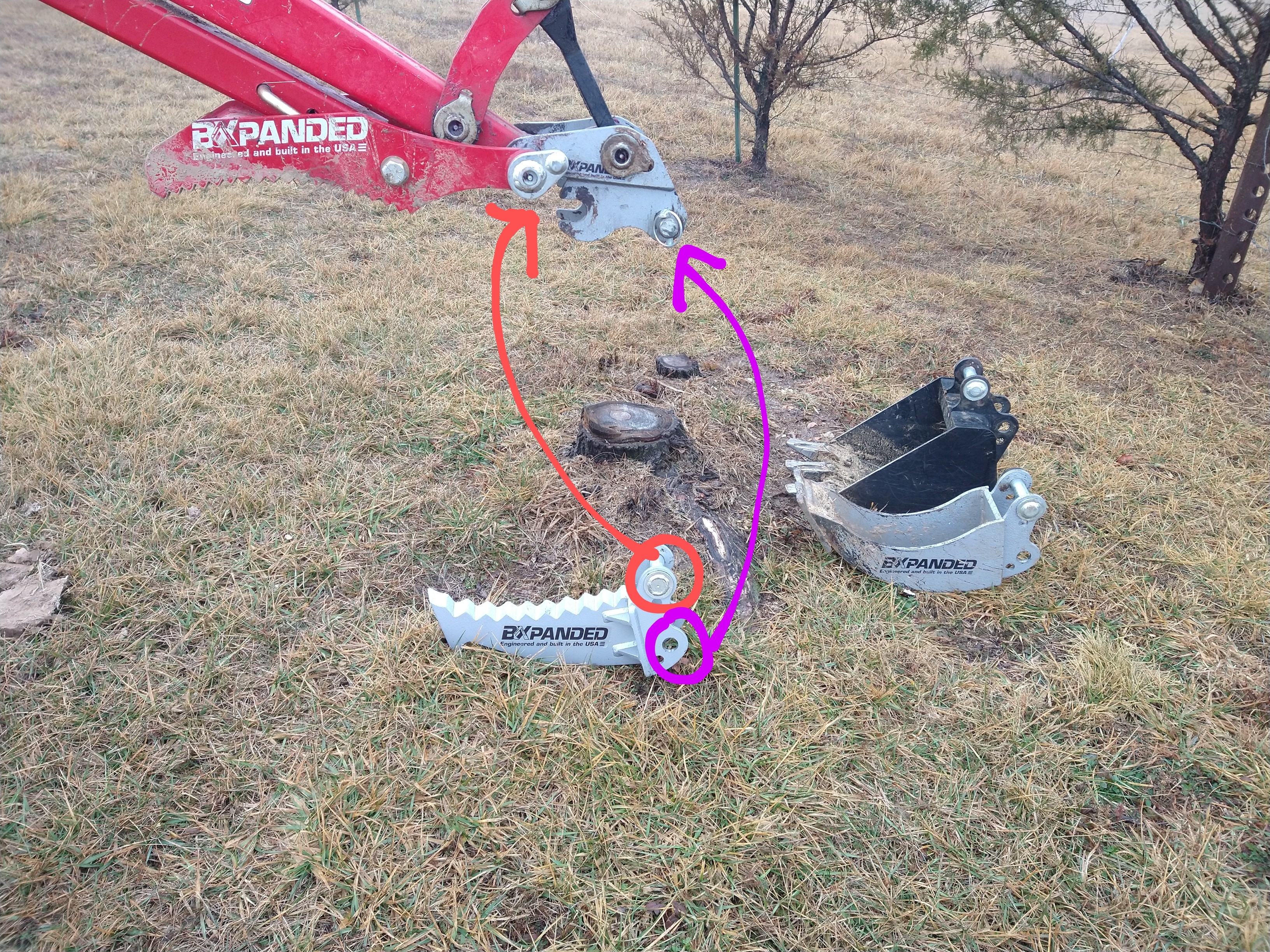

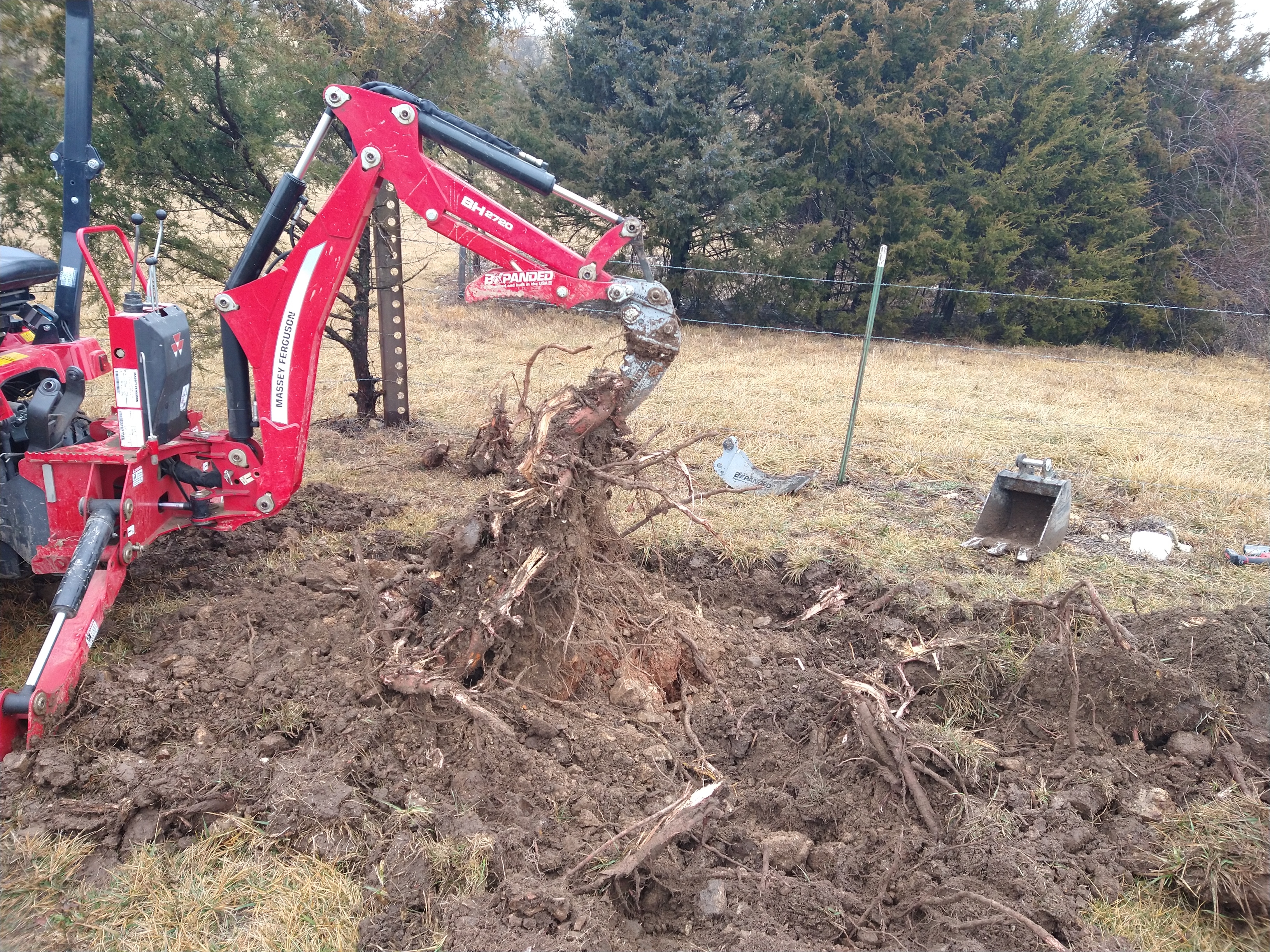

I got mine from BXPANDED ... The "Quick-On" makes swapping things a breeze ... Slide red pin in notch, pivot purple up and slide in pin ...
Loosens up rocky ground too!
BX Expanded facility is located in Knoxville and about 10 minutes from my home there. Visited BX to see if they would build a custom QA for my M59. After much thought on BX's part they said they did not have the skills and their working material thickness was not sufficient to meet the loads the M59 was capable of exerting on the coupler and attached tools.
BX Expanded business line is clearly focused on the smaller 30 hp and less machines

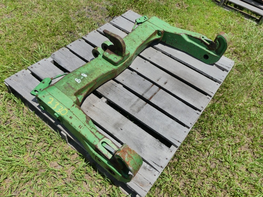

No regrets whatsoever in getting a backhoe with my newest tractor. The backhoe serves well as a counterweight instead of having loaded tires and I'm one to use my backhoes quite frequently on all of my tractors. The key point is having a full sub frame vs a 3pt hitch attached one, which can destroy a tractors frame in a heartbeat.
