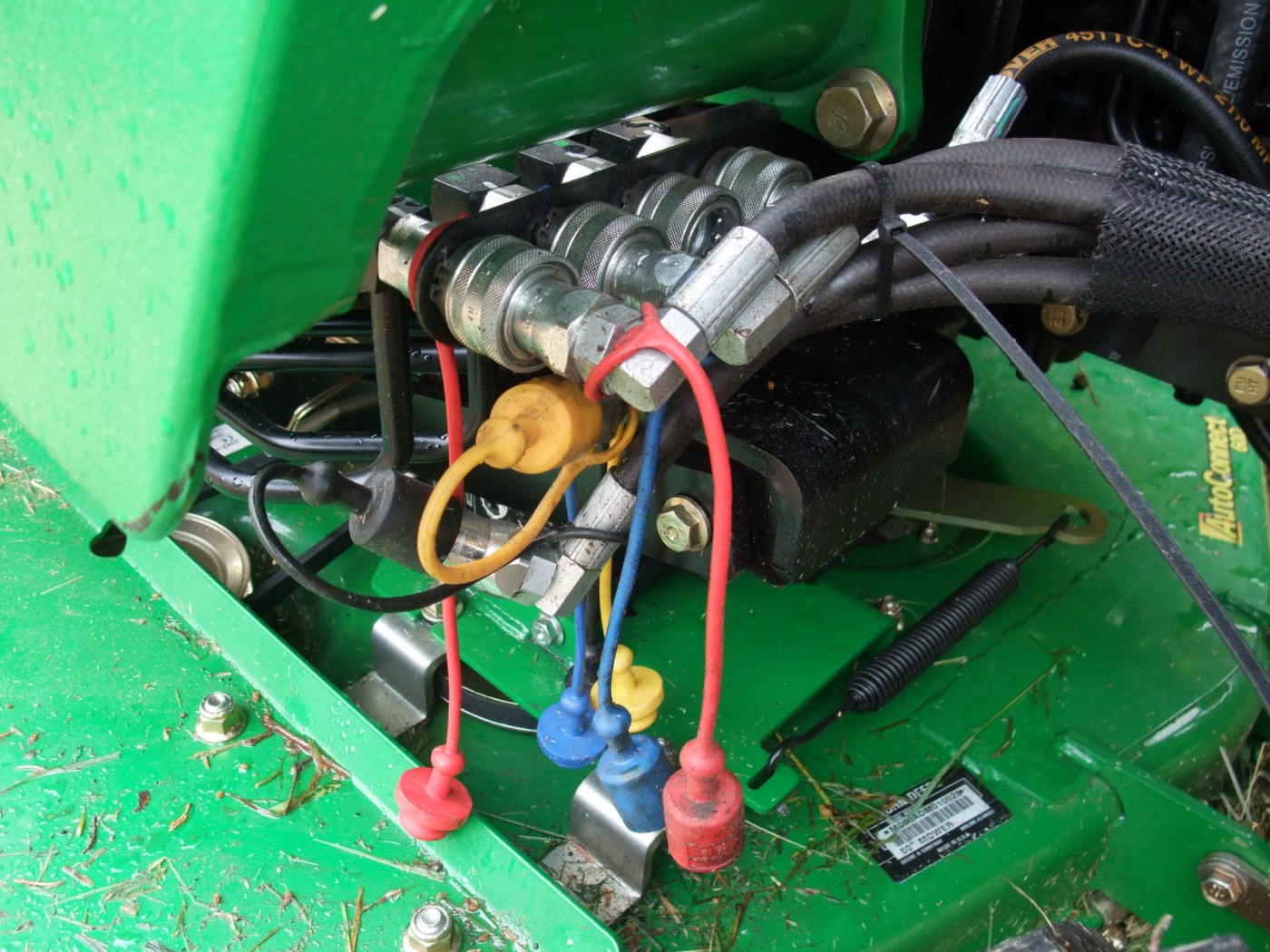

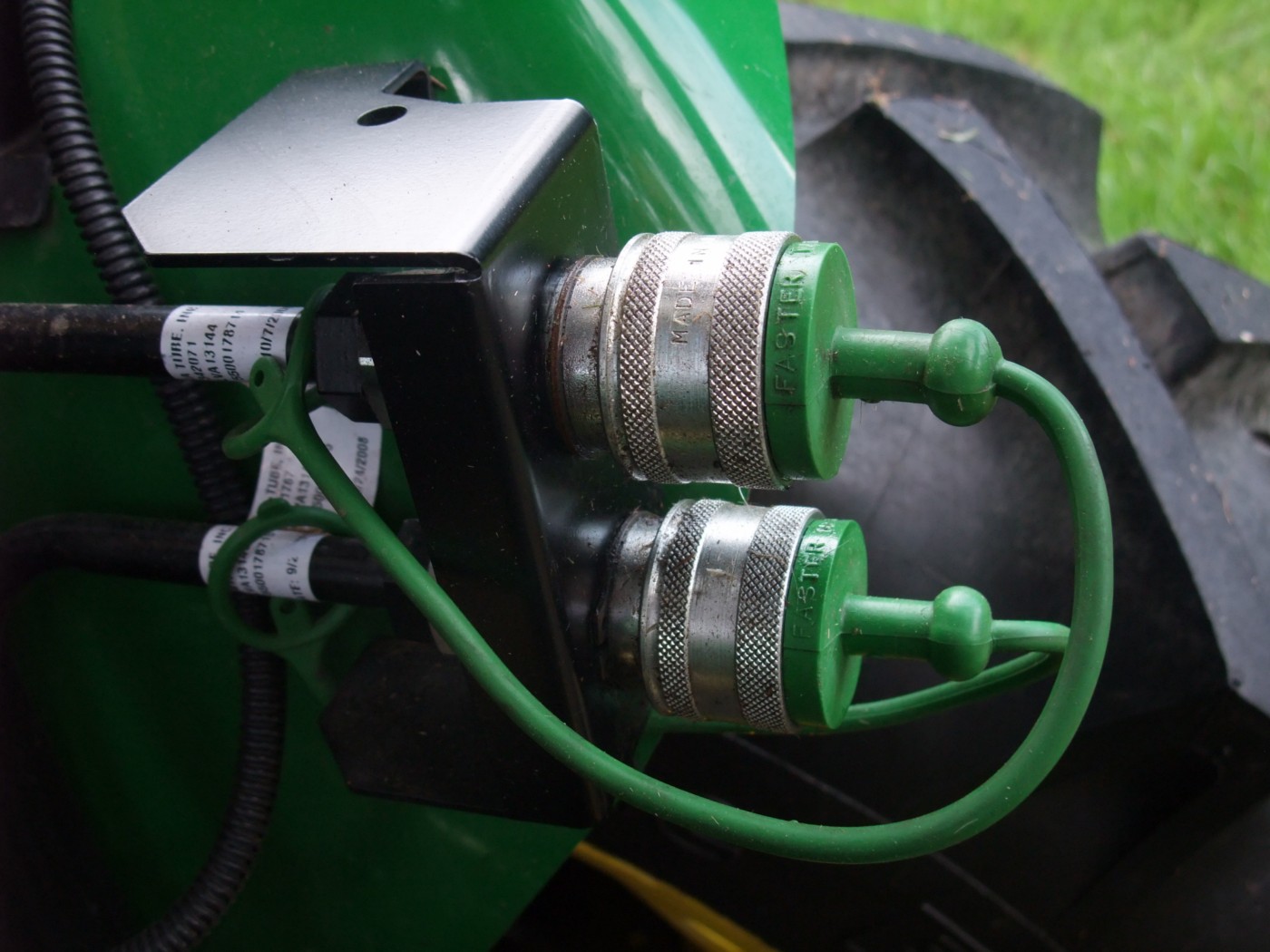

I'm surprised at you guys having female QDs on your implements. On my JD it's the other way round, all female on the tractor and all male on implements. So that they can easily be bled by pressing on a metal surface. This is often necessary, especially with the loader or the MMM because of their weight pressing on the cylinders.
