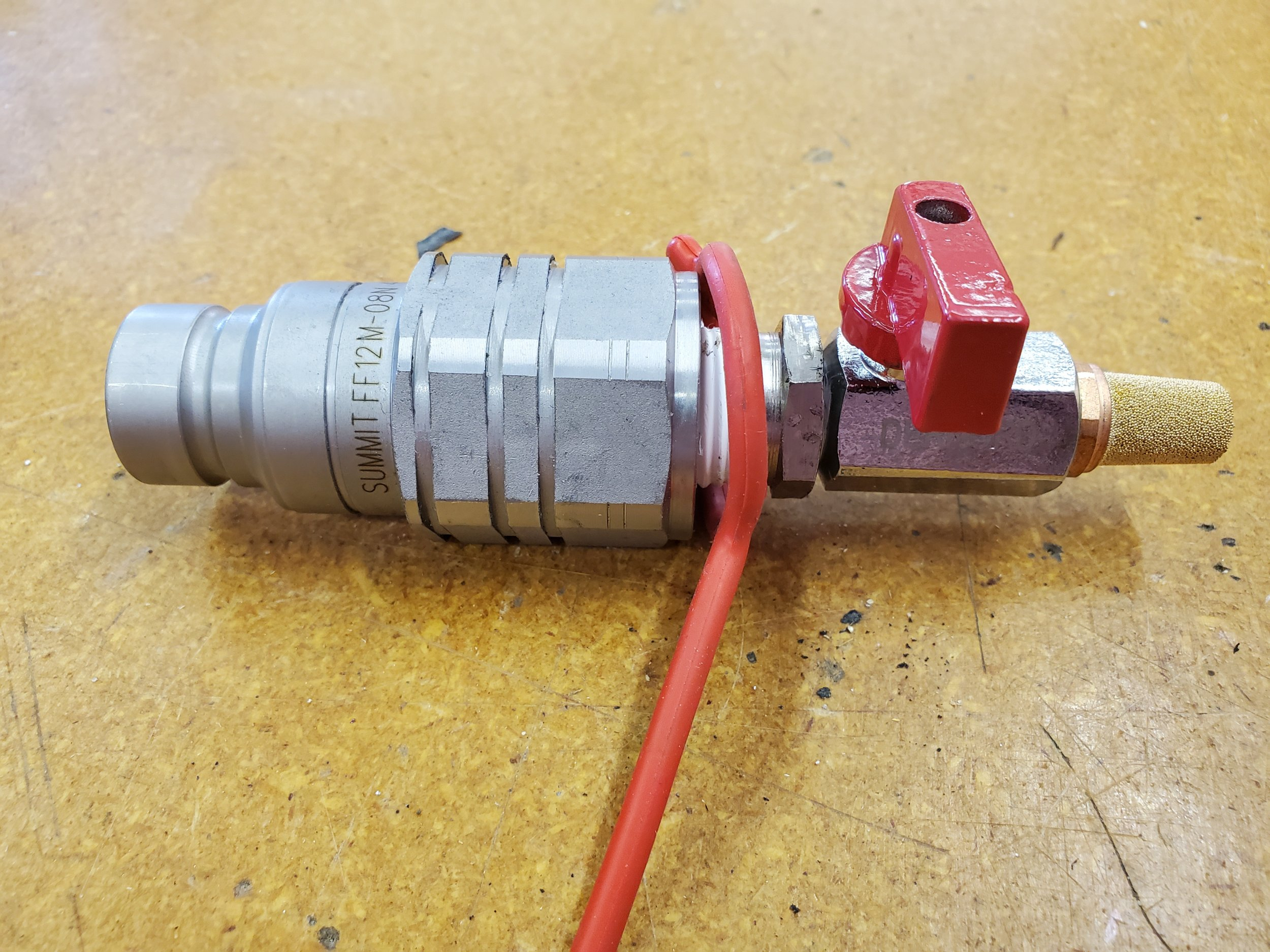

I bought a set of mating flat face couplers from Summit Hydraulics for my grapple and attached a ¼" ball valve with a ½x¼ bushing. I threaded a sintered bronze breather into the ball valve to keep dirt and leaf cutter bees out. After disconnecting from the tractor, I attach the valve couplers to the grapple hoses. When I'm ready to reattach, I crack the ball valve to relieve any pressure build up due to atmospheric conditions and life is good. Cost was a little over $50.
