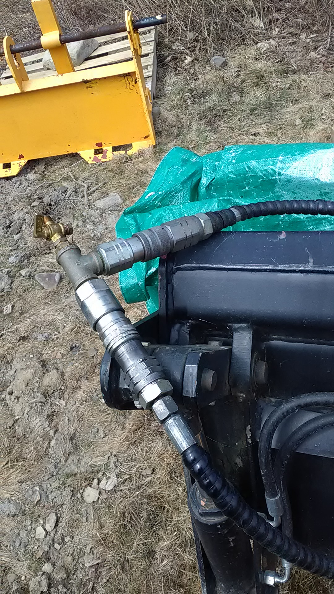

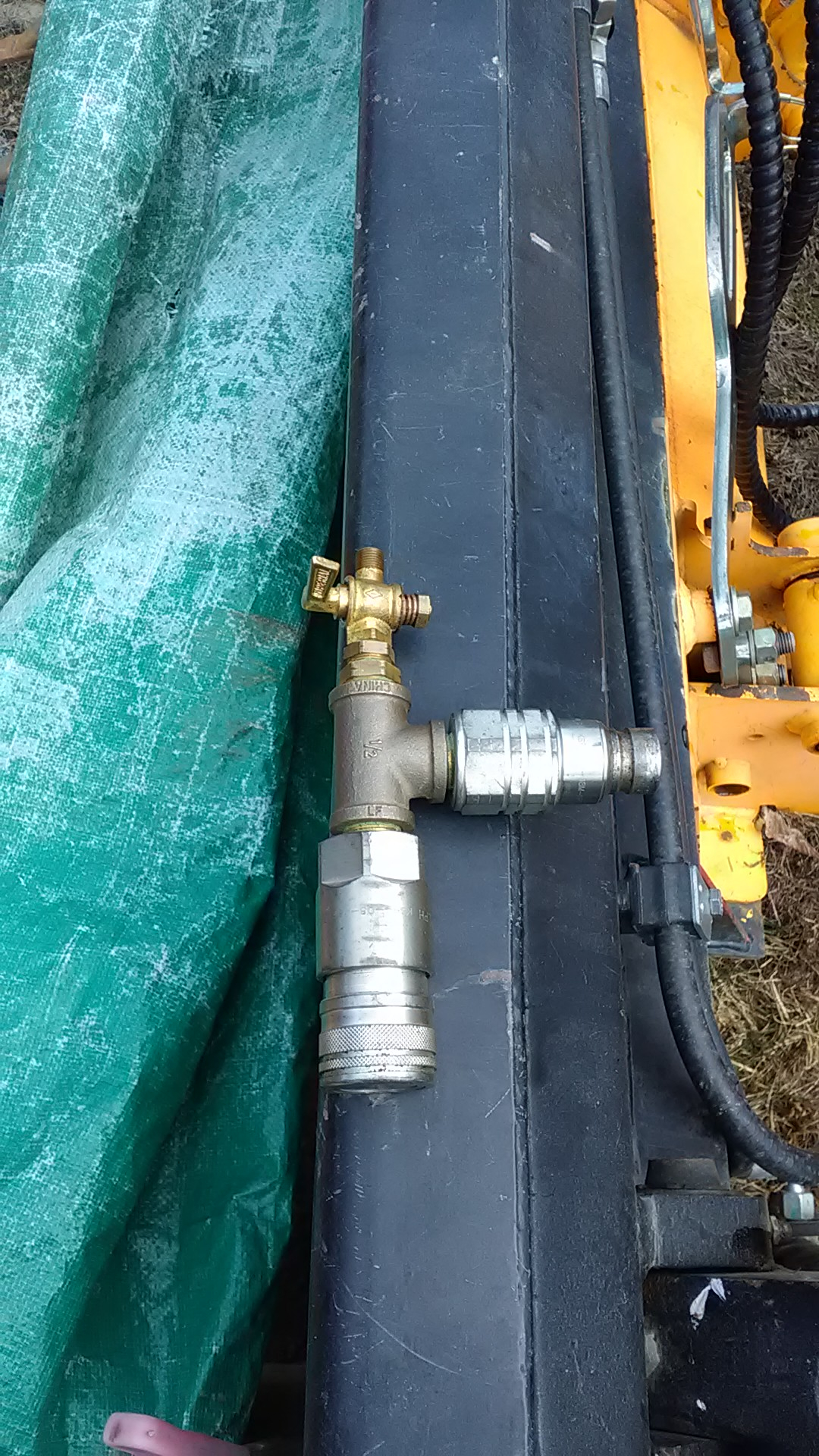

I have made a valve with male and female connectors. When I take the 4:1 bucket off I first make sure the jaw is open a bit so fluid expansion in the system may cause the jaws to close a bit but not fully. That keeps the pressure down a bit. I also connect both my bucket hoses to my valve. If I quick attach the bucket then open the valve I made into a coffee can a quick squirt and I can easily connect to tractor. Yes, always turn off tractor and try to take pressure off tractor system. Sometimes with key ON without starting have someone push button or lever for 3rd function as you connect the flush face connectors. I have also found that on my tractor, if I connect the male connector from the bucket first, it let's me connect the other one easier. Bottom line is these 'dripless' connectors are a bear to connect. Brass fitting is the valve that open to release pressure.
