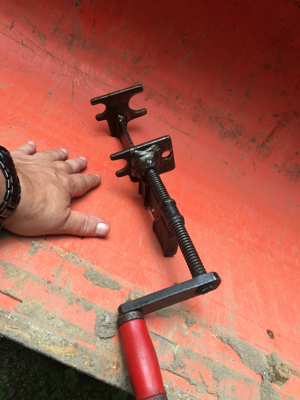

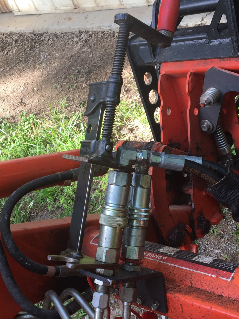

The Waite tool from Ken’s hooks works to relive pressure on the implement side easily and safely on flat face connectors. Costs about as much as a pair of QDs. Even with jaws open and lines connected a 40* temp change can build up pressure.
If running the loader hard and changing buckets it’s sometimes hard to connect. Use a homemade clamp to gently squeeze the two QDs together. Doesn’t take much pressure just more I can do now.

Sure liking that tool Mr. Smokeydog!

A couple of years ago, my brother sent me one of these tools. It works great for relieving the pressure built up in my attachments while they were stored. As Smokeydog mentioned, They are available from Ken's Bolt-on Hooks - just scroll down their Hydraulic Products section. My brother bought his and mine direct from the manufacturer. THere have been a couple of mentions of them over the years here on TBN. They work well.

Some other members have made their own clever pressure release threaded clamping devices made from scrap steel. Not complicated and small enough to fit in a tool box.
On eBay one seller has made a modified quick grip bar clamp for QDs. Again not hard for the tractor community to make.
