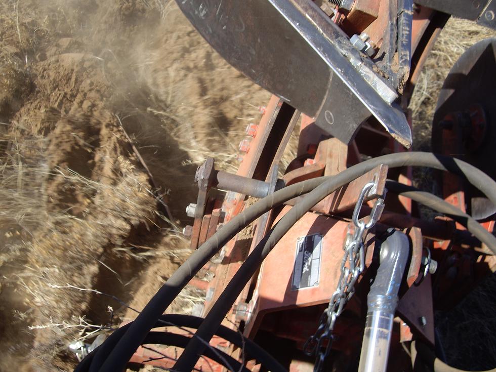

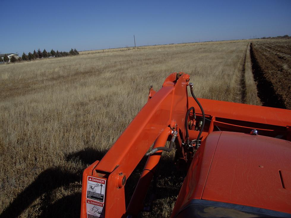

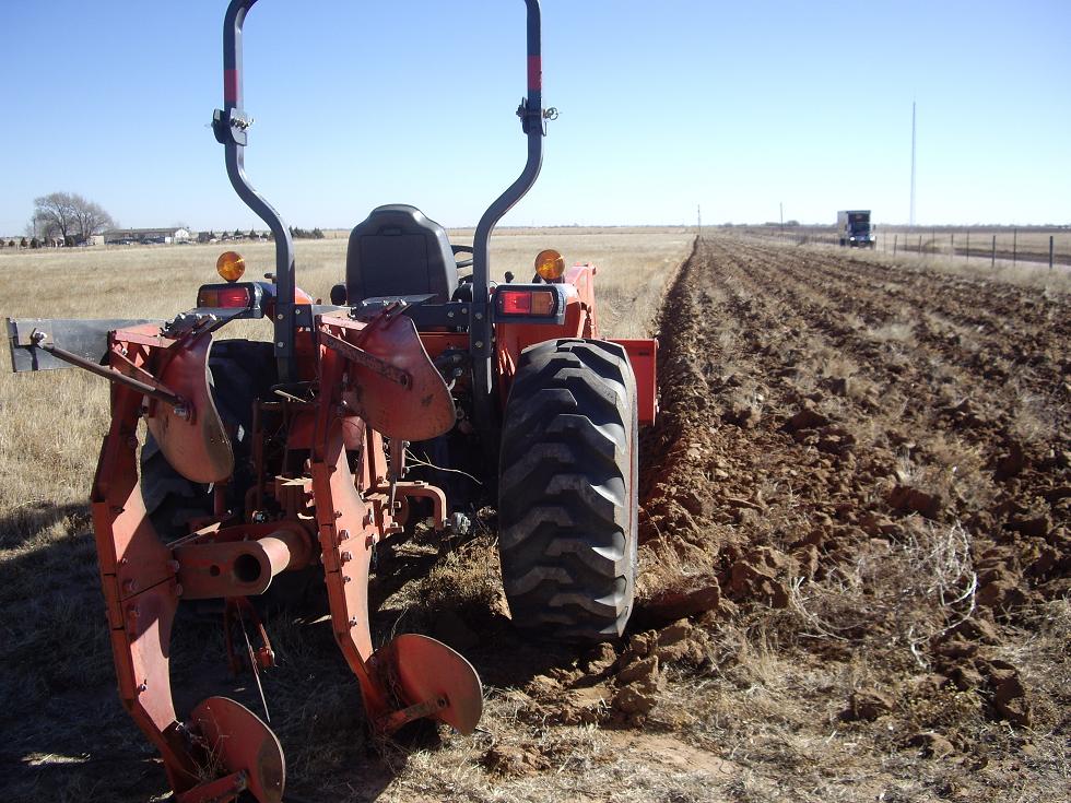

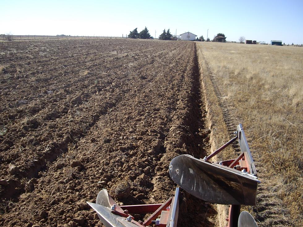

The first pic is getting started
2 is a action shot, best I could do.
3 is looking west about a quarter of the way in.
4 is still looking west about half way in
5 is looking east showing how much I have left and the bend my furrow is starting to take.

Oops
here's #5

I will not be the one to say, you don't have your plows set 100% correct are there would be no breaks in the roll of the dirt or the grass as plowed. Looks good.
   / remember the land I was going to plow? Here's pic's
Or it could be because some of the grass was three feet tall.
Maybe. :)
   / remember the land I was going to plow? Here's pic's #5
I That sure makes my job look insignificant.:D

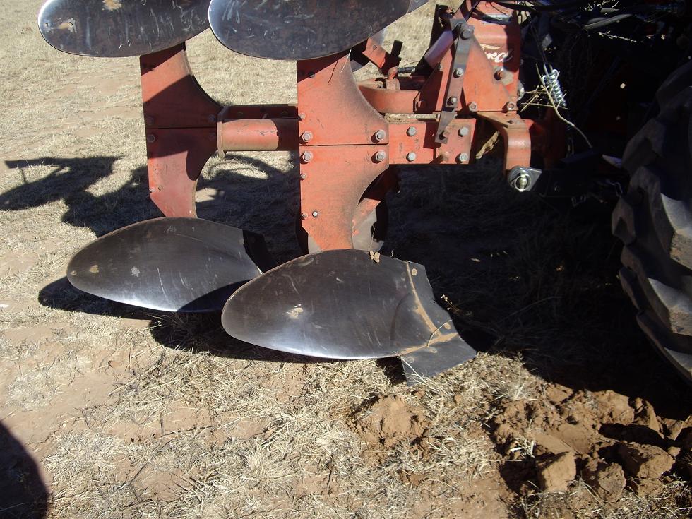

Here's a few more thoughts about the plow and a couple of pic's of the plow.
I never got the left hand bottoms to come completely bright and shed properly. The rusting was such that it looked like the plow had set in the field for a few years and been covered with sand. The right hand bottoms, when I finished were pretty darn bright.
I figure with another 8 or ten acres, everything will be polished bright.
I'm going to paint the bottoms with spray graphite. It looks like a dull black paint, drys like paint and is slick. Since it's use is a lubricant, I figure the next time I plow, the plow will shed as soon as I stick it in the ground and as it wears off, the steel should still be bright underneath.
Also, I forgot to mention speed.
As the plows began to shed better, my speed picked up. I started out at about 3 to 3.2 MPH and when I finished, depending on what I was pulling through, I was running in excess of 4 MPH.
I felt most comfortable and the plow seemed to perform best at about 3.8
MPH.
