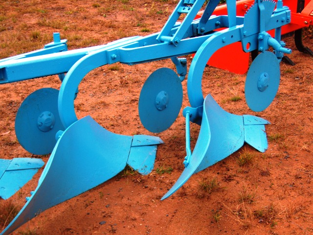

From what I can see in the picture, you're plowing sod on hard mostly clay soil. Which hard to do neatly under most circumstances, especially a single bottom.
What would help is if you can find a coulter for that plow it will help cut the sod to make a cleaner furrow. Also a moldboard extension that goes on the end of the moldboard and helps the soil finish rolling over , and doesn't let it flip back. To cover the thrash better a coverboard curls the top of the slice over and dumps it under the rest of the dirt. Its mounted at the top of the shin piece and the moldboard. Google these terms or stop at an equip dealer and ask the parts guy to show you the parts.

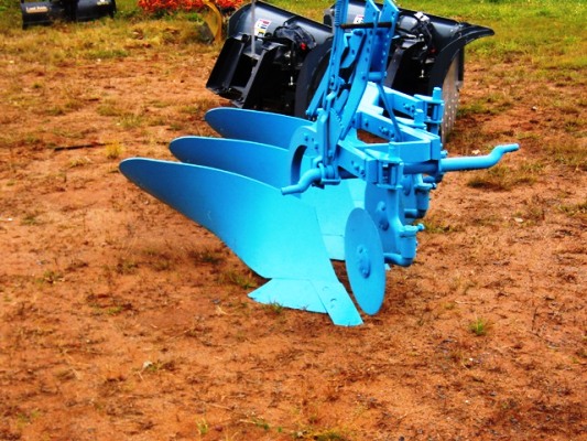

Attached is a picture showing a plough with the type of moldboard mentioned that would make turning much easier.:D
You done real good with the plough you were using.:D
