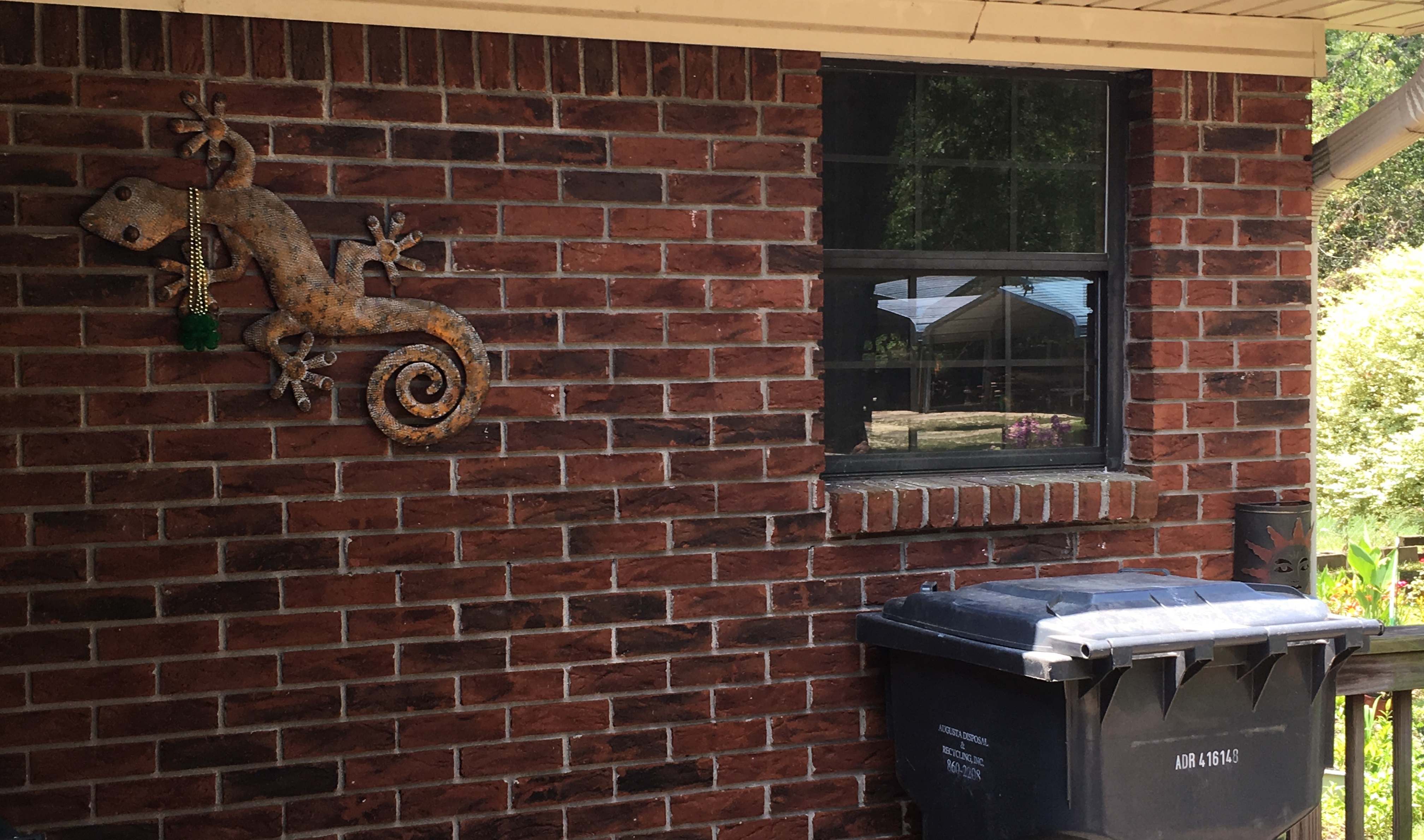

This isn't tractor related but I know many of you are experienced DIY and/or professional contractors.
I am remodeling our master bathroom and installing a large walk-in shower where the previous owners had a large whirlpool tub. The problem is there is an outside window where the back wall of the new shower will be and since the window is right over the back-deck there is a privacy issue in addition to preventing interior water damage. To complicate matters the outside wall is brick so the window flashing is not accessible without removing brick and if remove the window I will have a large hole I will have to fix.
My question is there any structural or building code issues with just leaving the window installed and framing and tiling over it on the inside shower wall? The widow is single hung thermal pane metal frame in good shape. I'll likely cover it on the outside with a solid pane of stained glass just to disguise the fact the window is not functional and provide some decoration for the deck.
My gut feeling is this a half-xxx way of doing this but the more I think about it the more it makes sense, even if I remove the window, tear out the brick, repair the sheathing, and brick it over it will be obvious as I do not have any of the original matching bricks. Also, this is the first time I have ever actually had the window open to use it as a trash chute.
Does a window have to be a window? What are your thoughts.

Put one-way window film on the glass.
/ Remodeling Question - Outside Window Removal (not)
I don't believe the window would be waterproof on the inside and am concerned moisture from the shower would/could into the inside wall?
Am I wrong? I have never seen a window in a shower wall before.
Thanks
/ Remodeling Question - Outside Window Removal (not) #4
I've seen the window left in and covered over on the inside on quite a few homes with varying results. Some of them you would have no idea that the window was still there, others developed moisture issues and I was hired to repair the damage. I can't say how yours will turn out over the long term, but odds are good that eventually you will have moisture issues.
Removing the window and installing brick is a really simple and easy thing to do. Finding the matching brick is by far the hardest part of the job. Just do one row of bricks at a time, use a straight edge to make sure that you are keeping the row of bricks in line and level, and take your time.

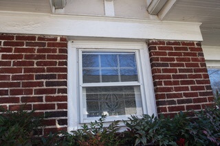

My old house I just restored looks identical to yours. Mine is older, 1930 vintage, with no longer available brick (even a different size, old lime based mortar) making a patch hard to accomplish. I had an identical window, once over a bath, that was converted into a large walk in double shower, all tiled. I removed the entire old window to the framing, (replaced all my other windows also) had one made with all pvc vinyl, with privacy glass. I re-trimmed the outside with PVC trim, and tiled the entire inside with tile so there is no trim exposed. I sloped the inside sill slightly. It look great, outside and inside, adds light to the shower, is extremely private, and maintenance free. I’ll take some pictures tonight and post later. It looks like an identical situation as yours.
In other areas of the house, I had to change window sizes, so did patch the brick. You can see it but it looks pretty good. Most people probably wouldn’t notice.

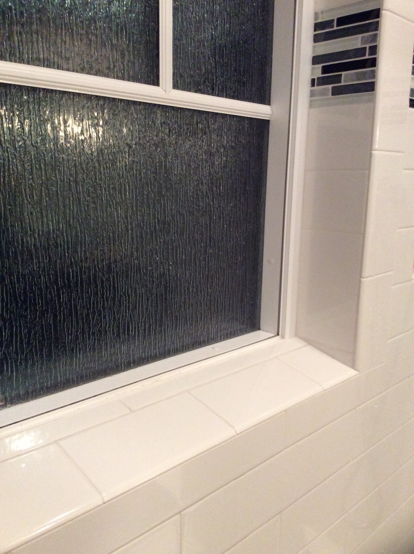

New windows glaze from the outside so replacement of a broken one as has been noted before becomes a non-issue. Remove old frame even if you have to saw out the aluminum, install new framing in the brick and a new window with opaque glass. By all means get rid of a window in the shower. I have the same with 2windows but the wall is wood frame so when I remodel I will remove and side over. If you window sill an below is not damaged I would be surprised.

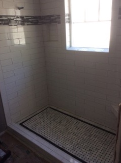

Here are a few pictures of mine, before and after. I enlarged an old bath, added a large tile shower where the widow was. I removed everything down to the framing. Remove an old double hung window. Repaired and made the new framing ideal, coated every wood member with a Red Guard. Can’t remember if I used any pressure treated in vulnerable places. Had a new all vinyl widow made with privacy glass. Installed it, flashed it. Added tile backer board and taped it and sealed it, including a sloped sill. Then added tile, butted up to the vinyl window frame. I suppose the only weak point is this horizontal junction. But I sealed it with a high quality silicone caulk. And it’s easily visible and accessible. The outside was trimmed in PVC trim and of course caulked normally. Note water from the shower heads doesn’t directly hit the window. Of course, splashed water does. But I’m pretty confident it doesn’t leak. I don’t see any difference in danger versus any tiled corner or junction that’s sealed with caulk or grout. Of course the window is fixed, doesn’t move. I believe it will out last me. I can’t imagine what the exterior would look like to just eliminate the window. Plus it lets light into the bath. And is very private. I’ll post some outside pictures tomorrow. IMG_2360.jpgIMG_2666.jpegIMG_0395.JPGIMG_0396.JPGIMG_0254.jpeg
Note outside photo is the old window.
