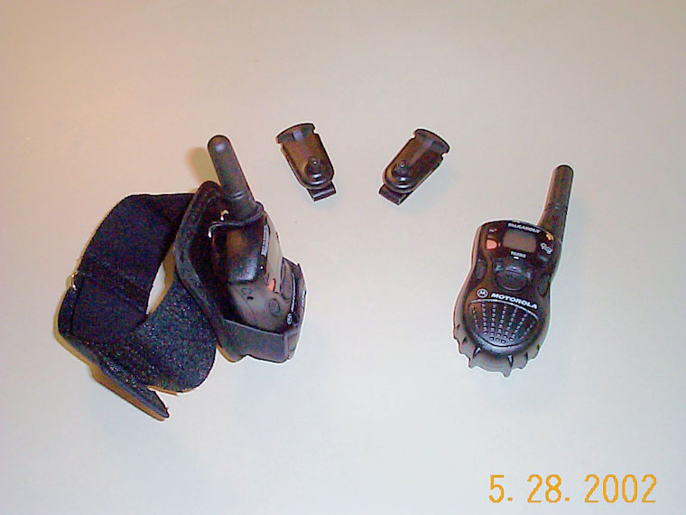

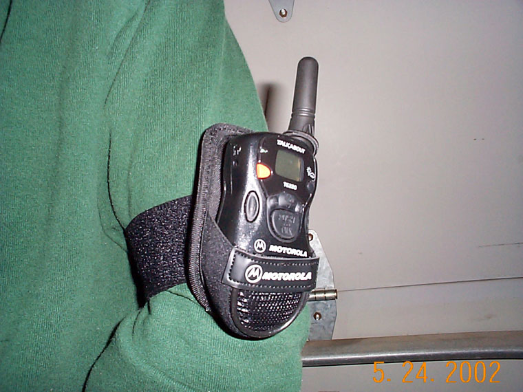

I, like everyone else have also been trying to find a solution. I have a cell phone that vibrates but no matter where I put it I would only notice it vibrating about 25% of the time. At least with the cell phone I could just check it from time to time and it would tell me if I missed a call. This worked fine for when my wife was just calling to bug me but we were concerned about her being able to contact me for an emergency.
I read the other suggestions about the FRS radios that vibrate but I figured that they would not vibrate any harder than my cell phone so I blew off that idea for a while. I had a gift check to Staples for $75 a few weeks ago and they sell these FRS radios so I thought I would research it more. I went to Motorola's website and saw that they had an arm band accessory for the vibrating model I was looking at (T6220). So I went ahead and bought the two radios which cost me $105 with tax. Nice part was that with the $75 gift check and the $15 a piece mail-in rebates these will end up being free. I went to Motorola's website and ordered the arm band (around $18 I think).
So I had a few days before the arm band would arrive which gave me some time to try and teach the wife how to use these things. She hates learning how to use anything new, especially if I am trying to teach her. She refuses to read any owners manuals. Unfortunately these things have quite a few features but luckily I can set them once and then "Lock" them from being changed. All she really had to learn was to press and hold the push-to-talk button for about 5 seconds and that would make my radio ring/vibrate. Then she would have to wait for me to stop the tractor, turn the throttle down to idle, and hop off. Then I could press the push-to-talk button and ask her what she wanted.
Anyway these seem to be the solution for us. With the radio set to vibrate and in the arm band I have noticed her calling me everytime so far. I will attach a few photos of my setup.
This first photo shows one radio in the arm band, the other radio, and the included belt clips.

Here is the radio in the arm band while its on my arm.
