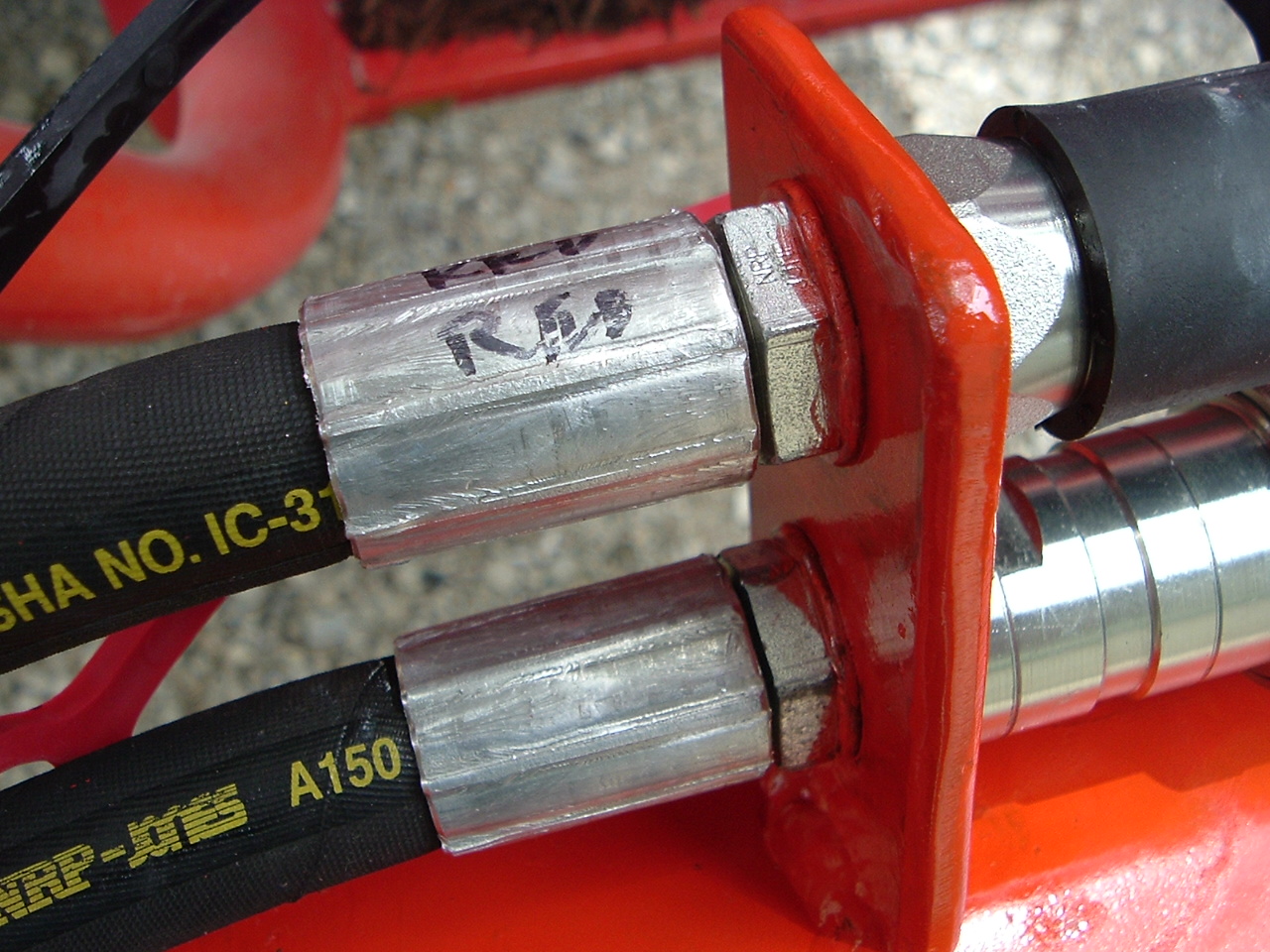

Why are you guys using 1/2" hoses to feed a small 2x8 cylinder on a grapple? 1/4" or 3/8" at the most is all that's needed, its cheaper and easier to route also.
I ran 1/2" for future use. At some point I want to buy or build a hydraulic post hole digger and figured I'd need 1/2".

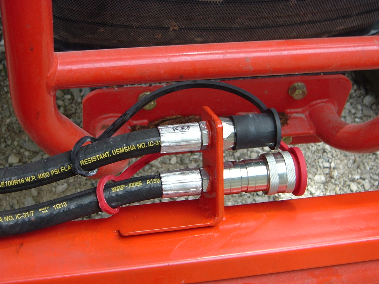

Hmm - in looking at your pic I see you have your lines terminating to some sort of a plate with the quick connects mounted to that. My layman's idea was just to run the hoses to the front and connect them directly to the grapple hoses - is that wrong?
Also - I got a call back from the hydraulic shop and they said for two hoses, with appropriate male connectors on one end to attach to the rear remote and a male/female to connect to the grapple hoses, at 17 feet, would cost me over $500.00! Maybe I am na?e but that sounds a little steep for two hoses - that is almost the cost of the brand new grapple! Am I off base here or does that sound right? If it is right, I may have to sell my grapple as it won't do me any good sitting around.
Get you hoses here: Surplus Center
Rear QD on the tractors on are 1/2 inch AG's also known as ISO-5675 The flat face 1/2 inch are known as ISO 16028
ISO 5675 Agricultural Hydraulic Quick Couplers
ISO 16028 Flushface Hydraulic Quick Couplers
I used 1/2 inch, but if I had it to do over I would use 3/8 hoses with adaptors and some 3/8 connectors in the middle to make it easier to take the loader off. I uses 1/2 inch there too, but they are kinda big.
All told, I had about $150 in hoses and connectors

I had the same thoughts, and ran 1/2, but I doubt I ever do it.. 3/8 is a lot easier to run than 1/2
   / Remote Hydraulic Hoses #36

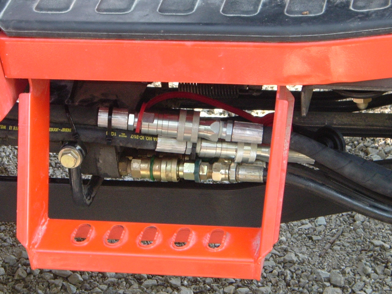

One advantage to using one male and one female up front is you will not mix up the directions of the open and closure of the lid, and has one other advantage, it allows you to plug the grapple hoses together in storage so you don't get dirt on/in the ends.
   / Remote Hydraulic Hoses #37
And, I do both of those things on mine...
