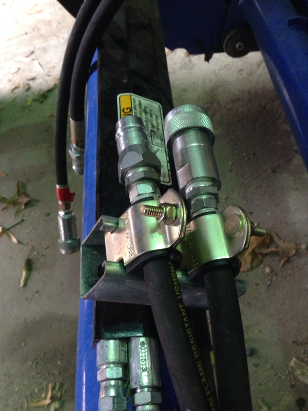

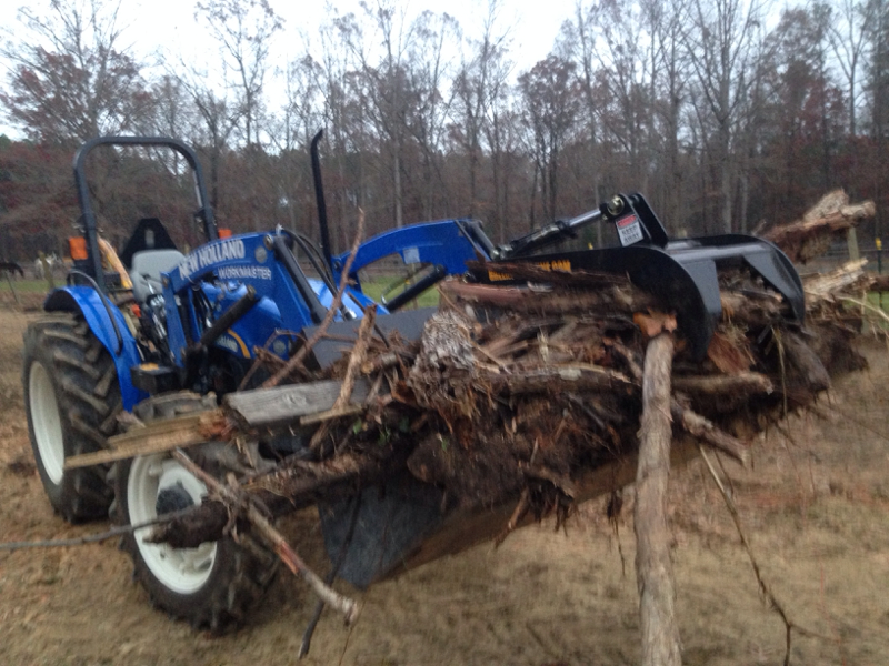

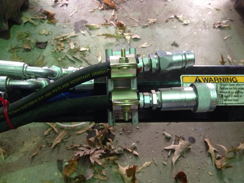

I didn't see a need for custom hoses. My dealer supplied me with 20' of hose. I ended up going to TSC and getting 2 5' hoses. I mounted the qd on the torque tube and the 5'ers from there to the thumb. I don't plan on taking my loader off so I saved the cost of mid point qds. I put 1 male and 1 female paired so I wouldn't mix the hoses up. As far as which one goes where just plug them into your remote. Operate your lever and if you would rather it work opposite then switch them.
   / Remote Hydraulic Hoses #27
This is the qds mounted 1 male 1 female.
