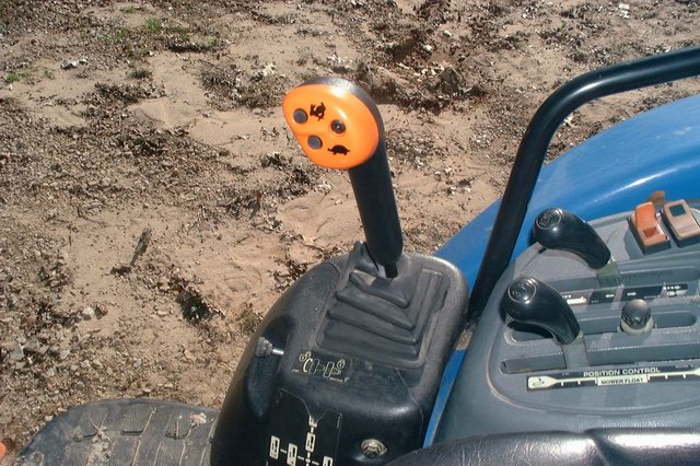

No flame from me, but I think you are thinking of a different arrangement than the one I have on my New Holland. The picture shows my joystick and two levers. The closest lever is the 3PH and the other one is my remote I use for my grapple. I can hold my joystick between my thumb anf forefinger while still reaching my remote to close the grapple. Honestly, I just normally move my hand to the remote lever because 90% of the time there is no need to be operating the loader in lift or curl while simultaneously operating the grapple.
All that said, if my joystick was mounted on the loader post or up beside the steering wheel, my remote setup would be a lot more inconvenient. It just depends on the tractor and setup.

Having your hand down beside you when trying to manipulate an item or push into a heap , intead of being a foot away from the steering wheel and gearstick would be dangerous in my book . Just as a matter of bodily balance if for no other reason . There is enough to do now with only two hands when pushing , lifting , grabbing and steering etc. simutaniously without taking one hand completely away from the control consul . And i can only imagine what would happen if you hit a stump while your right hand was beside the seat and your other hand was on a freewheeling steering wheel , you'd be spat straight out the right side of the tractor and onto the ground . It's only my opinion and i don't expect a flame war over it :) .
Do you also oppose having manual tranmissions that require the operator to remove their hand from the steering wheel?
Controlling a grapple with a remote lever is virtually identical to the task of shifting gears with "4 on the floor". There is no significant risk involved once the muscle memory is established though it does take some practice in the beginning to do it without looking.
Using a button on the joystick is no less distracting and can induce other types of error. I've used both and actually prefer the separate remote lever for operating a grapple.
PS, this is not a flame. You did however state your case pretty strongly so those of us who disagree can hardly be expected not to reply in kind.
