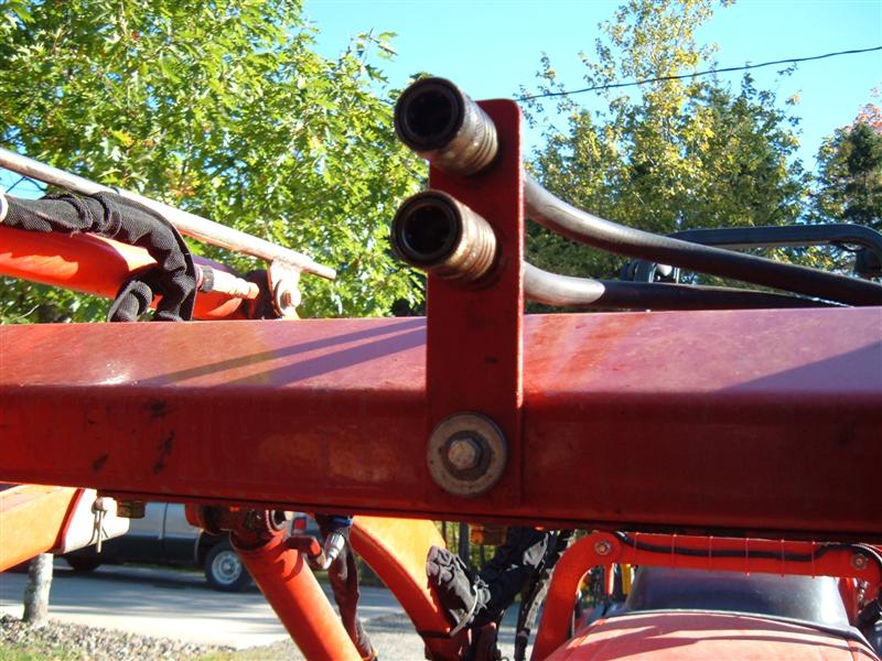

A piece of 3/16" flat bar and a couple of fittings. first pic was my CK20, second is my CK30.

/ Remotes for Grapple Use #25
Steve
Neatnik. Your mother probably never had to hound you to clean up your room, right?
Nice simple solution. I kept waiting to find the perfect bracket to weld into place. When the loader cracking issue surfaced I didn't want to touch the torque tube so stuck with my temp solution.

Steve, I was just wondering how much extra hose you need to allow the loader to be lifting to its maximum height without kinking or stretching the hose? Is this ever an issue with your setup, which by the way looks very impressive.

Lifting doesn't take extra hose. Dumping is what stretches the hose the most. Make sure the grapple side has the extra hose. I keep mine out of the way by looping it with a bungee cord so it stays out of harms way when slack but can stretch easily to allow the grapple to close when in the full dump position.

It is a good idea to have the couplers on the torque tube mount face forwards rather than sideways. That means if you ever do yank the lines by snagging on something that the couplers will more likely disengage rather than tearing or bending the hose fitting.
