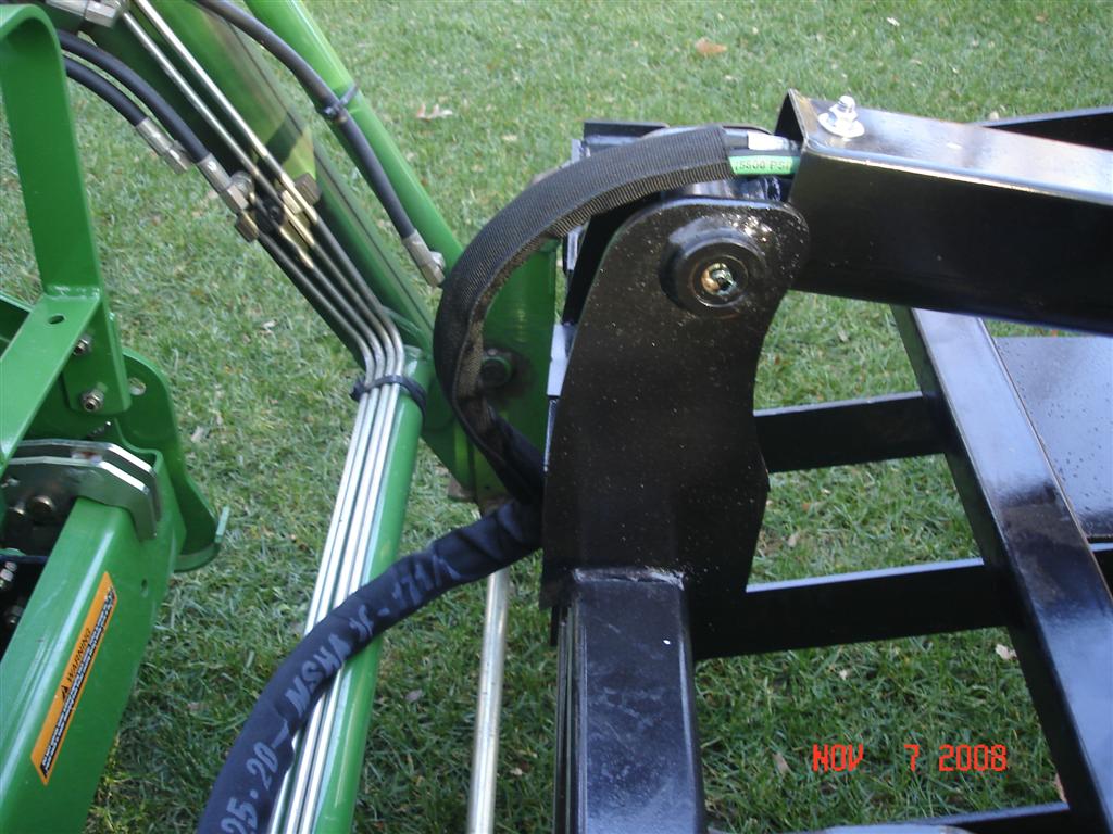

I assume Markham has a good amount of experience with this and that the "short" hoses will be adequate to reach your FEL torque tube with enough length to allow full function. If not, give them a call and I'm sure they will trade them out for longer ones.
Usually one line needs to be a little longer than the other (front of grapple cylinder and back of grapple cylinder to torque tube) but often you get two that are the same size. No biggie just make sure that the lines are controlled so that they don't get snagged when in the shortest distance to torque tube (curled, grapple open). Most of us put the lines into a nylon sleeve which can be purchased at any hydraulic store. You can then test it out and if the sleeve is flopping around too much just rig a bungee cord to the middle of the sleeve to keep it out of harms way but still allows it to stretch to full length.

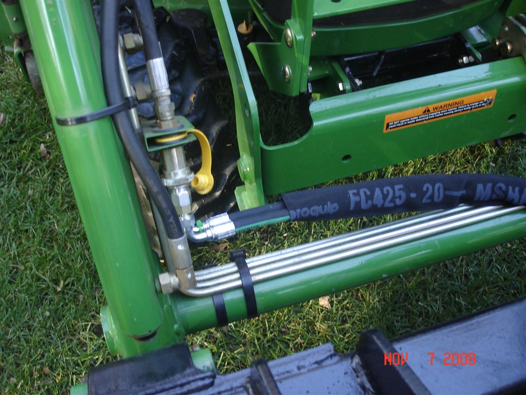

That is one reason why I told Melissa NOT to include hoses with mine, I wanted to measure and get ones that fit perfect-I also sleeved then together.
To get a perfect fit you are correct but I'd imagine you spent about $30-50 extra on hose and fittings at a local hydraulic shop that you could have had gratis. Seems to me unless they knock of some cost it would be reasonable to take the freebies and see if they fit (or if you can live with them) and at the very least you will have a spare set in case you bust one some day. I found these hoses to be the most vulnerable so it is nice to have a spare set.
   / Remotes for Grapple Use #38
Markham (Melissa) deducted $50 NOT to include hoses and QD's(SS style-couldn't use them anyway), nothing gratis! I probably did pay more...but it's worth it to have the proper fit.
