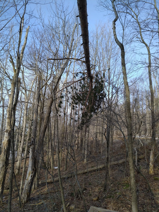

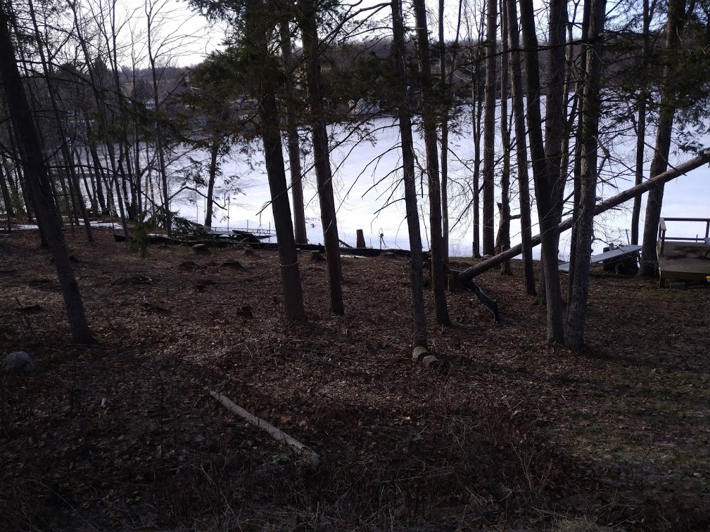

i went over again last night and did some rough measuring
the tree is 13-14 inches at the base, most of it is around 12,
i believe white pine, so around 2000 lbs total give or take..
the top is hanging free with only a few scrub trees below it, and
no good trees near it to hang from or tie to, and the top is
approx 18-20' off the ground. it's more than 40' from the road,
not sure a boom truck can reach that far sideways.
i'm leaning towards Coby's thoughts, but i would try to tie off
each butt end to stop any wild swings.
thinking of cutting near the peak, let the top split/swing down to the ground
to get the pressure off, then see if the trunk half can be winched back upright,
and deal with the top half from ground.
worst case damage wise would be railings, they are just 2x4, and maybe
a few 5/4 floor boards but that deck is 2x10 joists on 6x6 posts, it isn't going
anywhere with a few hundred pounds landing on it.
some better pictures:
   / removal of tree blow down #24
If you try to hinge the tree in the middle above the roof peak to lower the top end to the ground, I'd suggest putting a little notch on the underside first, as much as you can without pinching the saw. (it would be very difficult to get it out).
I think that way when you (slowly) saw down from above, the hinge will be in a wider spot across more of the trunk's cross section, and perhaps less likely to snap off. (i.e. you want to keep it connected to the trunk so it doesn't bang on roof or deck)
It's a balancing act of cutting slowly through just enough so it hinges, but not so much it breaks off. Others may know how "hingy" vs. "brittle" pine is when trying to get a hinge to bend versus snapping.
Hopefully the top of the tree is free and clear to lower down with this method. It's surprising how the smallest branch can hang up a tree.
   / removal of tree blow down #25
I would use a pole saw to start to weaken the top just above the root ball. As you make some cuts, the tree should show what it wants to do. I think enough of that tree is over the peak that once cut free of its base, it will just teeter up over the roof as the canopy drops down the slope to the ground.
