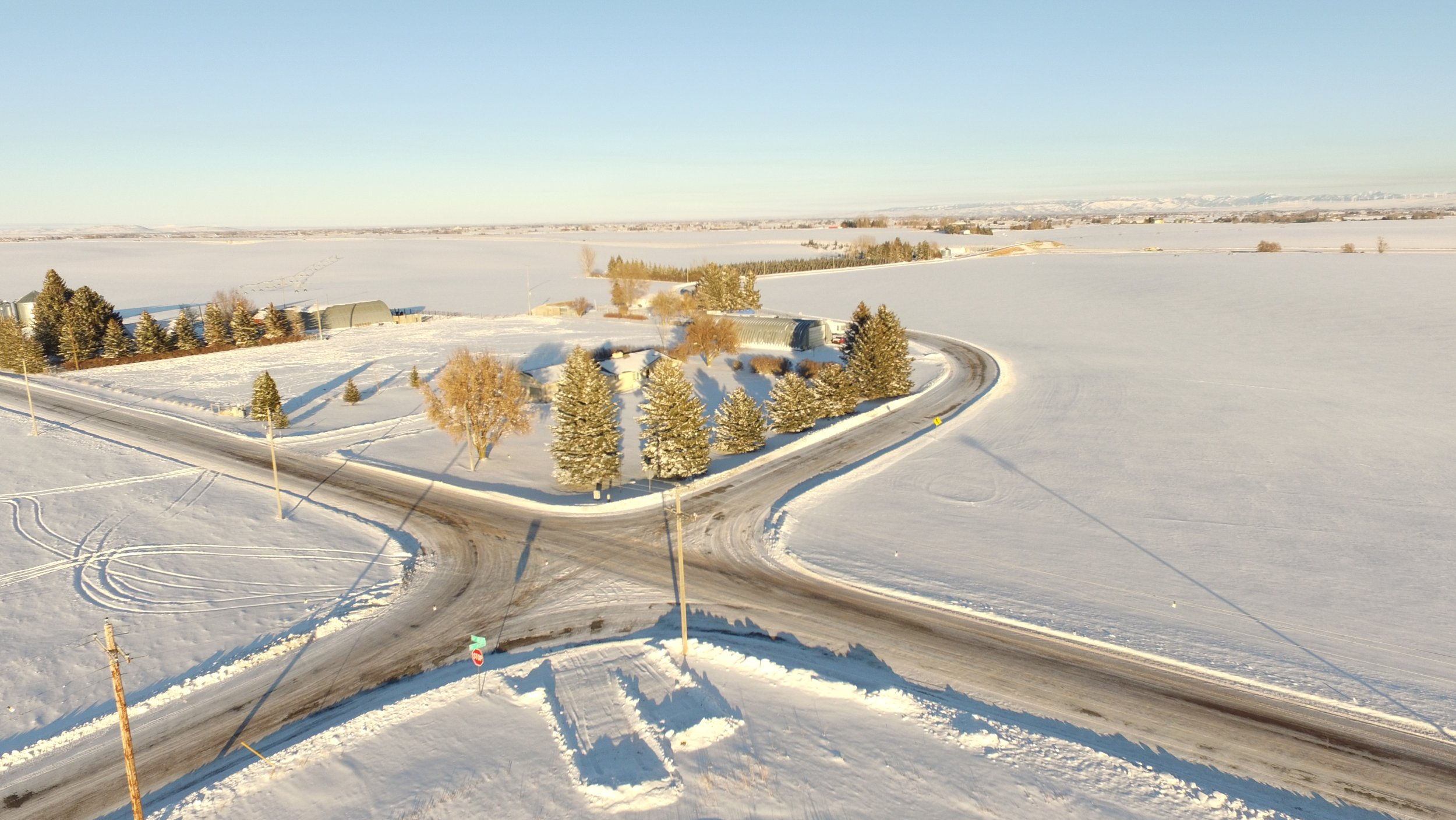

   / Remove ROPS
#25
   / Remove ROPS #26
Man, that's a nice shot!
   / Remove ROPS #27
Short of having Antman technology, I doubt you can get under those evergreen branches with or without a ROPS on a 2520. But I can see why you would want to keep the evergreens intact to maintain your privacy from the road.
