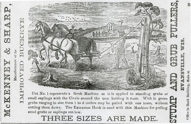

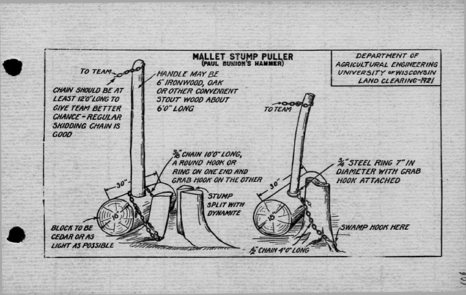

Some old variations on the wheel idea, using leverage of a "tongue" on the wheels.
Bruce
