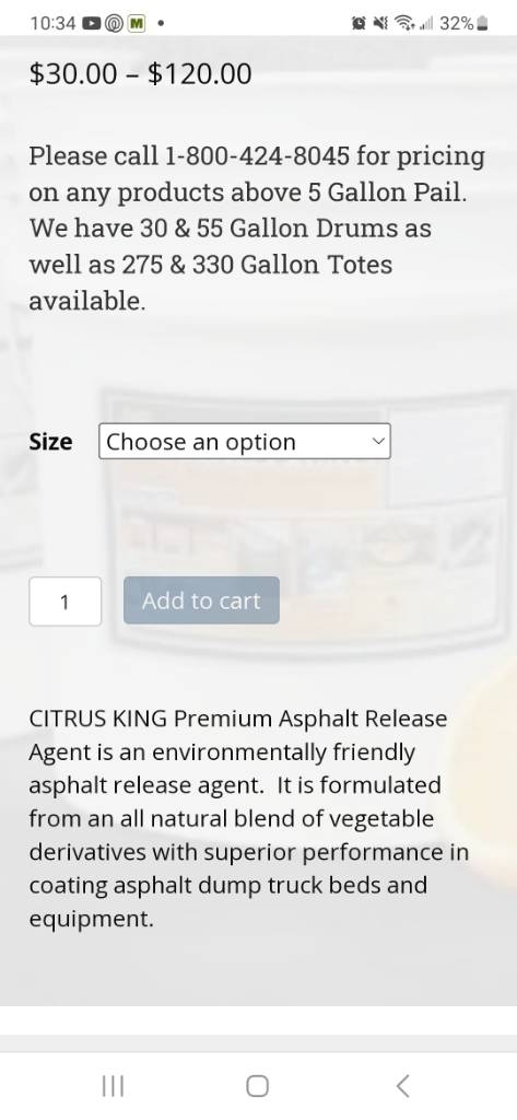

Goo Gone is a orange oil based product, that is basically the same as the non petroleum sprays used to keep asphalt from sticking to a dump truck bed, or to clean tools where diesel isn't allowed. It's not nearly as aggressive, but I would only try a very small area with it to make sure it doesn't make things worse

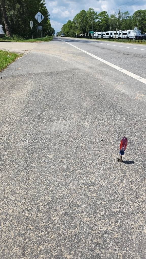

Issue is the oil attacks the Asphaltic Cement in the asphalt, ie the binder. You might try a weed burner to burn off the spill; but diesel, and hydralic fluid are he'll on asphalt. The picture is from a fuel spill, about 40-80 gallons on a roadway, and I could easily stick a screw driver through the asphalt, down to the base rock, with maybe 20 lbs of force. The whole affected area is gonna have to be milled out and repaved.
Yeah, no that’s not going to need to happen in my case. We are cleaning it up as best we can and not doing any milling or repaving, but thanks for the fear tactics.

I wasn't trying to say that in your case; but kinda just had the picture from work recently, and yep, that's really the only way to actually deal with petroleum damaged asphalt. Through the years, had many fuel spills (normally less than 120 gallons; although one was 6500 gallons of gas); hydralic, car fires, ect damage asphalt. A big depending factor, is how long it sits on asphalt, and how old the asphalt is (it appears old crappy asphalt with almost no AC content left, doesn't get attacked as bad), and of coarse the aggressiveness of the spill.
When I was much newer in construction, I ran over a 5 gal can of oil based Kilz paint on a brand new parking lot. Talk to painter; he says, odorless mineral spirits won't hurt anything, its about the mildest solvent know.... Every single time we broomed that area before we turned it over to owner, we never stopped brooming out aggregate.... think asphalt dollar general parking lot, ever notice the loose rock at the front 1/3 of the parking spots, oil leaks have broken down the asphalt.
