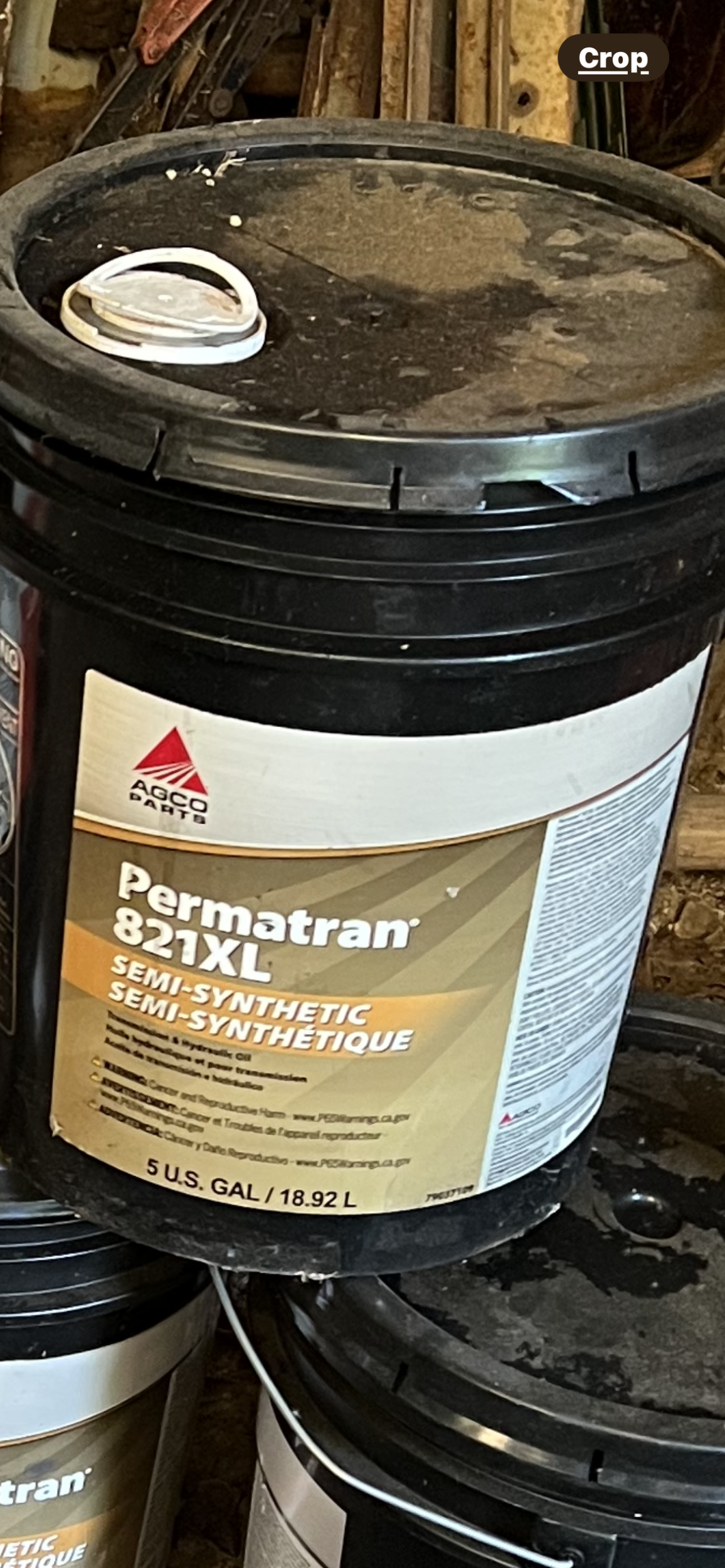

#32
Here’s what spilled. It’s used in both the CVT transmissions and the hydraulic reservoirs of my Challenger and my Massey.
To me, it’s hydraulic oil.
