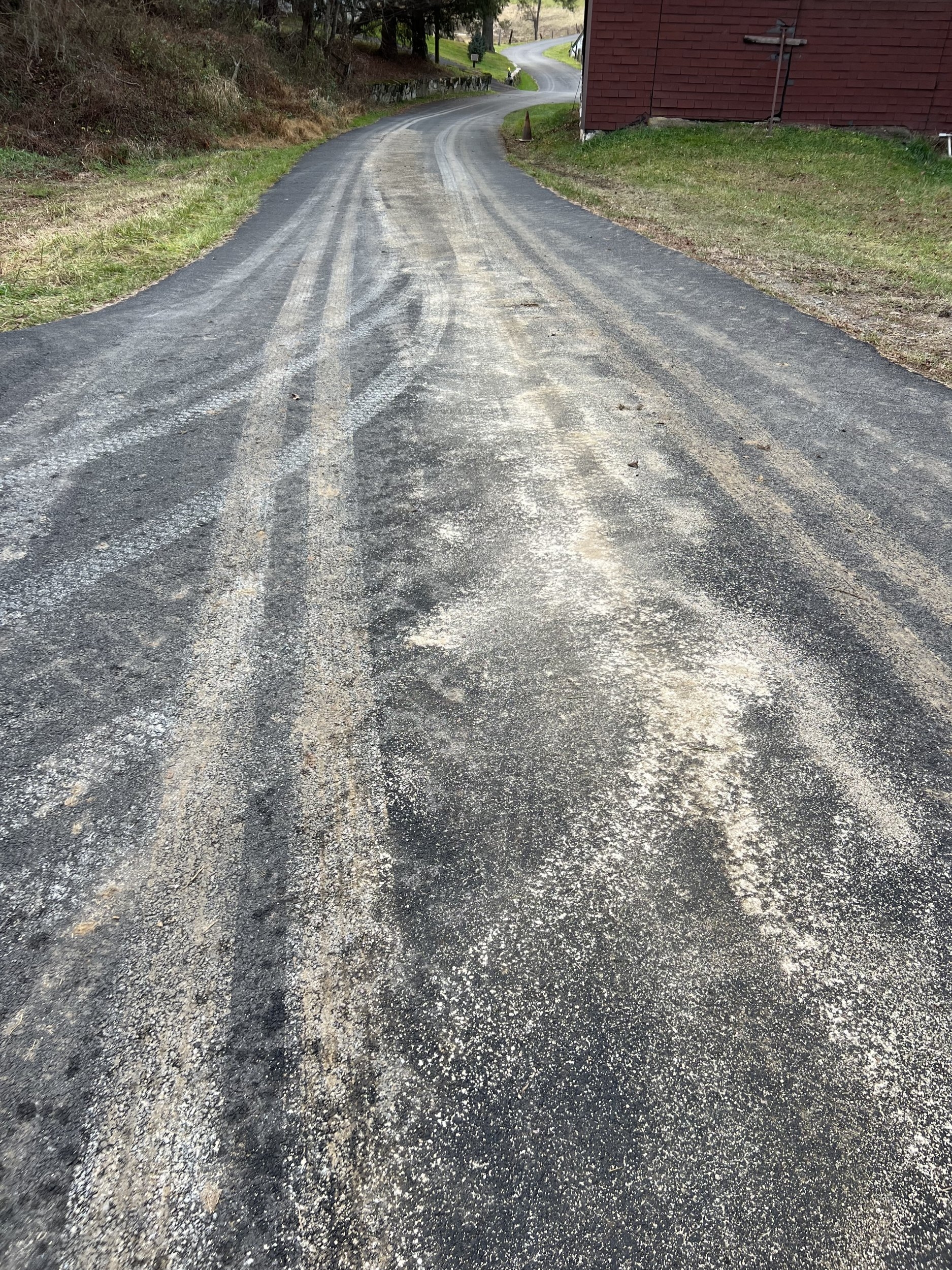

Had the misfortune of blowing a transmission oil return line down onto a customers driveway. Immediately Did the usual dose of kitty litter/absorbent.
This is no puddle. It’s a 100-150 foot long puddle.
Kitty litter did a decent job on what oil was laying on the surface, but now I still have the stain. I have been given a few different suggestions on remediation.
1. Wait until it dries and seal driveway. Issue with that is the driveway is 1000’ long. Might look odd to seal only 100-150’ of it. Whole driveway would be very expensive
2. Power-wash driveway with a Dawn & water mixture. Still pondering this solution.
Anyone else had luck with a very large stain like this?
I would be inclined to think that the asphalt might be affected by the oil as "Paulsharvey" mentions but if not affected I would give a try to Nano Soaps.
There was one I used to buy that was sold under "NanoGreen" but I can't find it anymore. This was a product developed as a fungicide for rice blight that was an incredible plant booster but was also an incredible de-greaser. (I remember from the website the claim that the US Navy was using it at sea, as non toxic de-greaser).
It was fairly expensive (like $100/gallon) but was used in 1 to 600 ratio.
That stuff was incredible for cleaning oil. One drop would instantly emulsify old motor oil mixed in water allowing to wash the container without leaving any oil mark.
I am sure that you would be able to find it under a different name while searching for nano soaps.
So if the asphalt is not affected I would try this on a small portion and would try to spray it on brush it in and then vacuum while rinsing.
On the other hand, if you have insurance maybe you should just let the insurance deal with it...!

Test on a small area first
WD-40. Spray this product onto the oil stain and let it sit for about 30 minutes. WD-40 is strong enough to not require scrubbing to remove the stain. If needed, you can choose to scrub the surface with a hard bristle brush before rinsing it off with water after another 30 minutes

Purple power from wally world.
My neighbor has great luck with using Purple Power from Walmart .
It's worth a try!
Good luck

The asphalt pavement is mainly oil and rock you just added a layer. No worries.

Sorry about your bad luck.
Hope the Trans is OK. That looks like a newer Driveway and after a year it will fade into the asphalt. Only other way I know of is to seal it in a year or so.
If it is still fresh, you could try dry sand and leave it on for a few weeks. It may absorb or sink into the substrate.
