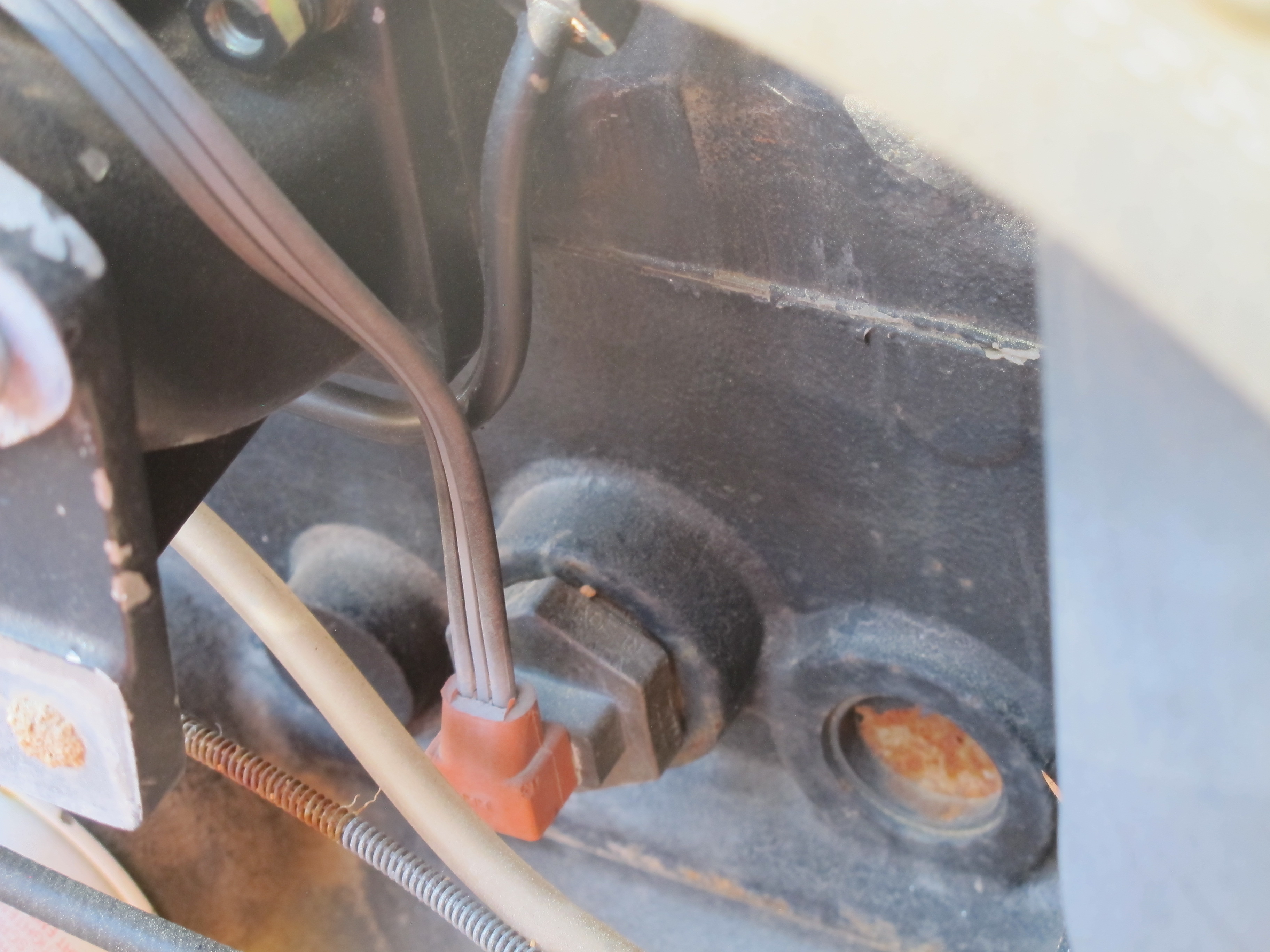

For what its worth, and want to save you guys some grief, is the plug I removed from the engine block to install the block heater is NOT robust..its hollow and not solid...so too much force and it will break off...As I mentioned before, I got lucky.

Here's a picture of my YM165D like yours but with the plug removed and the block heater mounted. The original plug was hollowed out for about half of it's length, but solid on the part where you put the wrench on it. Don't remove the "freeze plug" to the right of it.
My plug on my 155d was a pure solid plug. Maybe they installed some hollow and some solid ones? :confused3:
