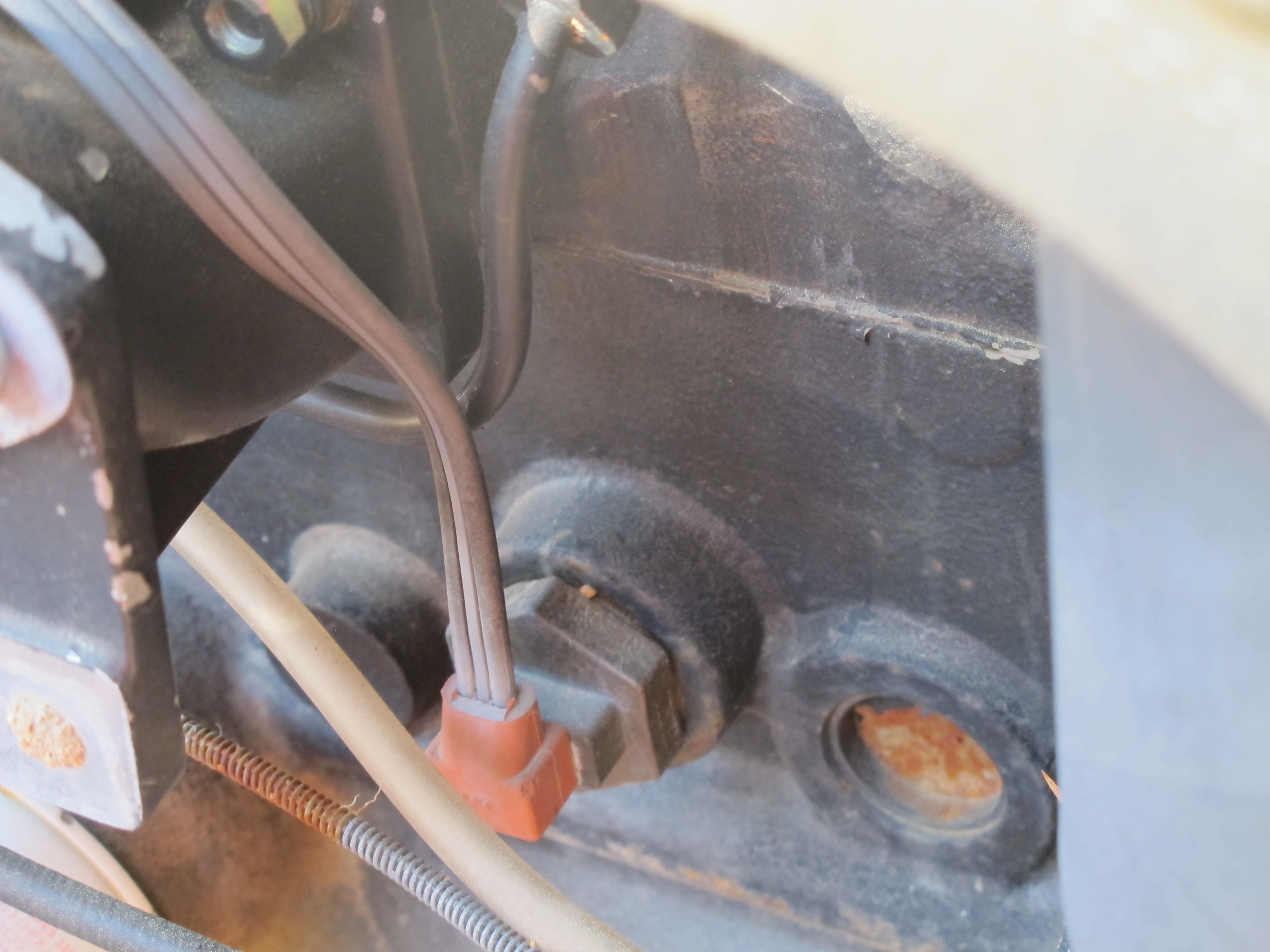

Having read only the first few replies I'll wade in on a different tack (sailing analogy, but sailors don't like having to "wade in").
I had cold starting issues a few years after I bought my tractor, it was GREAT at first but seemed to get a bit worse every two or three years.
I went the lower hose heater route, which helped - a bit.
I went the block heater route, which (with the lower hose heater and a splitter extension cord) helped a LOT - - but I was burning up something like 1500 watts for at least a couple of hours and all too often the need to use the tractor would pass before the block would be warm enough to start anyway.
EVENTUALLY a situation arose where I would have to haul the tractor to help with a project and leave it overnight with NO chance of an electrical outlet within 500 ft.
SO, it was time to figure out what was REALLY wrong with this tractor that cold started so WELL when new.
OK, I've already made this short story into a long one.
I removed all the glow plugs and metered them, 3 were open circuit, one read 38 ohms.
I paid $83.xx for all 4, with shipping - about 1/2 of dealer price.
Probably an hour to get them out and meter them, 3/4 hour to put everything back together.
In retrospect they probably went bad one by one, when the first one went it was so subtle that I probably attributed the difficult starting to the sudden cold spell.

His Yanmar does not have glow plugs, it has a thermostart system. Inside a Yanmar thermostart (glow plug) unit.
However implemented and whatever it is called - it is the "cold start assist system" this is just a different implementation of "glow plugs", in fact it seems to be a super low cost design that uses just ONE glow plug.
Regardless, if it has failed it needs to be repaired ANYWAY.
Getting around the failure by raising the temperature of the block and coolant isn't SOLVING the underlying problem.
So, about $30 for the glow plug (kinda high) or $95 for a whole thermostart kit ?

Hoyes....good luck...if you can get it installed..it痴 well worth it effort
That's exactly my opinion of block heaters. If the existing plug is stuck firm, it's not worth endangering the block because there are other options. But it is the best kind of heater. I'd advise that you go ahead and get one from Hoye or your favorite parts dealer and then try to remove the block plug. If it installs without too much force - and most do - then you have the best solution. If not, you're only out a few bucks. Block heaters heat well and last for decades with no maintenance. Give it a try.

Most of these Grey Market Yanmar Tractors do not have glow plugs, but a thermo-start plug. Yeah it can be considered a glow plug but it works differently. I believe on Scottys 2020 he only has 1 thermo-start plug, he wont have a plug for each cylinder like most modern diesels do. So his thermo-start could be bad, but having a warm block will always make starting his tractor easier even if his thermo-start did work, and this applies to gas engines too. Cold weather makes any engine more difficult to start.
