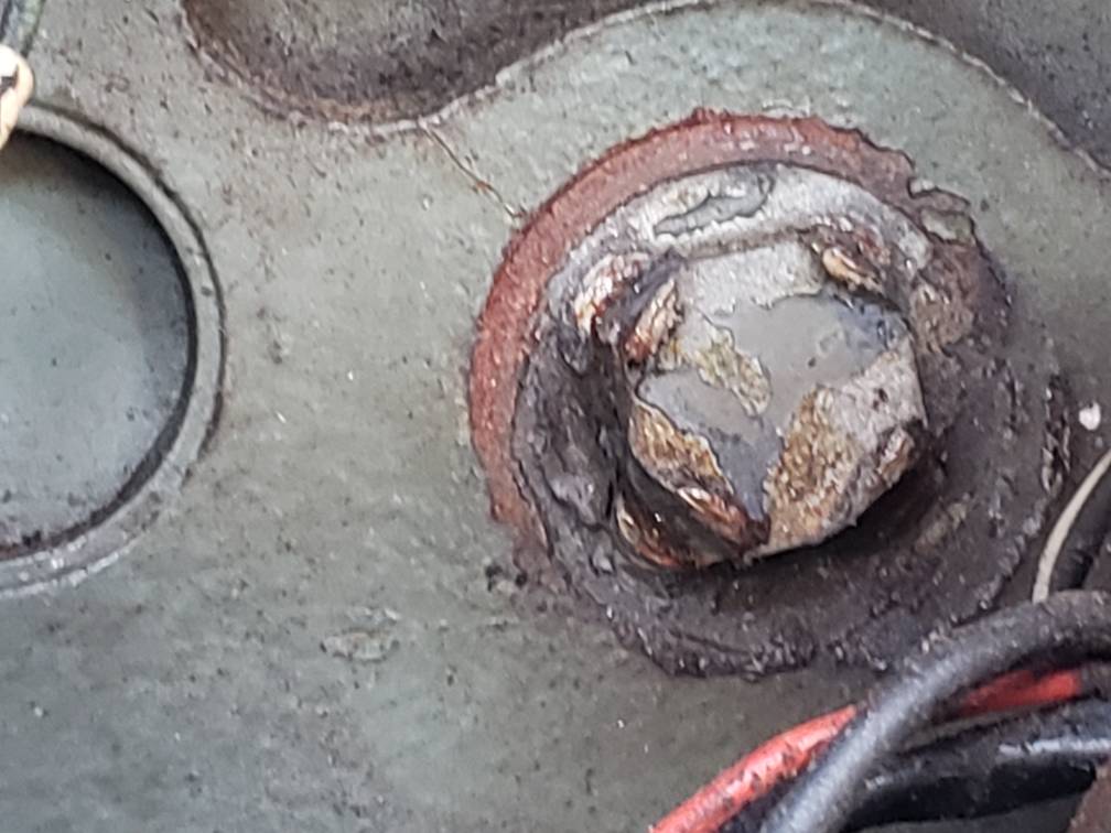

Along with Winston, need to know what you used to get it to this point to figure out what to use next. Honestly I still think you need to use a torch to heat the plug and surrounding area of the block, then you can put a pair of square vice grips on it and turn it out.
   / Removing Plug to Install a Block Heater - Need some ideas #79
You don't want to heat the plug, just the block. You want the block to expand, but not the plug.
But, I agree it's not coming out without heat.
#80
I used the square end of a 3/4 drive socket adaptor. It fit pretty snug but not snug enough. honestly, it was rounded a bit from prior attempts. I have a clean shot at the plug, but would need to remove the starter to get a file in there to flatten the sides a bit. I was thinking then welding together a homemade square socket using bar stock and then welding it to a 3/4 drive extension. I agree, I do need to get the block very hot around the plug before this guy is going to budge. Without knowing if this is a solid plug or something weaker I am concerned about ripping a hole in it and then be in a world of hurt or worse yet damaging the block itself. Always looking for additional suggestions!
