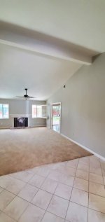

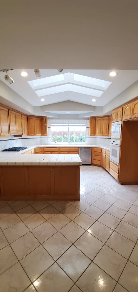

Alright here's what we're starting with. At least in terms of areas I want to address.
My wife is a fan of interior design and I enjoy smashing things and putting them back together so we make a good team for this sort of thing. I'm usually off the opinion that I'll smash it now to force myself to fix it... definitely not shy about renovation.
With this house the exterior definitely has some hints at spanish architecture and being in San Diego wev really like that anesthetic and wanted to carry that into the house a bit. At this point the house is kind of more traditional on the inside.
As for the photos attached here...

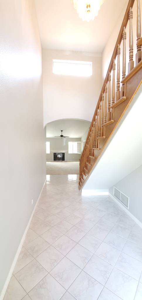

The staircase is probably our least favorite part of this house. When you walk in, you're looking right at the underside of a long, narrow staircase and it just kind of hits you as an eye sore. So we need to do something about that. Decided to put a curve in the underside to fill in some of that empty space and we actually have seen those curved undersides in Spanish architecture. Also, a tasteful wrought iron stair railing would be nicer. Finishing off the entry way we'll add a new chandelier.

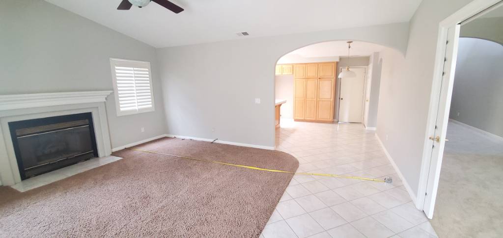

There are two rooms with fireplaces downstairs. One is originally wood burning but seems to have been converted to gas and the other is a drop in gas unit. I'll be framing out some superficial decorative walls to mimic visible interior chimney lines on both of these, and doing some tile work on the original brick fireplace. The gas one I'm hoping to just do the decorative frame around it and maybe replace the doors.
In the living area that you walk into from the entry, we want to replace the existing pocket doors with larger pocket doors inside an archway. Technically the width will be the same but the height will increase by almost a foot. Also we want to widen the existing entry it the kitchen which is currently a very small doorway.
Oh, I forgot to mention in my first post that we need to put about 30 can lights in the house because there is very little in the way of lighting. 20200612_161834.jpeg20200606_124914.jpeg20200625_185004.jpeg20200606_124904.jpeg20200619_124607.jpeg20200619_125315.jpeg

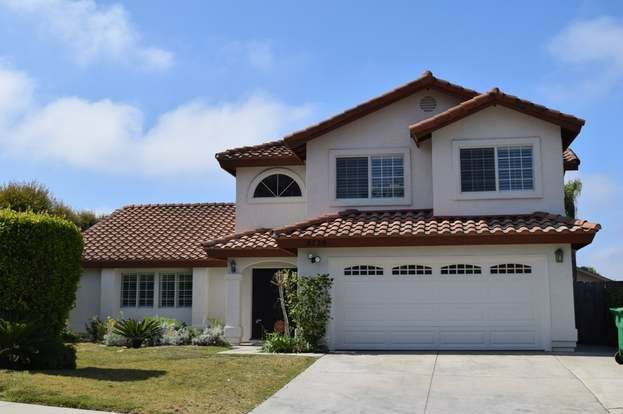

I realize I don't have many photos of the exterior but here's one I found on the internet. No big plans for the exterior yet. genMid.200023940_0.jpeg

Biggest job here is full demo of the kitchen and blasting out all of that ceramic tile, which is at least 400sq ft.

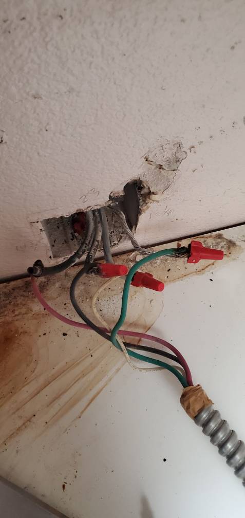

First order of business was to figure out what was going on inside the soffit in the kitchen. We wanted to get rid of all of these soffits and just have the vaulted ceiling in the kitchen. But knowing what I know about electricians and plumbers, they probably used those soffits to run everything.
Poked into the low decorative soffit and all I see is one line of romex and a plumbing vent. Easy!20200630_175637.jpeg

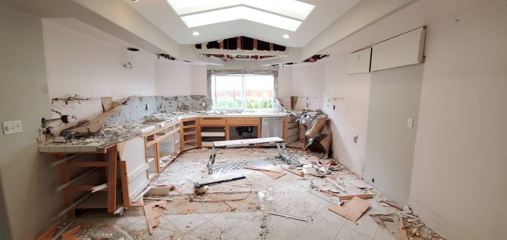

Day 2. Just smashing everything in sight. My brother and our long time handyman came over to help. I'm not sure why I didn't hire more hands for this... I always forget how hard demo work is. All of this stuff is designed to not break and here we are trying to break it.

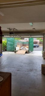

Got 40 yard dumpster... never renovate without one. Never pile all your trash in the garage. Lessons I've learned. If you have to pile trash, pile it outside so you'll be forced to clean it up or be the neighbor with a pile of trash in your driveway.
Today I'm just focused on the kitchen... removing the old appliances and hoping to make a much progress as possible on demo. Little things like removing carpet pad, glue, tack straps and a house full of baseboard trim take forever and are surprisingly tiring.
I rented a 20lb hammer drill to bust up the fully floated tile backsplash and countertop. I've seen these before and I knew right away that it would be floated and the best tool for the job is a demo hammer with a wide chisel bit. It's actually the vibration that loosens everything up and the tiles fall off leaving the thinset backing.
Cabinets were installed extremely well and everything was both screwed and glued together. Wanted to salvage the cabinets but eventually we gave up on that plan and busted out the Sawzall.
Tip: get those aggressive demo blades for your Sawzall. Don't use old dull multipurpose sawzall blades. 20200701_113251.jpeg20200701_093435.jpeg20200701_113256.jpeg20200701_113252.jpeg

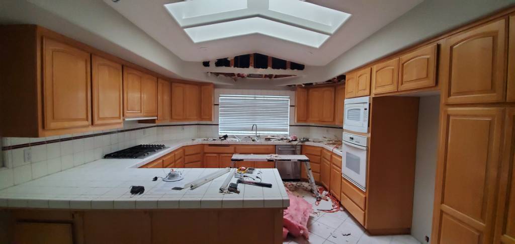

   / Renovating my house in the suburbs
#9

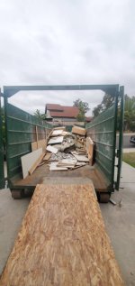

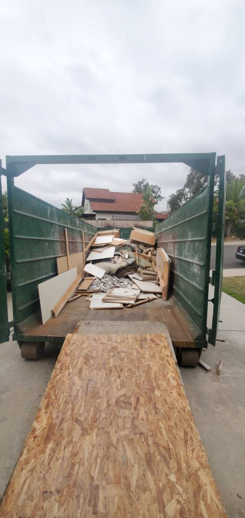

Day 2 demo... spent eight hours running a 20lb demo hammer and don't even know where I am at this point.
I knew going in that the entire kitchen backsplash and countertop was a full float... the best way to demo that is with a demo hammer. It shakes everything up and the tiles fall down. The counters are best to basically chop into sections and not try to break everything up. They'll be heavy but this is the easiest way I've found.
Kitchen cabinets were installed EXTREMELY well. Nearly impossible to remove without destroying as they were all screwed and glued together. So, sawzall was brought in for that.
Poked into the soffits above the cabinets to see how much trouble I was in for with electrical. As expected, one side is like grand central station and the other side is pretty empty. If I can i might just notch the studs, run the lines horizontal as they were, and cover with nail plates and move on. That is if it's too much to reroute everything.
Oh, here's a tip. When you're breaking up ceramic tile with a jackhammer, wear sleeves and a full face shield. We found pieces of tile flying up on to the second floor from the work being done on the first floor. Oh and I took a few shots in the face.
Dumpster filing up quickly.20200701_125206.jpeg20200701_113252.jpeg20200701_130558.jpeg20200701_141440.jpeg20200701_125312.jpeg
