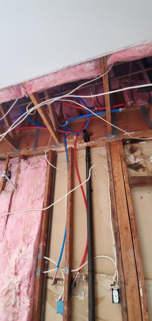

The devil's in the utilities. 20200710_115235.jpeg20200706_181101.jpeg20200707_154850.jpeg

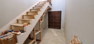

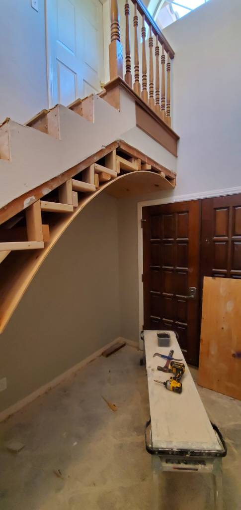

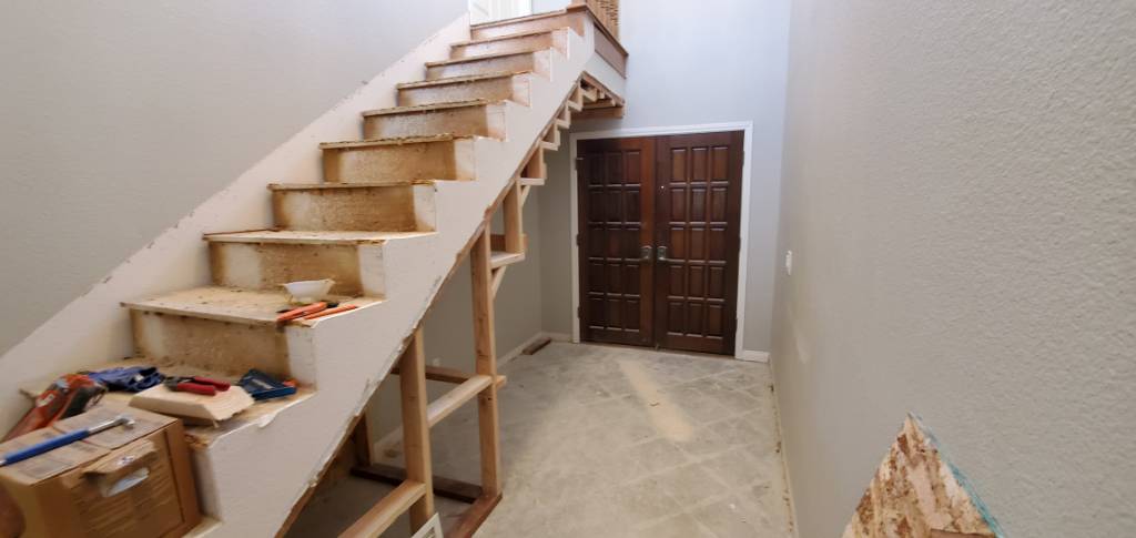

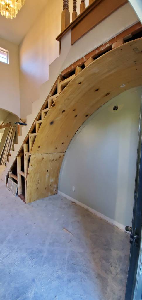

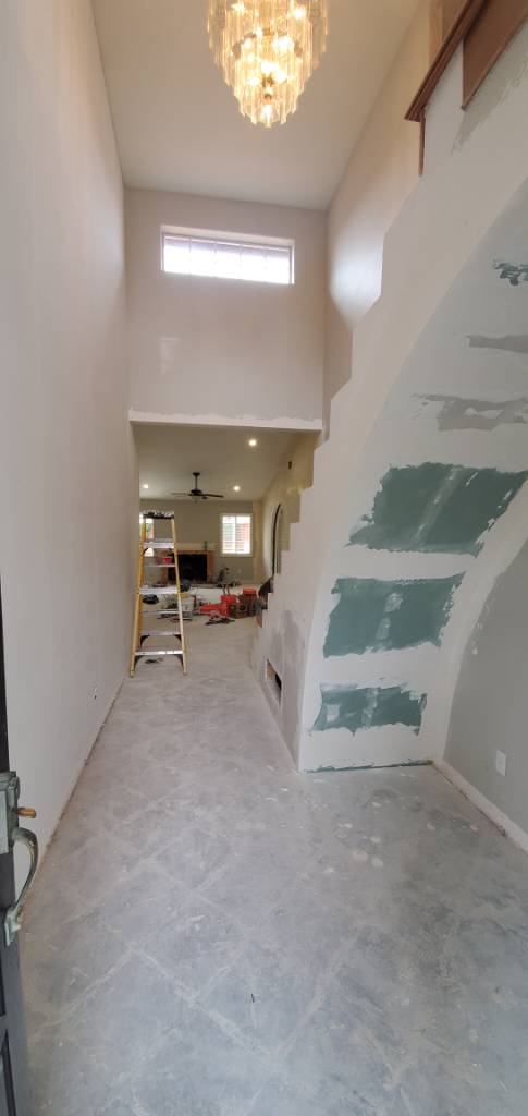

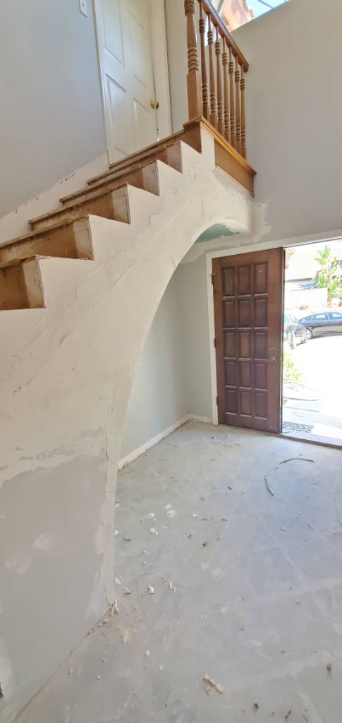

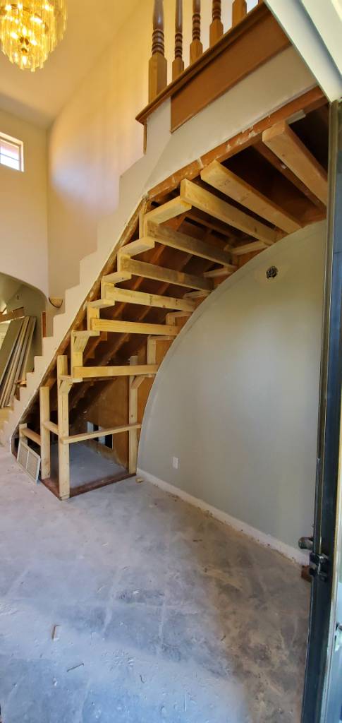

Remember that staircase?
I don't really know if there is a "right" way to do this but I knew I wanted to bend some thin plywood to form the curve. So what I did was draw the curve zi wanted on the wall under the stairs, then cut out the sheetrock. From there I just built like an inverse staircase with no particular rules other than make each row straight and strong enough to hang from. It wasn't pretty but should look good once it's all covered up.20200705_140821.jpeg20200705_140836.jpeg20200705_152535.jpeg20200705_164822.jpeg

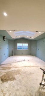

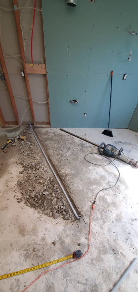

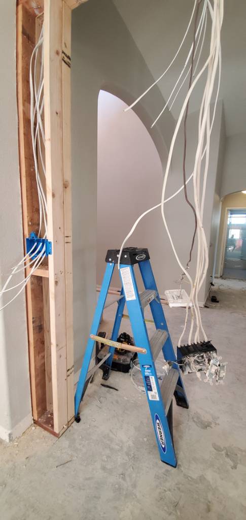

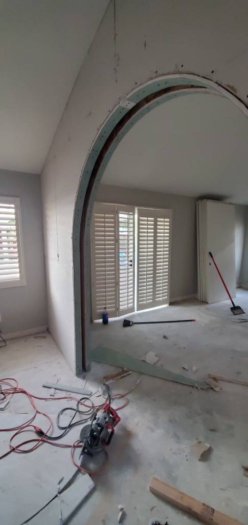

Always a good feeling when you draw the line and start closing things back up.
Also running a line in the kitchen for power to the center island. 20200709_185721.jpeg20200711_182142.jpeg20200711_182251.jpeg20200710_162003.jpeg20200711_182321.jpeg20200713_154538.jpeg20200713_195443.jpeg

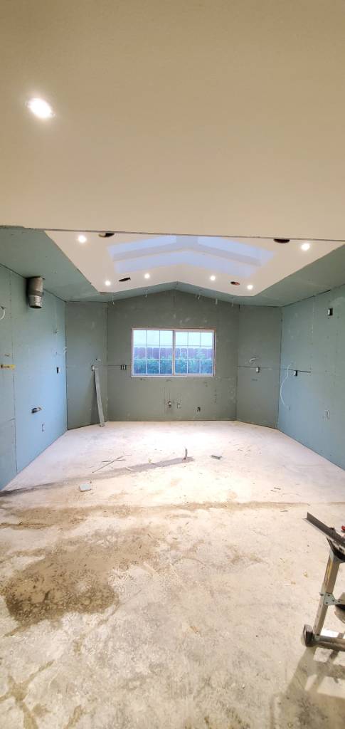

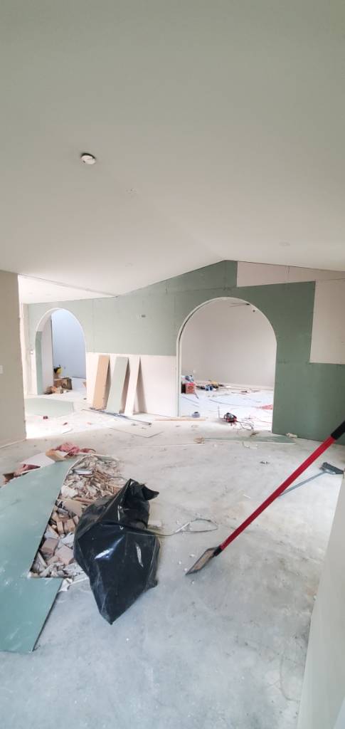

#24

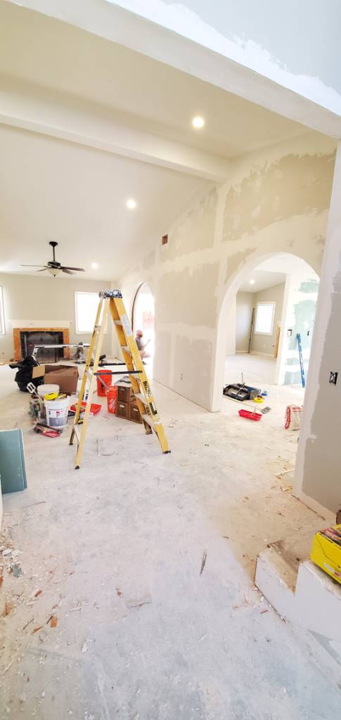

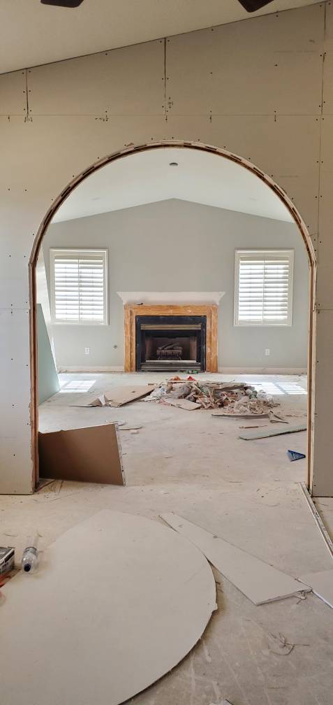

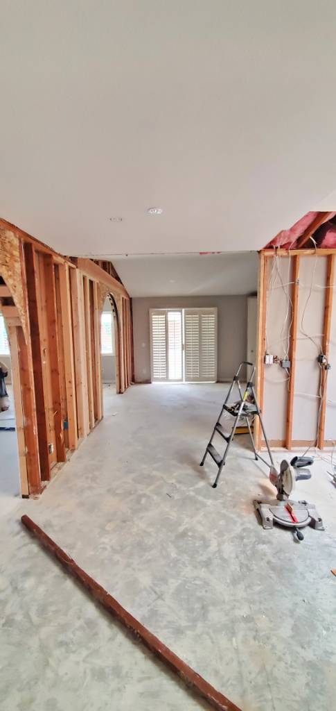

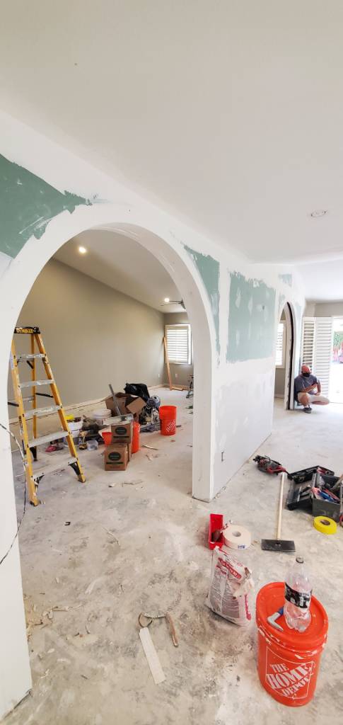

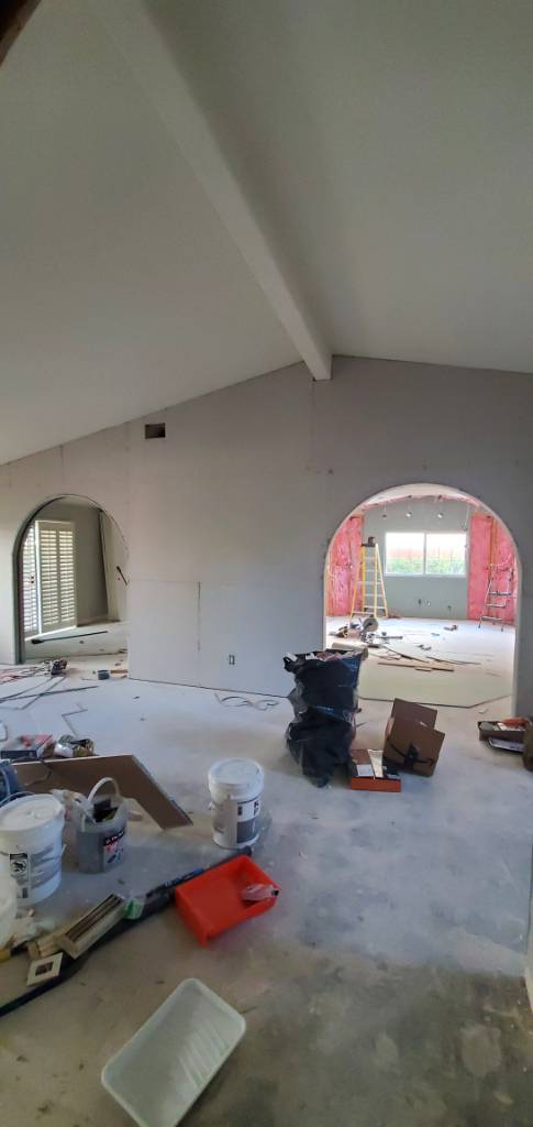

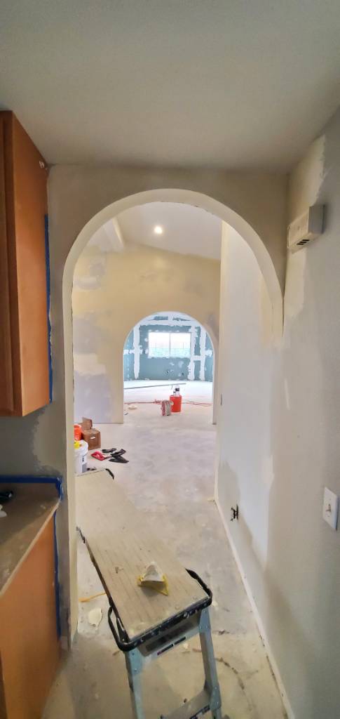

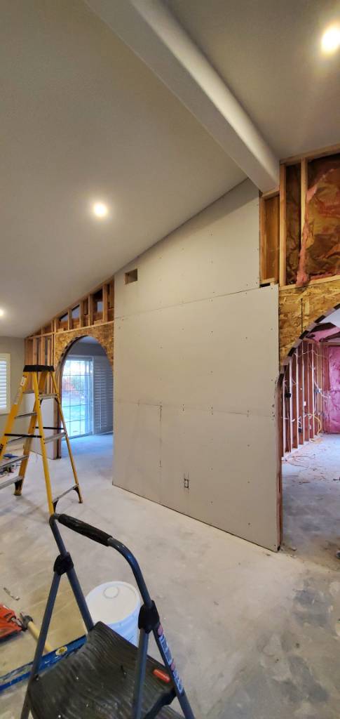

Doing all the sheetrock and mud myself... often at 10 or 11pm. Scrambling to get this place livable. We're suppose to move in on the 29th. At this point we're at July 16. Making my calculations on how to get this all done in a week...20200716_104739.jpeg20200715_175523.jpeg20200716_104726.jpeg20200716_104707.jpeg20200716_104636.jpeg20200717_091755.jpeg

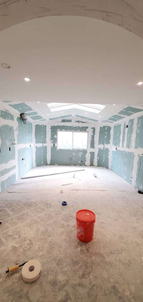

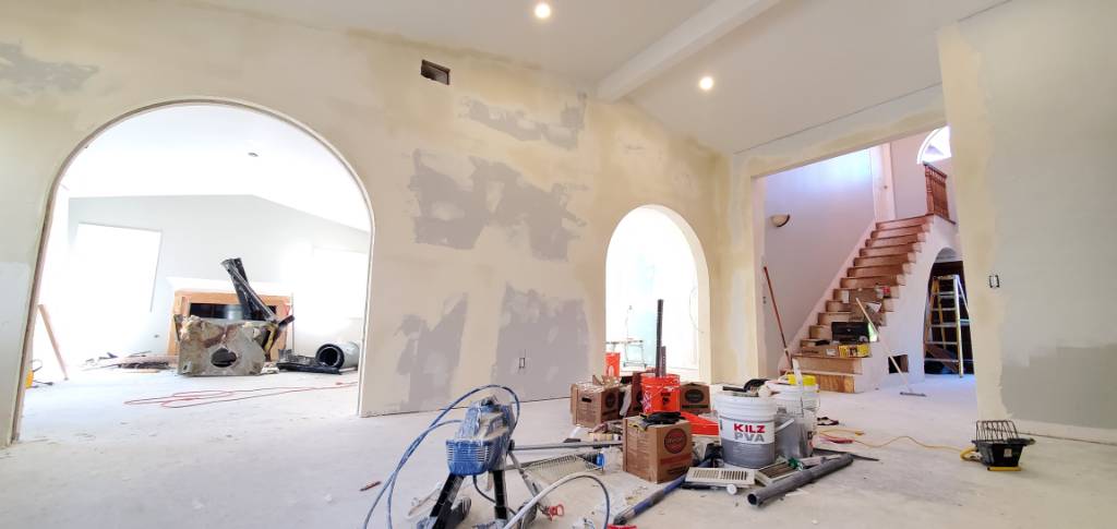

#27

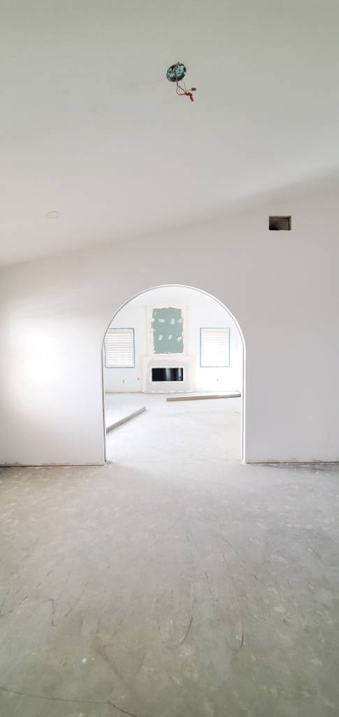

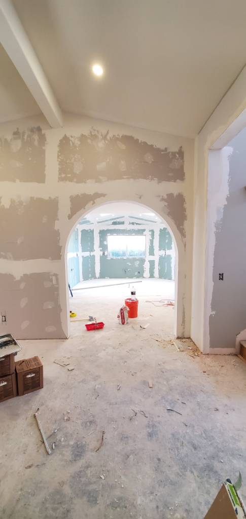

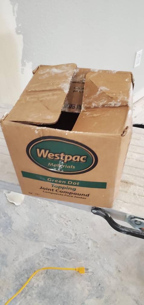

Back in the house... topping mud. Love working with this and a 12" blade. I barely need to sand after the last coat. 20200717_091852.jpeg20200717_161436.jpeg20200717_102602.jpeg

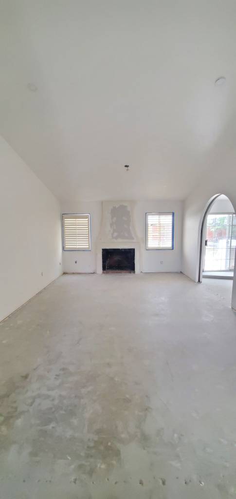

Got myself into a bit of a mess here. I started prying away at this gas fireplace trying to get some of the trim pieces off, in hopes of disconnecting the insert from the chimney so I could put a new insert in. But that led to basically destroying the entire insert unit. I really dislike these because they don't look very good and only serve one function... this one looks like it was not used much.
Anyway, in the process of two hours of prying and tugging and disassembling this thing I finally lost patience and busted out the sawzall when all the screws I found still didn't loosen the insert from the chimney. If you know much about these, you know where this is headed.
Once I literally cut the chimney off of this (I was at the point of no return), I tugged the insert out... then the entire chimney sleeve just came crashing down into the space where the insert was. Mission failure, total failure.
I spent the better part of a day almost depressed about this fireplace situation as we have a two day old baby at home and I'm trying to figure out if I can get a new insert, or build a masonry fireplace... but we don't even plan on using this, just wanted to do something decorative.
My wife suggested a fake fireplace and I got to digging on Amazon and found an electric fireplace. Eureka! It'll look like a fireplace and even have fake flames but none of the other trouble.View attachment 670321
