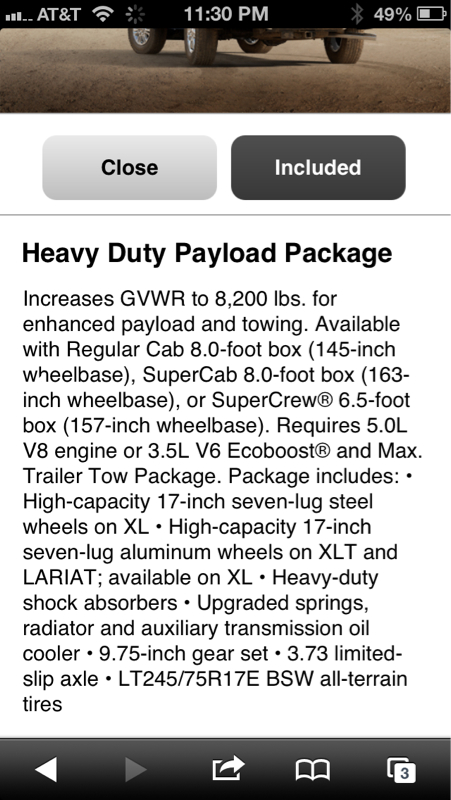

Well at least you get it now. 1/2 ton trucks are not HD trucks even with a 3/4 ton suspension under it like the Ford HD package. If you need an HD truck, get a 2500/3500.
Nice to see that RAM is still under rated with 3900lb axles front and rear. What size plow does that Ford 3600lb axle take?
With the new air bag suspension, high tensile steel frame, 6 and 8 speed transmissions, etc... they could easily put a 7700lb GVWR without changing the axles or drivetrain. I think they are pushing more towards making the light duty 1/2 ton truck back to "light duty". Truck capacities have gotten out of hand in the numbers war...
You were making fun of my NON- HD door sticker? You still haven't retracted any of your multiple misinformation.
Actually I was making fun of the fact they market the F150 has a HD work truck yet sell it with P rated tires and lower axle ratings even with the "Max Trailer Tow Package". Your sticker proves it.

FOR THE UMPTEENTH TIME, MY TRUCK DOESN'T HAVE THE HD PAYLOAD PACKAGE!!!!! HAD I ORDERED THE HD PAYLOAD PACKAGE, IT WOULD HAVE LT TIRES ON IT FROM THE FACTORY!!!!! Not an option for the rams. One more time, repeat after me, "jejeosborne's door sticker is on a truck without the HD package, had he ordered the HD payload package, it would have come with LT tires directly from the factory"
It is obvious fiat is moving towards light duty. The specs show this.
Plow? I have no idea. I plow with my tractor the two days a year we get snow. The ram 1500 will not accept a plow either so why bring this up? The Ford can with the 6.2 liter because of hydraulic power steering.
