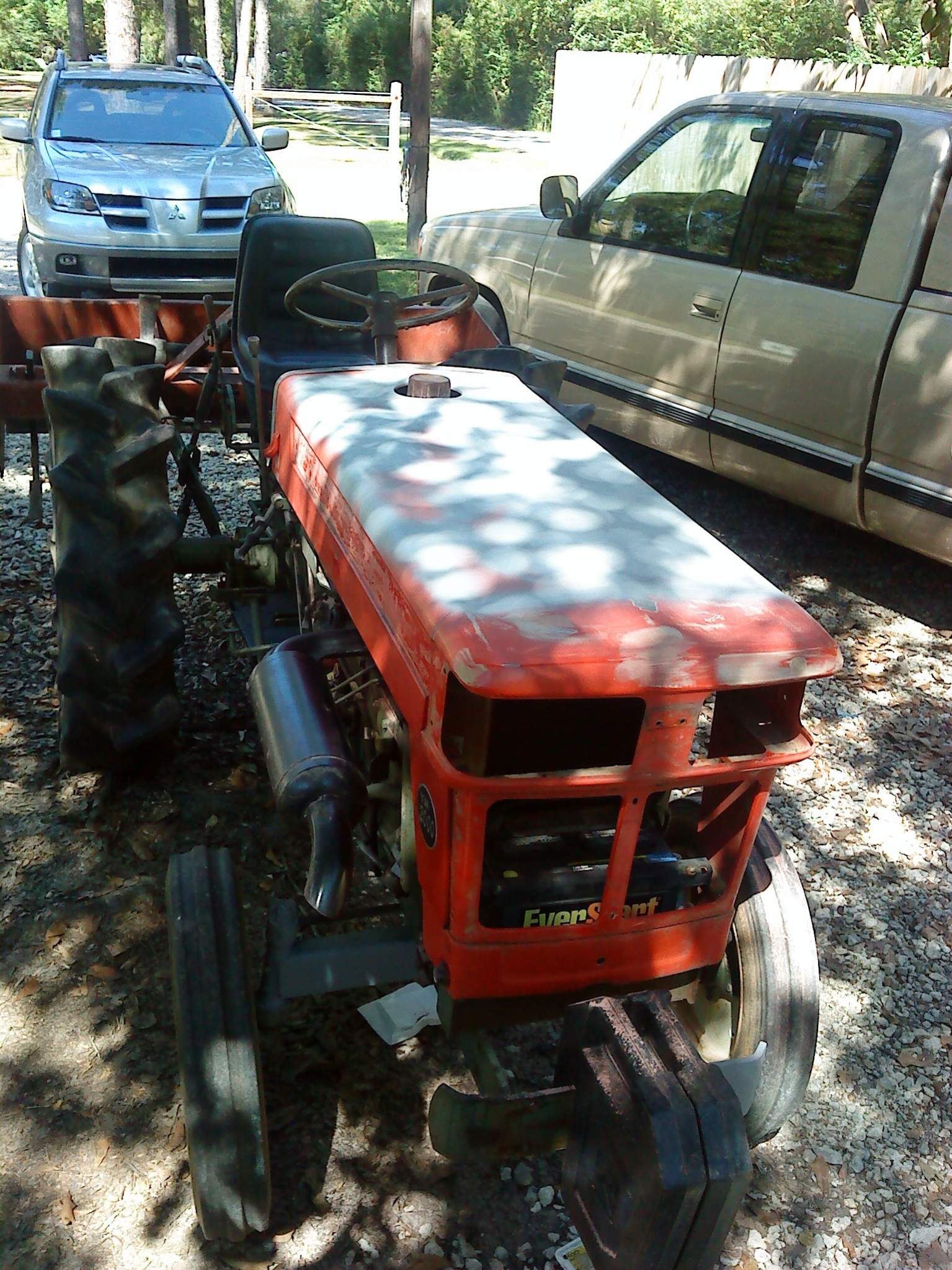

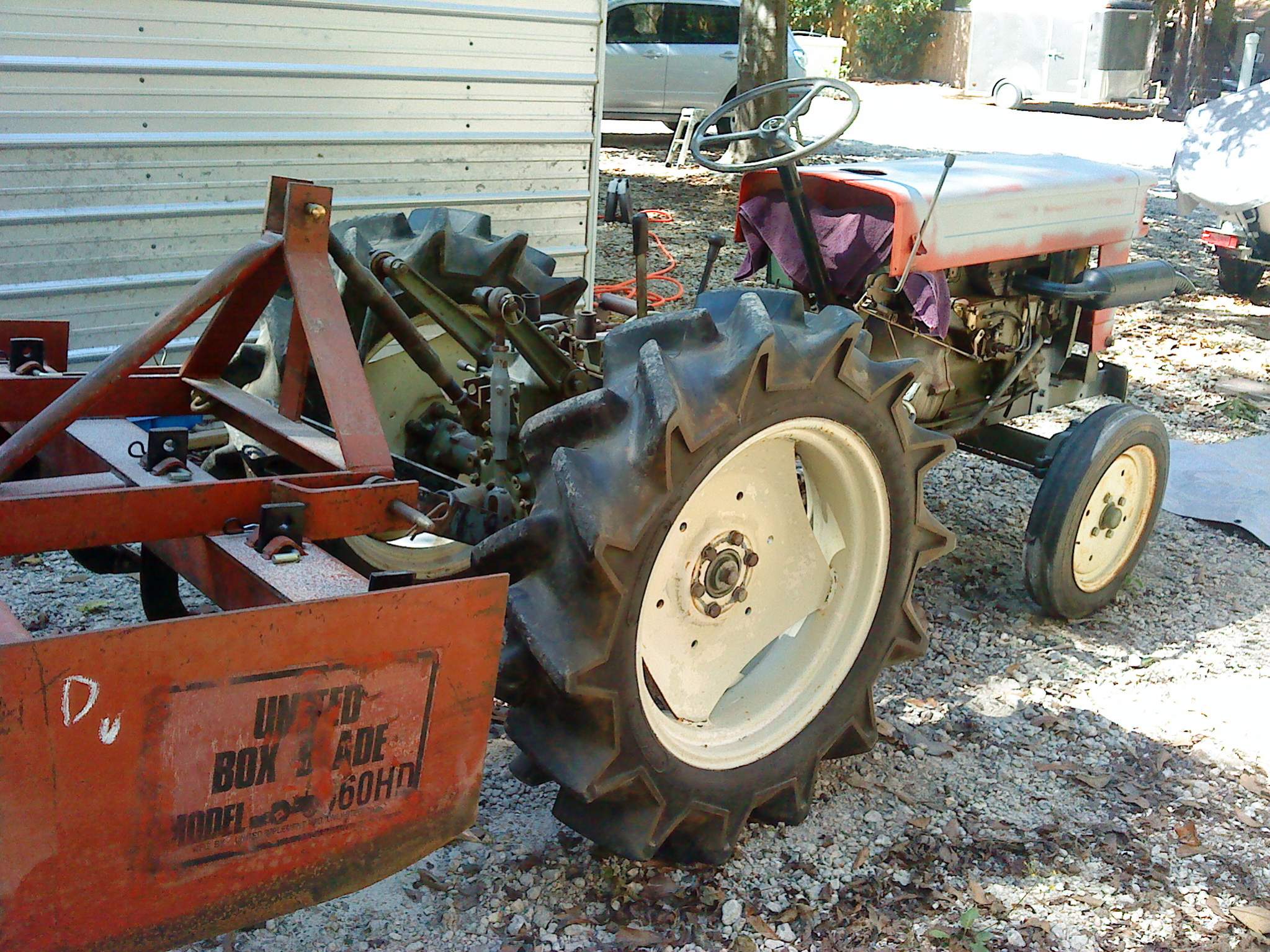

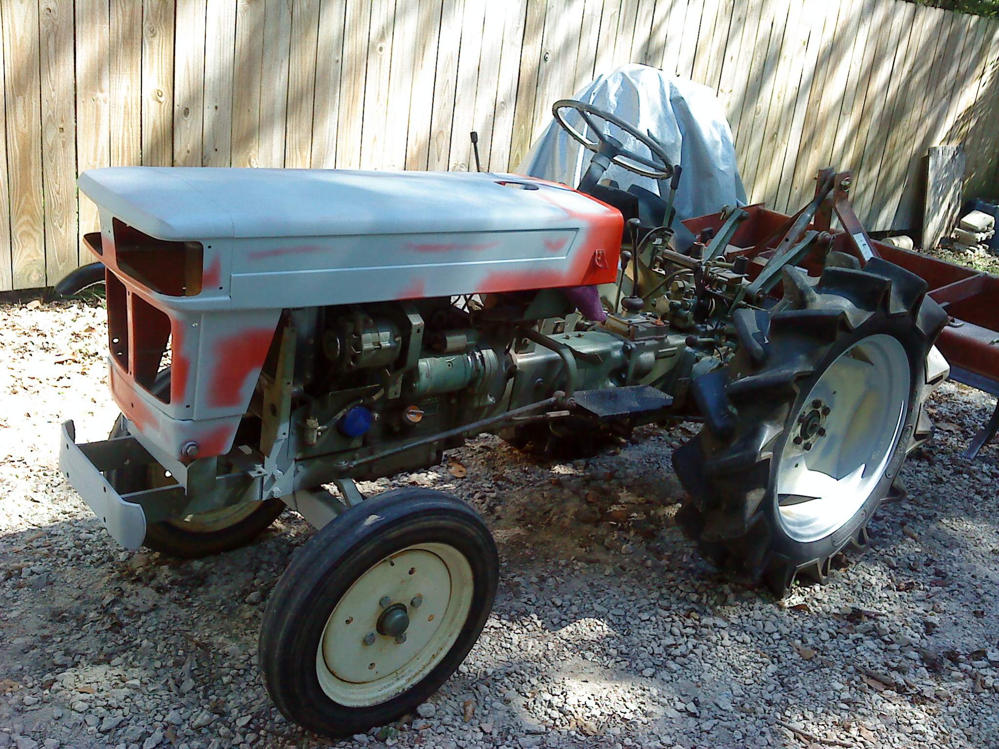

Started repainting my YM2000, I will post photos as I go. The fenders and the hood had alot of surface rust spots, ground and sandblasted all the spots, filled and primed. Using TSC implement paint MF red, white, and black for the frame and chassis, First pic is before, second in process

Looks like your making good progress. Lookin good. :thumbsup:
/ Repaint YM2000 #3
To be honest the tractor looked good as it was...paint looked better then most I see. anyway good luck with it.

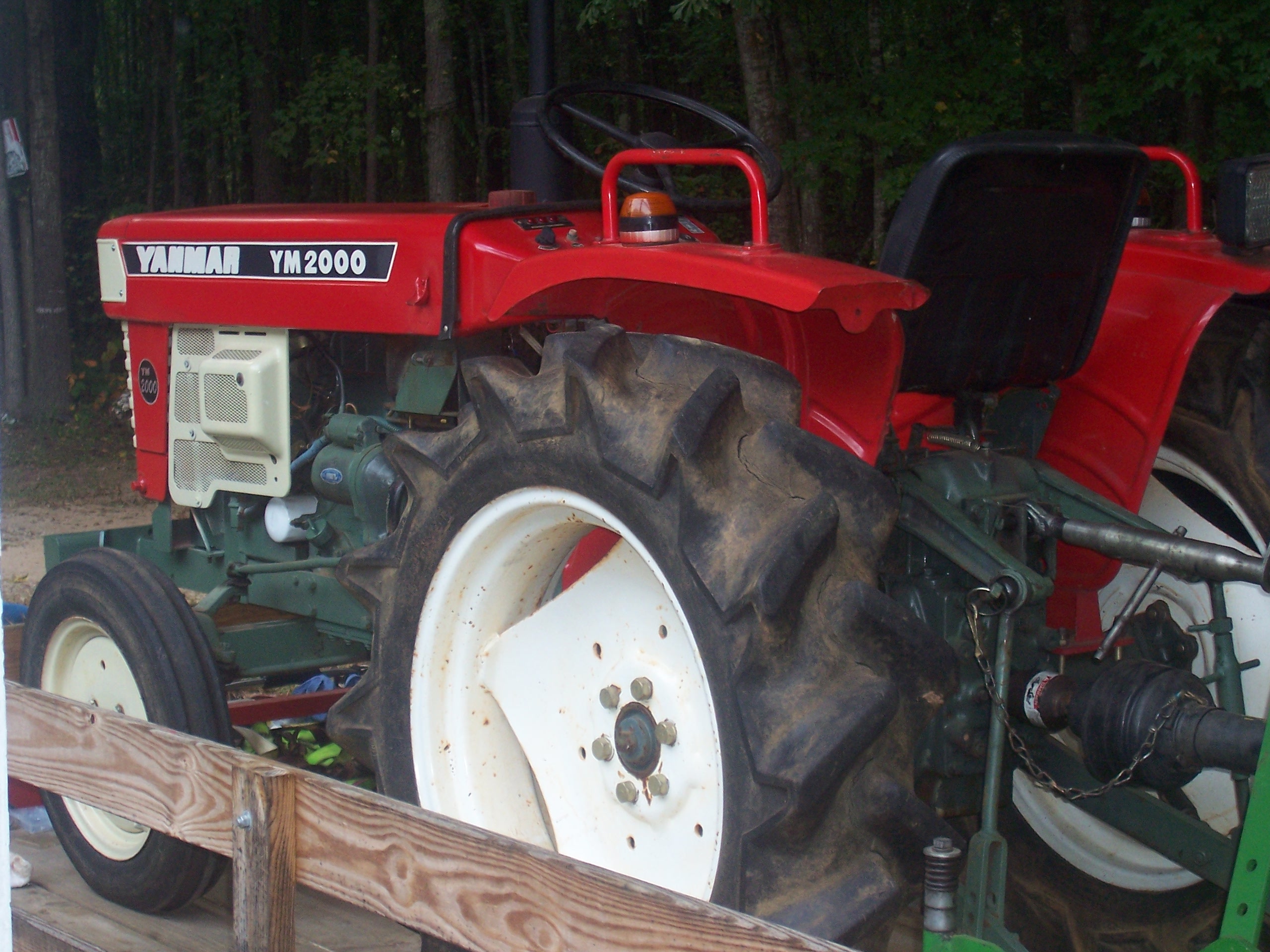

I just used touchup in a spray can I've had since I Bought my tractor that I purchased when I was buying parts. Finally got around to useing it and looks good enough for me. It's a 35yr Old tractor made for work! I've never been a Desk Jockey and if you had a Busy or Rough Day your useally dirty and maybe a Little Scratched up at the end of it. I'm over 10 yrs. older than my Tractor and now I'm thinking I could use a little touch up in a few places myself. :p:laughing:

Main reason I'm doing repaint is the rust, Living on the Gulf Coast with the salt air, I didn't want to end up with major rust. Regards

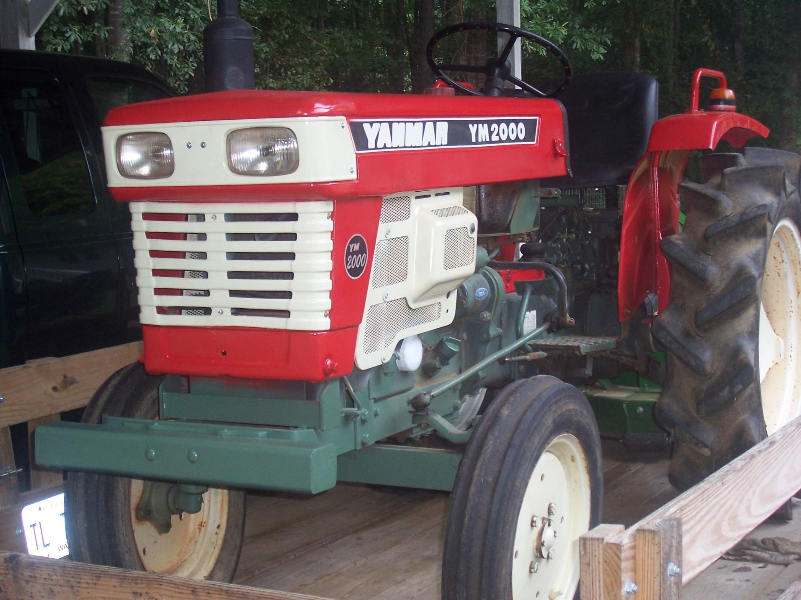

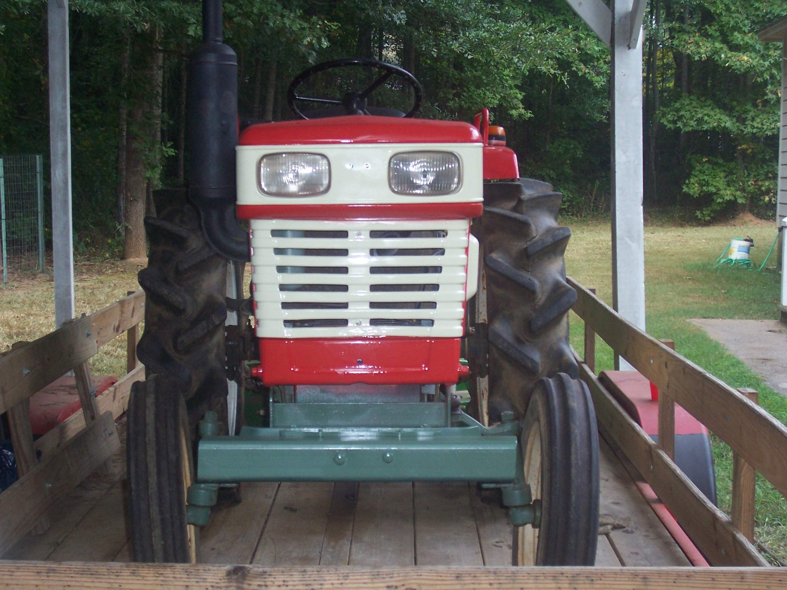

A few more pics, Pulled fuel tank, pulled all wiring and acc., pulled dash, battery, seat. Repaired some more spots on hood, cleaned all the glue where old stickers were. Started cleaning up rust on frame and motor and priming bare metal. Have a great day
Unless you plan on stripping, cleaning, priming, painting each and every piece on the chassis, engine, and frame, I would forget about changing to black and just touch up the green, otherwise you could end up with a big mess.
/ Repaint YM2000 #11
I agree with Normde...the green will always want to show through especially around the grease. I tried this an implement and it looked great for about 6 mo then it was a mess ...I then had to do it right.
/ Repaint YM2000
#12
I worked in auto body repair for almost 20 years, I think I will have good luck.

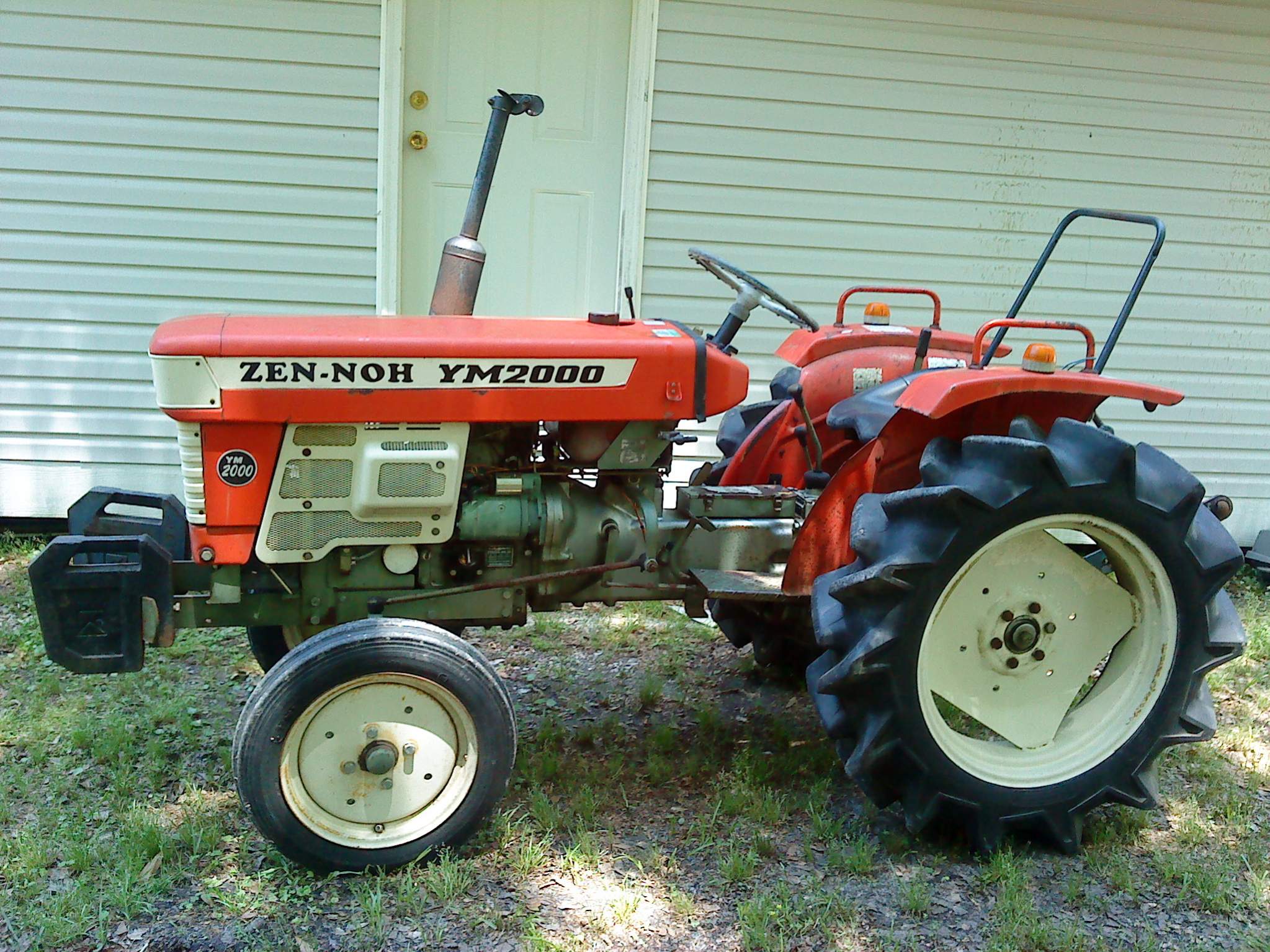

Finally got out today Clemsonfor. Interesting never noticed the difference until seeing shawnjvl's pic. Here you go.You can see I was in them when I bought it.Figured a mid 70's Model I needed to see if they needed Repacked. Nope there sealed FWIW ;)

I believe Carey has the heavy duty frt axle option, Wish mine had it. I think Carey you have tapered roller bearings instead of the ball bearings like my 2000 has, which I already had to replace.

My (US) YM240, equivalent to YM2000, has the optional HD, adjustable width front axle same as shown in the back of its parts manual under 'options'. (And I assume this is simply the axle off a larger model). I think the tractor was ordered loader-ready, and the loader may have been put on before it was ever sold.
Mine has the four cover bolts as shown in Carey's photo. I read somewhere, and have always assumed, that this is a sealed bearing. Seems to me it would have to be, the way these tractors are run half submerged in the rice paddies.
