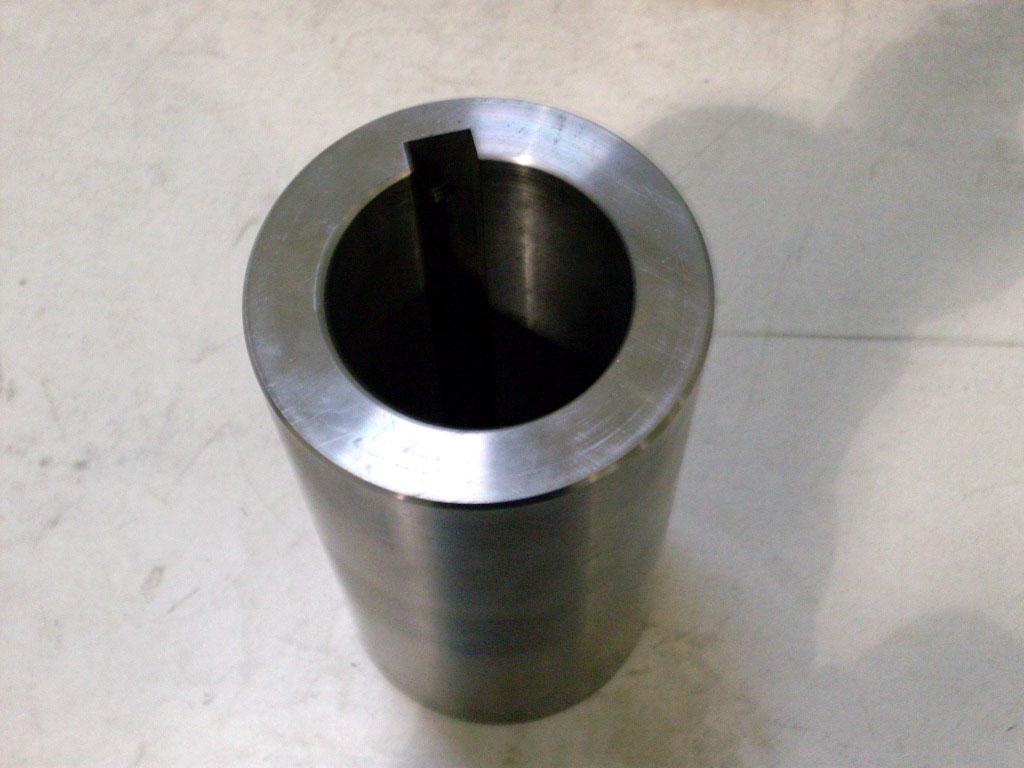

i've got a used inland snowblower. this is my first season with it and my second storm.
the "spindle" on teh blower that the pto shaft connects to is odd. I feel like I'm a pretty smart guy, but I just don't get this.
the "spindle" has a slot in it, with a piece of metal that has been welded into it. the metal sticks up past the surface of the cylinder, and then the "sleeve" of the pto shaft can slide over it. My assumption is that the sleeve with this keyed cylinder were originally like that and that is how power is transferred to the blower. but why is it welded on with a tiny little weld? the piece is now gone because i lost it.
there is a pin that goes through the same sleeve and cylinder, and i would assume that the pin isn't helping to transfer power, but it's there just to keep the sleeve from sliding forward and back.

If I'm understanding it right, it sounds like a keyed shaft coupling with a pin (or bolt) to keep it from sliding apart. The key is square steel and both the shaft and sleeve have matching keyways cut in them so the assembly transmits power. Sometimes the key is a tight fit in one part so it doesn't fall out. They're usually not welded in but sometimes they are - some are even silver-soldered, common on older machinery.
A hardware or auto parts store might have a selection of keys. The pin is to keep it assembled. A small bolt will work for this if the key is installed to take the torque.
Sometimes connections like this only have a pin or bolt, no key.
Edit: For my 90" rear finish mower a 1/2" diameter grade 2 bolt (no marks on the head) works. If your bolt or pin shears off too easily, it's probably smaller than 1/2". If you don't have means of drilling both pieces out for a 1/2" bolt, you will need to use a key. See post below.

rbargeron - it sounds as if you are suggesting the key is what transfers the power, and a bolt would not do the same thing. perhaps the key that was in there was welded on just to keep it from rattling around? if keys come in various sizes, maybe the one that was there when i bought it was slightly too small...
now that i think of it, there's a little hole above the key. i think it might be a hex head screw to bite down onto that key.
okay. i'll get a key (yahoo. nothing like wasting time driving to the big city...) and try again. then it's a matter of finding the right pins.

the pin holding that sleeve on was a grade 5, and then a grade 8. I broke both of them. For both times the key was not attached with the weld and the connection had a tiny bit of play in it. did i shear those bolts because the key was not welded in (and that hex screw wasn't tightened down), or is there a bigger problem at play?

Maybe I'm wrong, but it sounds like you need a woodruff key. They come in various shapes and sizes, but they "key" the PTO shaft to the input shaft to transfer power to the implement.
The previous owner probably tack welded it in place, because they can be slippery little devils.
Measure the width of the slot and the combined height (or depth) of the two slots. Length is not as critical, use the longest key that will fit. They don't cost much at the hardware store, get a couple of spares.
The little hole is more than likely threaded and a set screw will snug the key down, keeping it from wiggling and moving around. Hopefully the key fits so snug that it won't move anyway.

If everything fits together snug the key should not need to be welded in. But if it's been wearing and getting loose, or if the key is too small, then the pin is taking the load and isn't big enough to survive. (See post above)
It sounds like your key doesn't fit right, and the pin isn't big enough to do the job without it. Rehabilitating worn keyways is hard to do without taking the machine apart. But drilling through for a 1/2" diameter bolt should be possible. A grade 2 bolt, 1/2" diameter, will drive most pto implements while offering a bit of over-torque protection. Grade 2 is the commonly available grade at hardware stores (no marks on the head). Get several extras. If you have a couple in your pocket you won't need 'em ;)
BTW, it's possible the key is a woodruff type but they are not common on ag equipment. A woodruff looks like a half-circle - the key seat is cut parallel to the shaft by a round cutter. The key becomes trapped by sliding the coupling over it and can't move either way. No need for welding or a set screw. The seat cutter is usually sized so the key is a tight fit and stays put during handling. Woodruffs are commonly found on tapered shafts where cutting a flat-bottom keyway is less practical.
More likely yours is a straight key. Straight keys are available in several sizes, or you can make one with a hacksaw and a piece of steel plate. In a pinch I have substituted a short length of round stock, laid in the keyway. (it has the same shear area as a square key). Might save a trip to town.

the 3/8 key stock fits perfectly. I'm going to cut a piece to length, put in a new pin, screw down that set screw, and hope for the best.
the pin that is used to hold the pieces together is currently a 5/16, i believe. If it appears I have to drill it out bigger, than I'll give that a shot.

I'm not surprised the key is 3/8" - Inland stuff is built heavy like other older machinery. With a proper key in there you won't need to increase the size of the keeper bolt. Have fun attacking those drifts ! Take care, Dick B

I ended up taking the blower off a few days ago and putting my blade back on. turns out the other night, when i thought i just had a few small troubles, I really had a large one,a s well. turns out the grade 8 bolt sheared before the grade 5, and the shaft was flapping around and banging against the hitch arms. i'll need a weld job or a new shaft, and i just didn't feel like doing it this winter.
