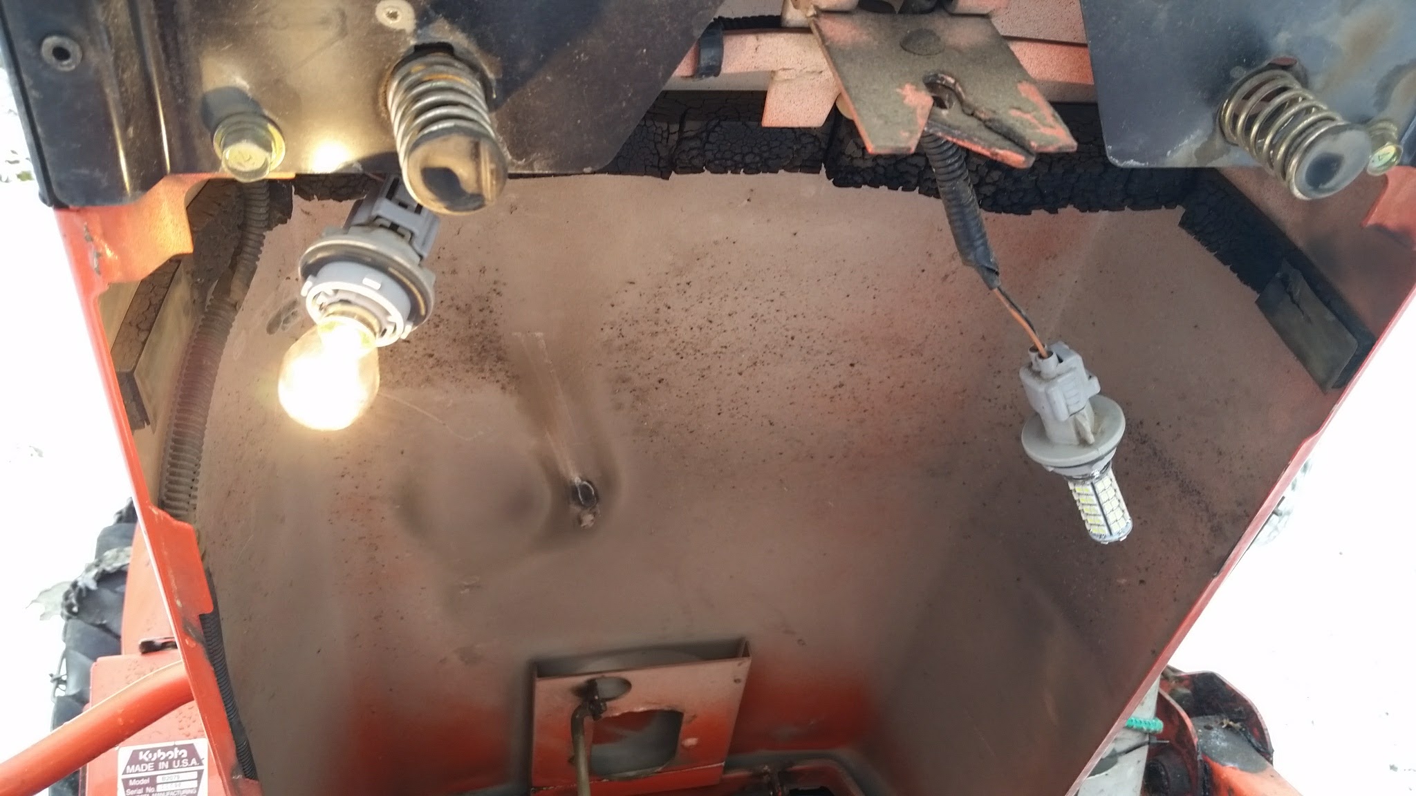

One of the 1156LL headlight bulbs died on my B2910. I ordered some 12V, LED replacements. The base of the LED is the same as the 1156LL but it doesn't work when put into the socket. I tested the LED off a 12V battery and it works. The socket works when I put a 1156LL bulb in it. Any Idea why it won't work? Thanks.

are alignment pins on led bas the same distance from the bottom? if so spin 180° and try again.

Polarity is likely reversed.

Look a little closer, there is only one contact on the base of the bulb, since the headlight only has one brightness, so polarity isn't an issue. The LED looks like the pin height is different, and the base diameter is smaller. I would put my money on chinese junk though.

Some light sockets have been know to have reversed polarity. If LED works when tested with battery as indicated in post one, it might be worth checking socket with meter.

I checked out the polarity on the LED and on the tractor. The base of the LED is (+) and the base of the Tractor socket is (-). The feed to the lights comes in to the right light and jumps to the left one. I am thinking of cutting the feed, installing connectors and swapping polarity. Is there any reason not to do that? Suggestions on what type of connector to use? Thanks

The 1156LL bulbs are not very bright and I use the tractor at night to plow and blow snow. The LED replacements are super bright and draw fewer amps. I am not thinking of changing the sockets on the tractor. I am thinking of reversing the polarity so the LEDs will work. I am surprised that the center of the tractor socket is (-), isn't it usually (+) and the frame (-)? That is how the LED is set up.

Personally I would think the base should be + and the side - so I’m surprised the tractor is wired like you mention. If you change it then any incandescent bulb in the future will work fine. The only regret may be any future led bulb that doesn’t have a circuit for dealing with reverse polarity like you are dealing with now. Personally I’d switch it, but I’m surprised you can’t maybe alter the plug or connector that’s already there (maybe there is none?).

Make the base + and the side - for each lamp. This is the standard. The LED will work and if you go back to incandescent they will also work.
Look at an old 1157 bulb (or any other dual filament bulb) typically used for running lights and turn signals. It has two +'s at the base to handle the two + circuits and the side is grounded.

I cut and swapped the wires on my B2610 when it had about 4 hours on it. Just approaching the 50 hr mark and no issues, as I expected. I couldn't for the life of me figure out why they would make the body of the socket the + and the pin -. Standard in every other wiring I have seen is always case ground, so as far as I'm concerned I just fixed a mfg flaw!

just switch your wire from the socket and you be ok i did the same

My BX has spade terminals on the socket base and you can just switch them.
If there is a connector in the harness sometimes you can get to the tab that holds the pins in and just trade the wires to change the polarity.

Thank you for the last few replies- I thought the sockets were wired backwards from what is normal. There are no spades at the socket and I haven't figured out how to unplug the harness to see if I can reverse it there. If you look at the first picture you can see the connector. Is it worth bothering to try to figure out how to disconnect it to see if I can reverse polarity there or should I just snip the feed wires and swap them there?
