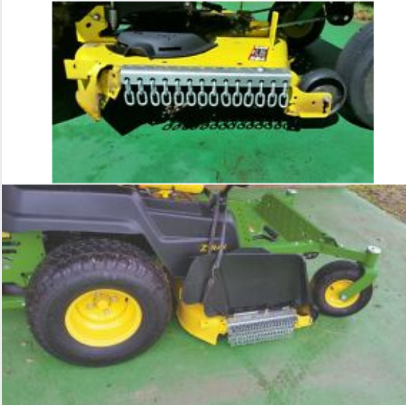

Does anyone have any experience with replacing the side discharge chute on a riding mower Deere S240) with a chain guard? While this would allow me to mow in much narrower spaces, is it safe or practical? Thanks!

A few things come to mind for me.
1- make sure the chains aren't long enough to contact the blade. Bottom picture looks possible for that to happen.
2- the purpose of the chute is to direct clippings away from the tractor in a spray fashion, to spread them out and deter windrows. The chains will encourage clogging and windrows.
3- it opens a space for shoe insertion directly into blade.
/ replace discharge chute with chain guard? #3
Most of the time the blades come awfully close to the edge of that opening! I agree with MossRpoad, that is an item that would require extreme concern on my part! My question is "Why"? I realize that the plastic chute's typically get torn off easily, are a pain to get thru a narrow gate and are almost always on the wrong side when you are mowing up close to something! As bad as they are to deal with, I still think they have merit!

Many mower decks you can lift the chute to get into tight spaces. I could live with that if I had to.

Just get the mulching cover kit....

Very first thing that came to mind as well. Blades hitting the chains.

Thanks for the help, everyone! You pretty much confirmed what I already suspected.

A simple bungee cord to keep the chute up when needed solves the problem. As others have said, the blades are way to close to the edge of the deck to be messed with.
/ replace discharge chute with chain guard? #10
I did this with both of my Hustler ZTM's until finally I said screw it and took both the discharges off totally. I get a much better dispersion than with them down or even mounted. I would mow with safety glasses or face shield because they can ricochet debris when passing trees and such. Otherwise I mow throwing away from walls and such.
/ replace discharge chute with chain guard? #11
I did the bungee cord thing on my chutes for years, then upgraded to a discharge chute cover made by Advanced Chute Systems on both of my commercial mowers. 99% of the time the chute is wide open. It has a partially closed position that knocks down clippings similar to a standard chute, and fully closed it's great for mulching leaves. Closed it does leave a windrow, so it's not a real full time mulching solution.
I had chains on my 3 point rear discharge finish mower, and they become a solid mass of grass in short order.
