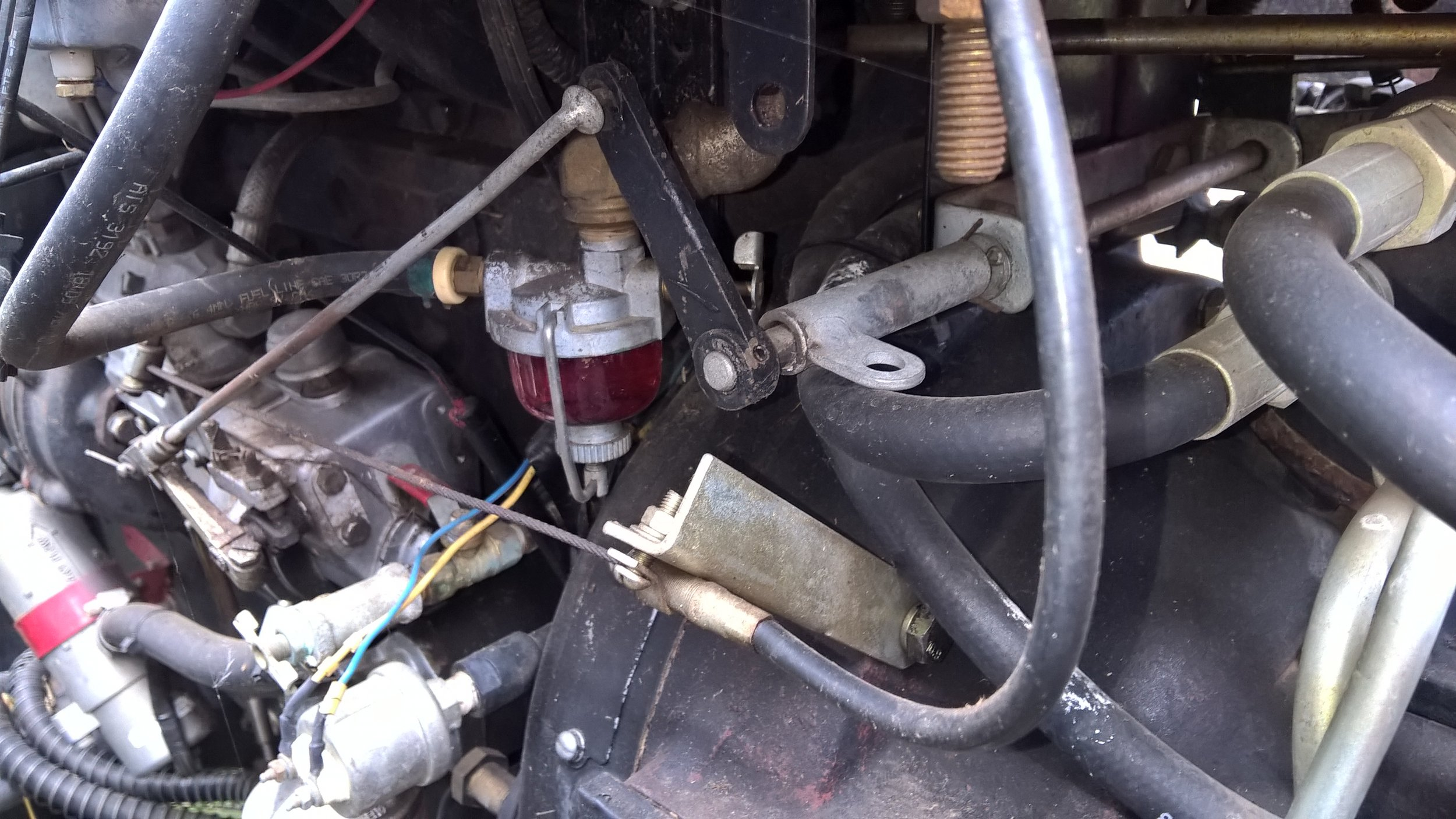

I have never had that cover off to see what was inside so I am a little confused on what is in there. Bob Rooks has WAY more knowledge than I in this area. I am having a hard time figuring out how any crud can get in there.
Is the chamber under that cover usually full of fuel? I don't know if this is normal or not.
At the very least all fuel in the injection pump should have passed through the sediment bowl, lift pump and secondary spin on filter before reaching the pump.
You do have a secondary spin of filter, don't you? When was the last time you changed it? I am not aware of a fuel filter that has a by-pass relief like some oil filters do, but that would seem just wrong. Is it possible the fuel filter is "wrong" or defective?
What you could do is shut off the fuel and thoroughly clean the sediment bowl and screen. Then remove the spin on filter and rig up something under the filter housing to catch fuel. Make sure the container is clean. Use the hand primer pump to pump fuel into that container and inspect the contents for crud. Once you know you are getting clean fuel through to that point, screw on a new filter.

I really don't understand how crud from the tank can get all the way to the rack in the IP. Bob?

Only one logical explanation for that large of infestation. The secondary filter has channeled, and is host to a live colony. As 5030 has recommended, a 2µ Racor filter will take care of it. Replace the secondary filter with this one.

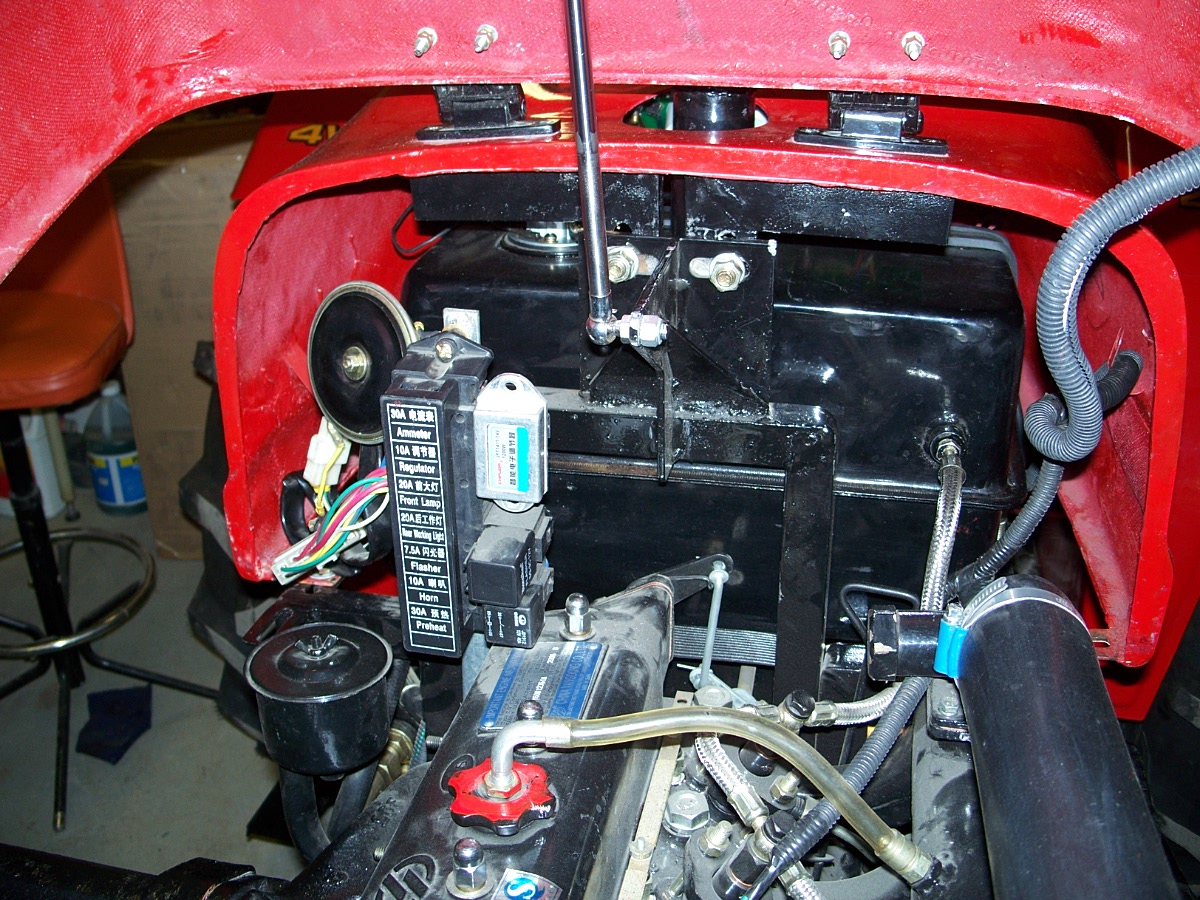

I'd like to install something with a clear housing so I could see when the filter needs changing and if I could find a set up that uses a "reusable" filter that would be great.
There are self-cleaning filters available. The CUNO filter has been around for as long as I can remember, and they are also used by the military. And they filter down to 35µ.

Failed secondary filter for sure. That is why I queried about when it was last changed. ANY suspected infestation calls for immediate replacement of all filters and flushing of the system. Treating a dirty system is just a waste of treatment.
If I didn't want to replace the whole filter/adapter assembly, at a minimum I would buy three new filters. One to swap out immediately, one to swap out after a couple of tank fulls of fuel and one to have as a spare. When the nearest parts house is an hour's drive and they are closed at night and on Sunday, it makes sense to have a lot of spares around, especially mission critical ones.

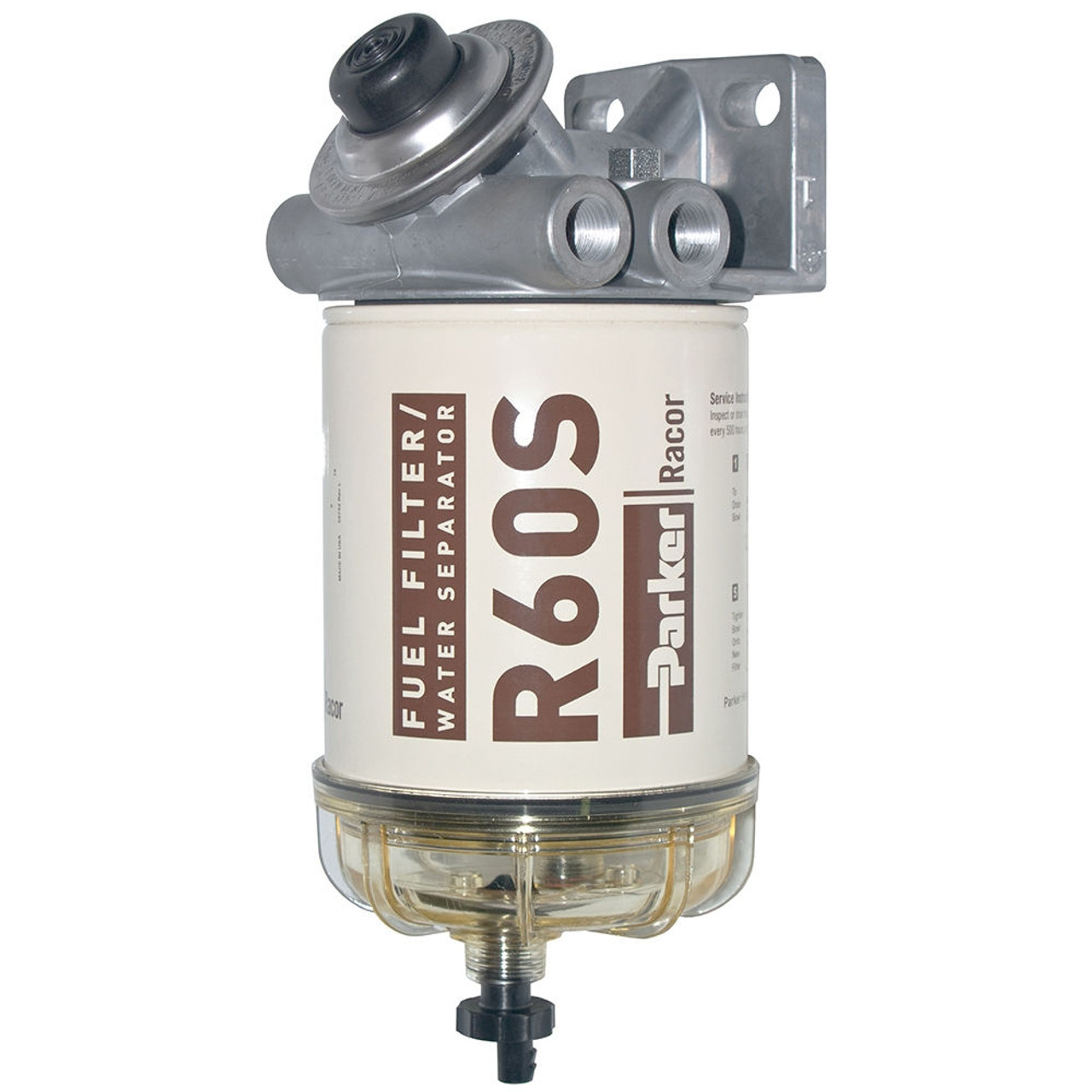

I wonder if Racor makes a spin on that will fit the OEM adapter? I'll have to look into that when I have a chance.
I do like the visual check of the clear bowl. I have that kind of setup on my bulk gas tank. In 15 years it has only collected a little bit of dust in the bottom and never any water. Thousands of gallons of gas, but I can monitor the filter condition easily.

On my Nortrac 254 the previous owner put an inline filter between the sediment bowl and the spin on filter. It is one of the inexpensive clear plastic ones. I replace it once a year with a Wix replacement. I know it works be cause I have had problems with the tractor losing power and seeing low fuel flow in the filter. Replacing it fixes it. I also replaced the sediment bowl assembly with a glass bowl. I don’t recall where I got it. I also have a rusty tank but it seems the extra filter helps, or at least gives me a peace of mind.

Well, I have the Conus base with a Racor 30 micron water block spin on filter not only on both my tractors but my diesel pickup truck as well.

I think you are just fighting yourself now. My suggestion was to replace the entire OEM secondary filter assembly with the Racor unit, should bolt up perfectly. You could use a throw-away inline filter as your primary filter. Or just keep your sediment bowl with the screen in it.

I can answer that for you and you don't have to inquire.... NO, they don't and never have. You must either use their base or a Chinese copy (I used the Conus) because the threaded boss that mounts the filter is unique to the filter threads. Just quit being cheap and buy a base (the Conus is 27 bucks) and be done with it and leave your primary filter (changed of course) on the mount. You'll never change it again and you'll never empty the sediment bowl either.

Like I said, I used the less expensive Conus (Amazon) base versus the Racor (27 bucks versus 50). Bought 2 (one for each M9) and got free shipping too.
