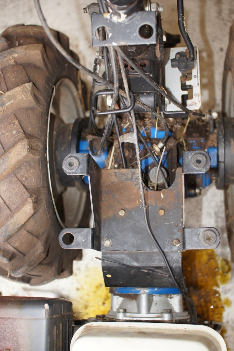

After I got it unloaded I took the air cleaner off and disconnected the oil shutdown wiring. Man does this thing have compression (I am pretty sure the compression release is not working properly)! I checked the oil level and it was full to the point of just overflowing out of the fill hole with the engine level. I put a little starting fluid in the carburetor and it fired up after about 5 pulls. The seller showed me that he had stripped the valve cover retaining bolt and sure enough it was spattering out a fair amount of oil from the valve cover. After running it for 5 minutes I shut it down and wasn't able to get it started again.

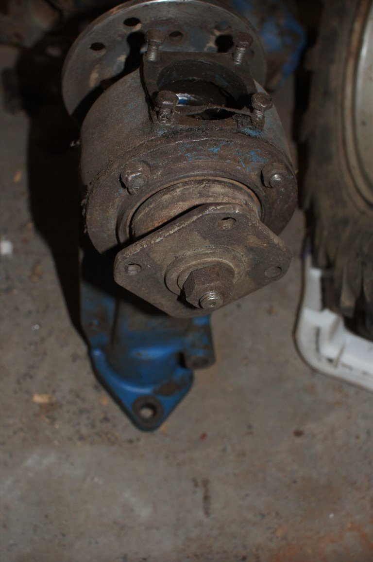

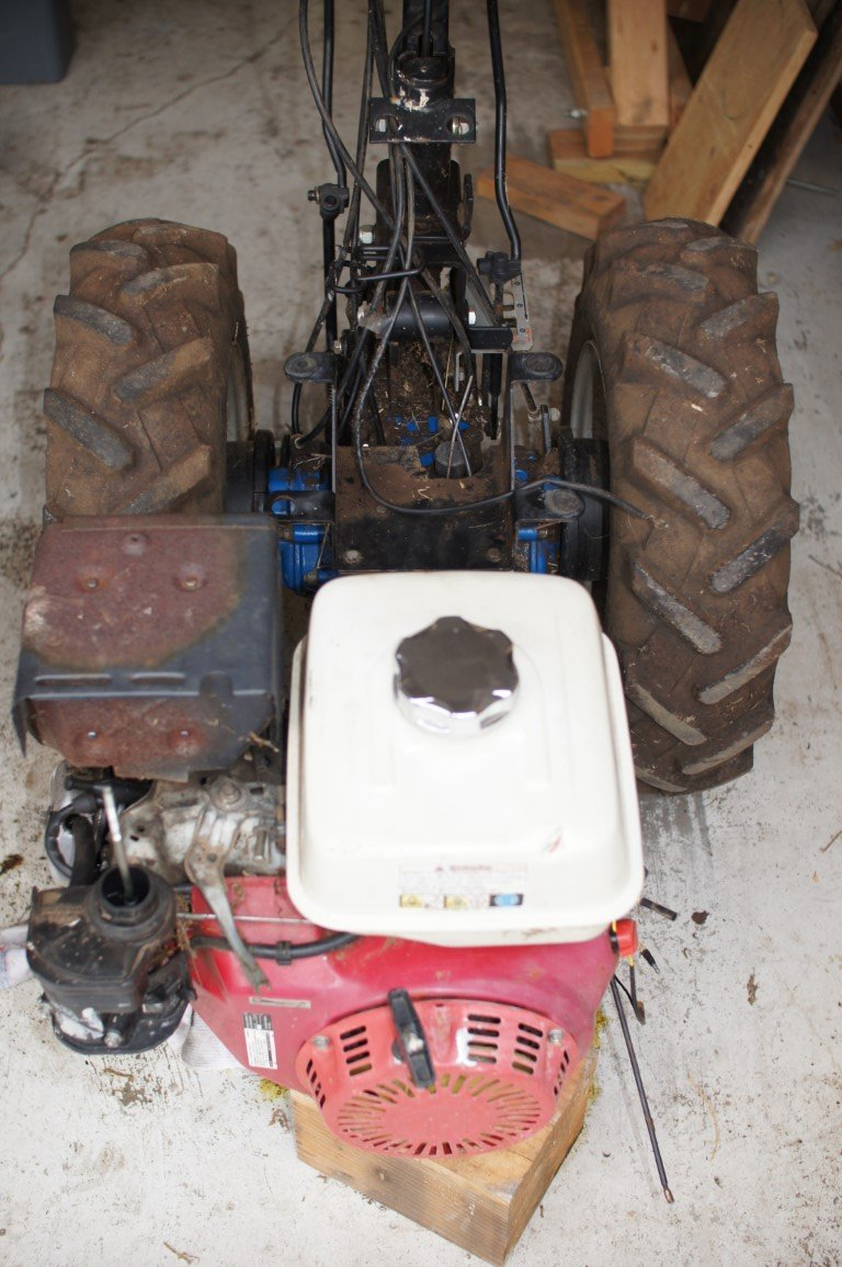

I started pulling the GX-390 off of the transmission. The lower right engine bolt is completely rounded off and I wasn't able to get it to budge. So I started dismounting the engine adapter instead of the engine. There we 3 nuts on 3 adapter studs. 2 of them were very loose and the third one is under the metal piece that retains the plastic handle bar shaft cover. That is as far as I got.
The dead-mans switch lever is broken. There was no wiring or cables going to the engine. The cable for the throttle is missing the little knob that goes into the throttle lever. The dead-mans switch was not wired to the engine. The clutch feels like it might be stuck but I am not 100% sure.
I am guessing that the GX390 has a compression relief that isn't working. I bought a Predator 459cc engine to replace the GX-390. I haven't opened the Predator engine box yet so I can still return it. I think I am going to spend a fair amount to bring this tiller back to factory functionality. New throttle, clutch and brake cables. New dead man switch paddle. And a few other odds and ends.

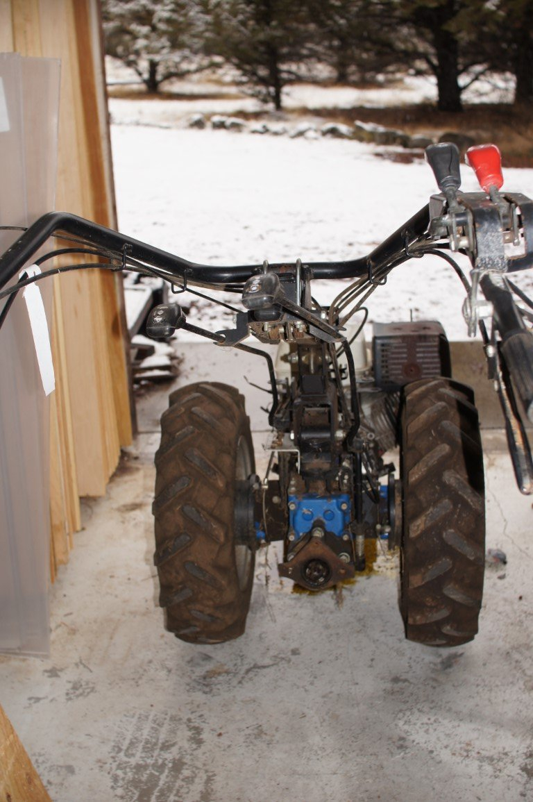

The (new) BCS 948:

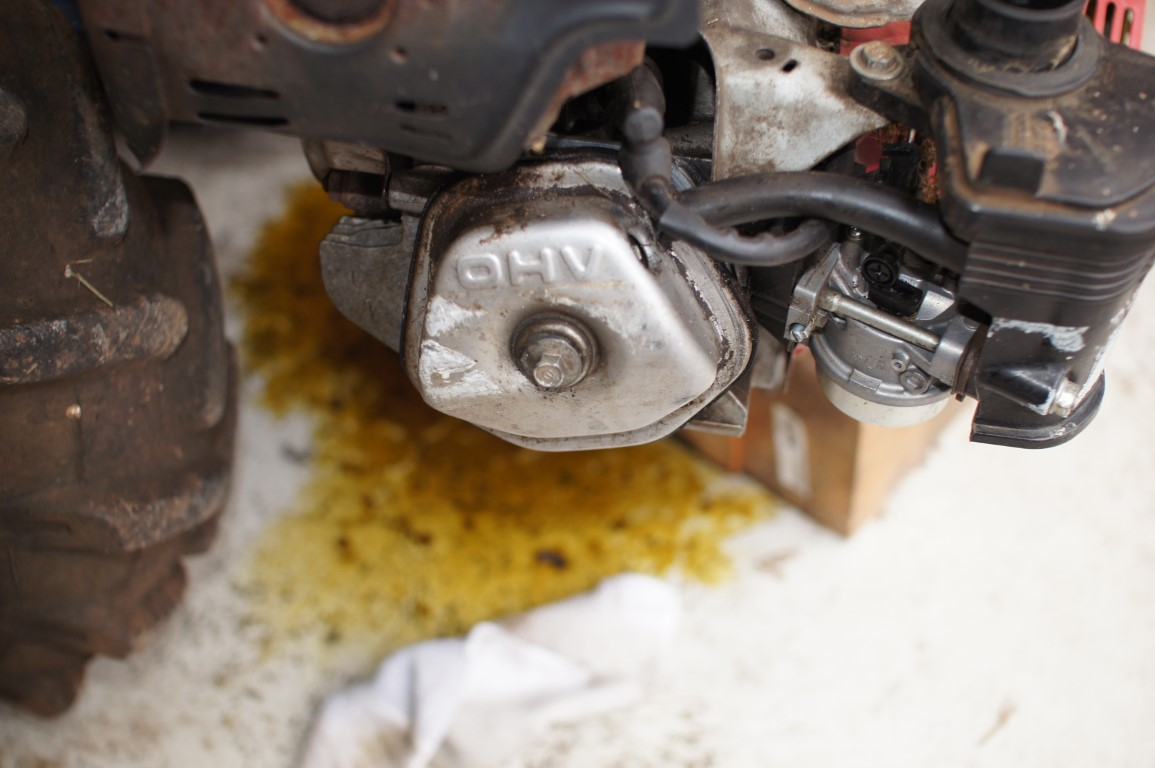

I ran the GX390 one time for about 5 minutes. Here is the puddle it left:

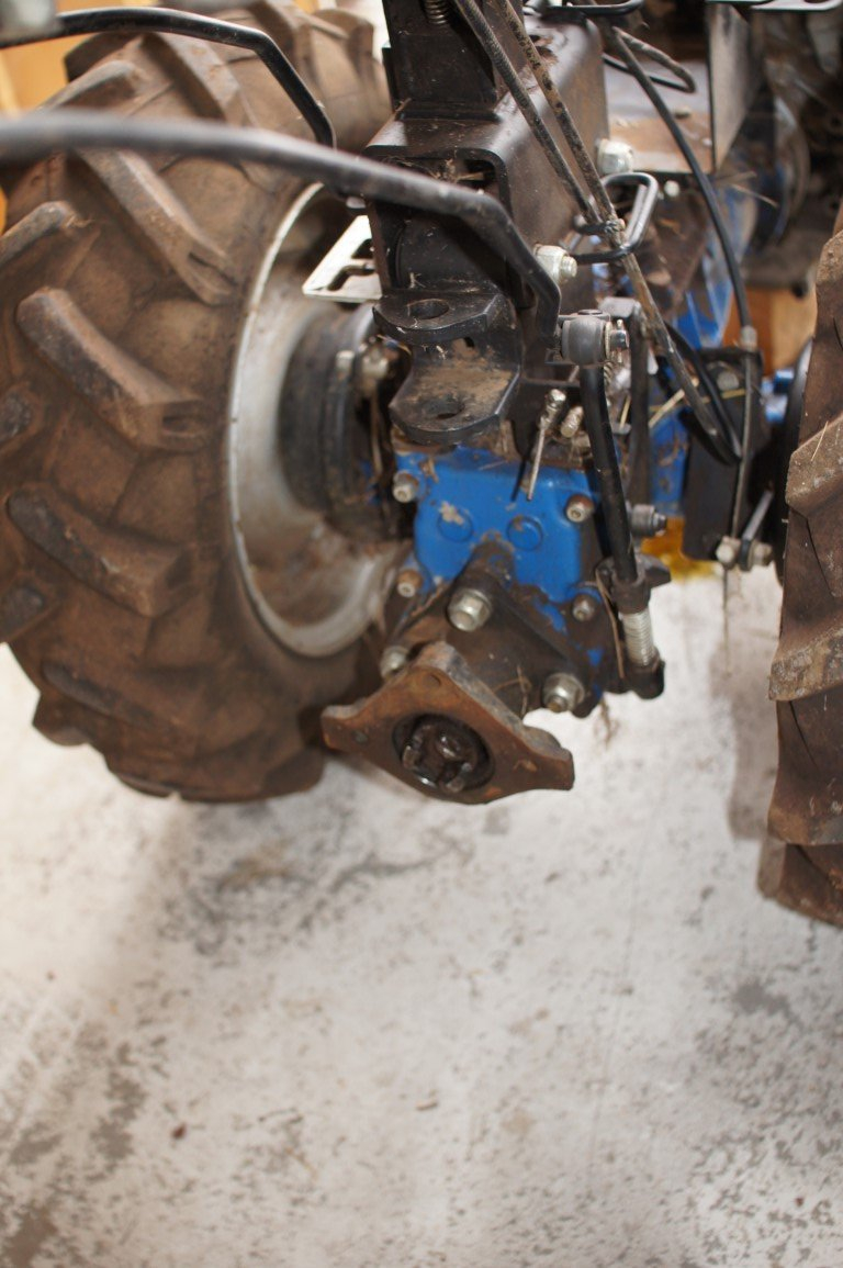

Below is the leaking valve cover. I think the previous owner also messed with the valves and disabled the compression release which is why it is such a bear to turn over. The threads in the block for the valve cover retaining bolt are stripped so the valve cover can no longer be tightened. For $500 I can put a new more powerful engine on this 948 which I think will be worth it.
Top view:

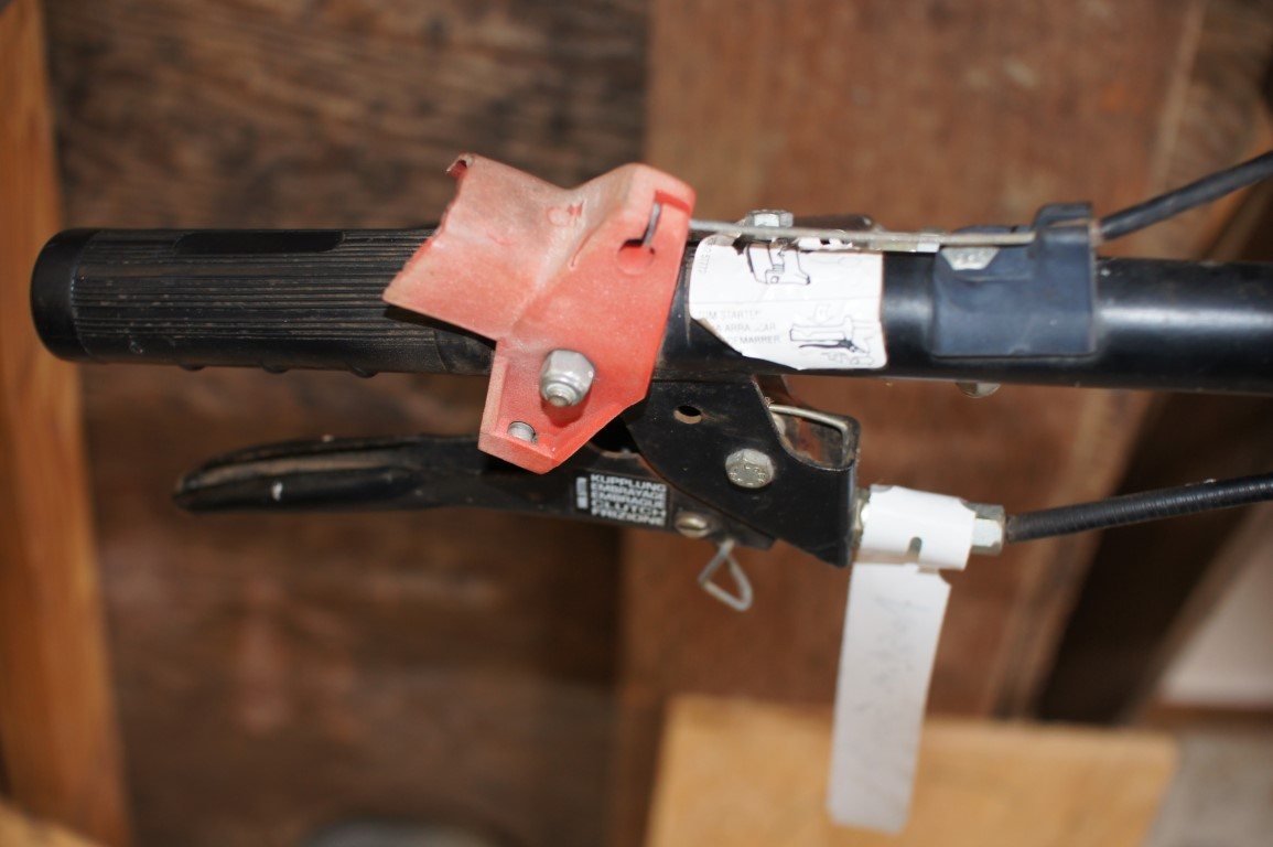

The broken dead mans switch/paddle:

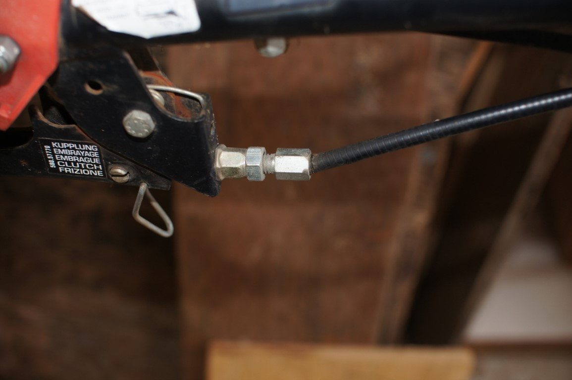

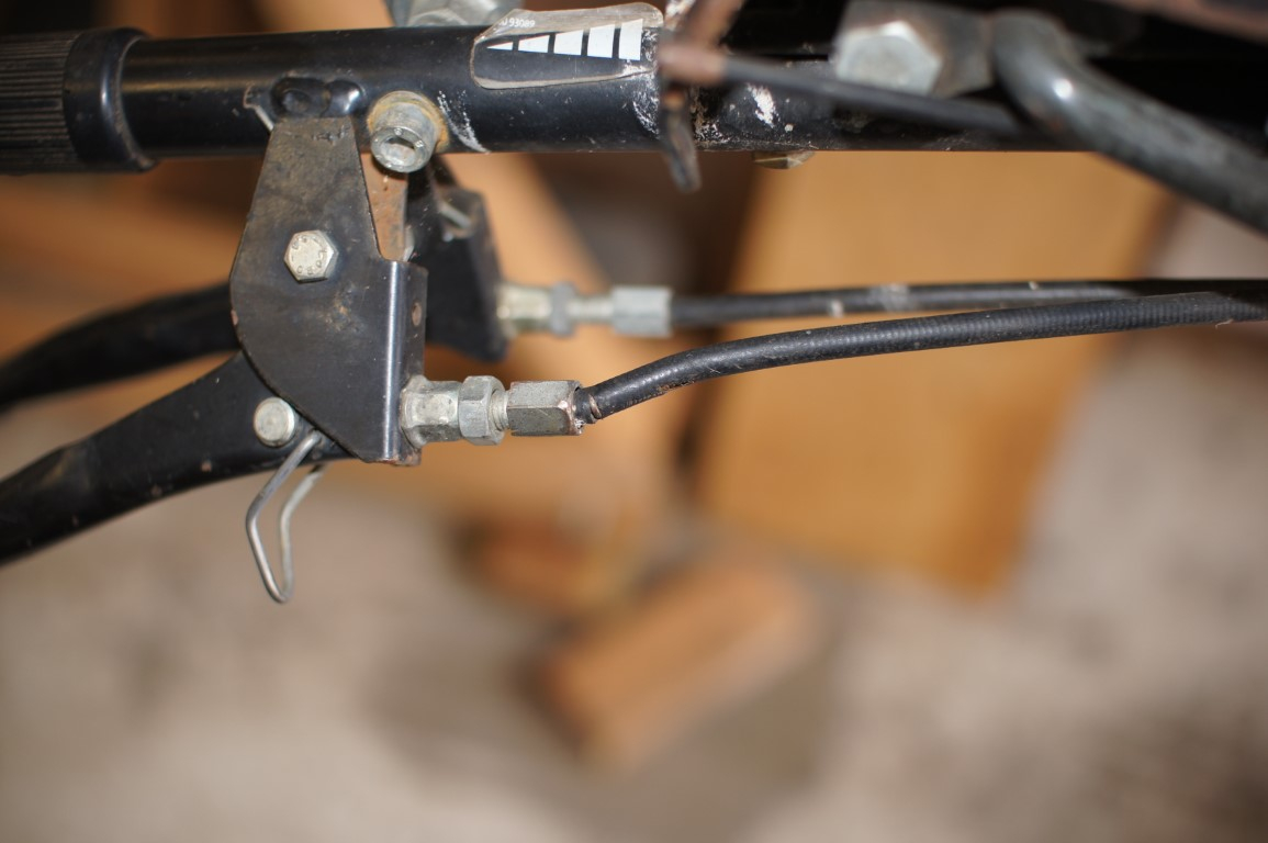

The clutch control cable looks a little questionable. I will have to see how much a new one is to decide to replace it or not:

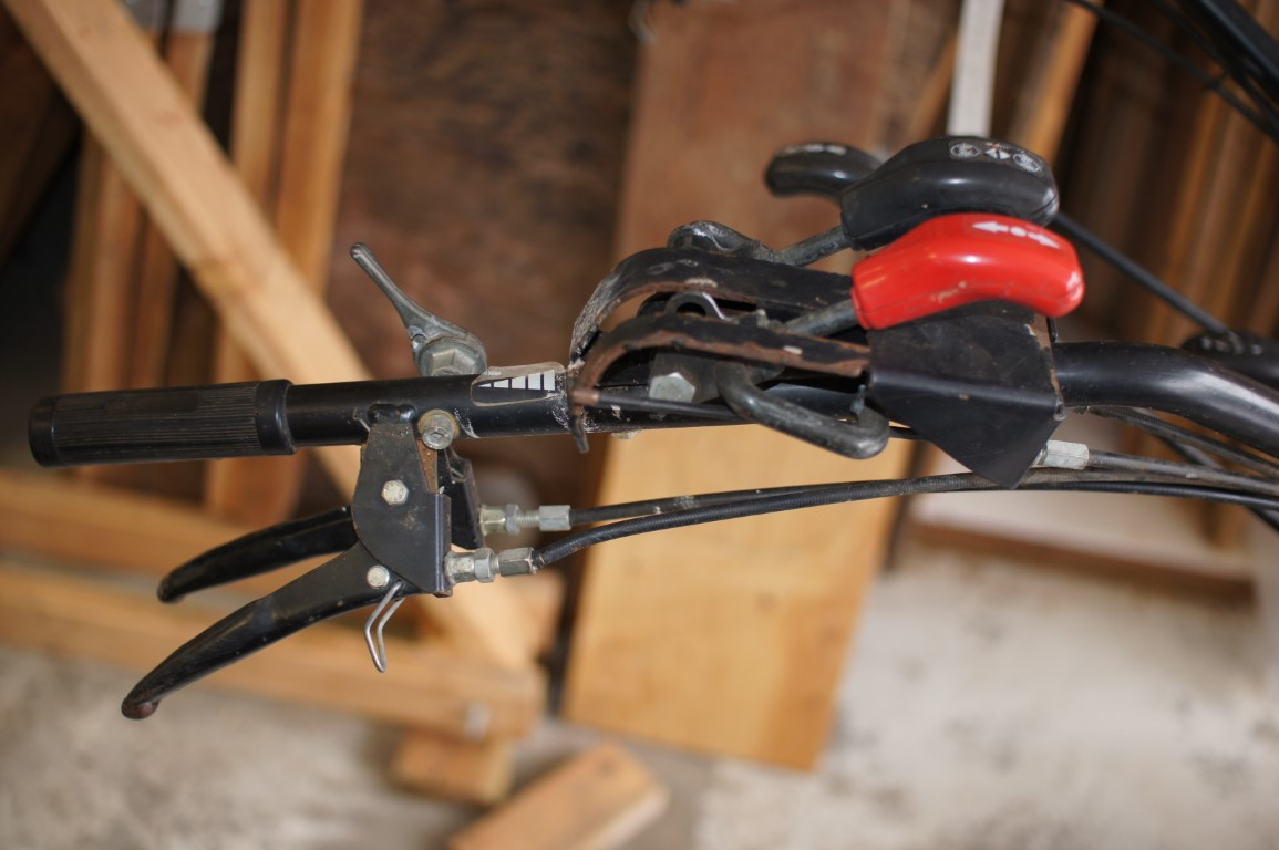

The cables on the other (right) handle. One for brake and one for releasing the steering column so it can be repositioned. I think the outside one is the brake which looks like it should be replaced. Again I will have to see how much a new one costs.
The rest of the right hand handle:
A shot from the back:

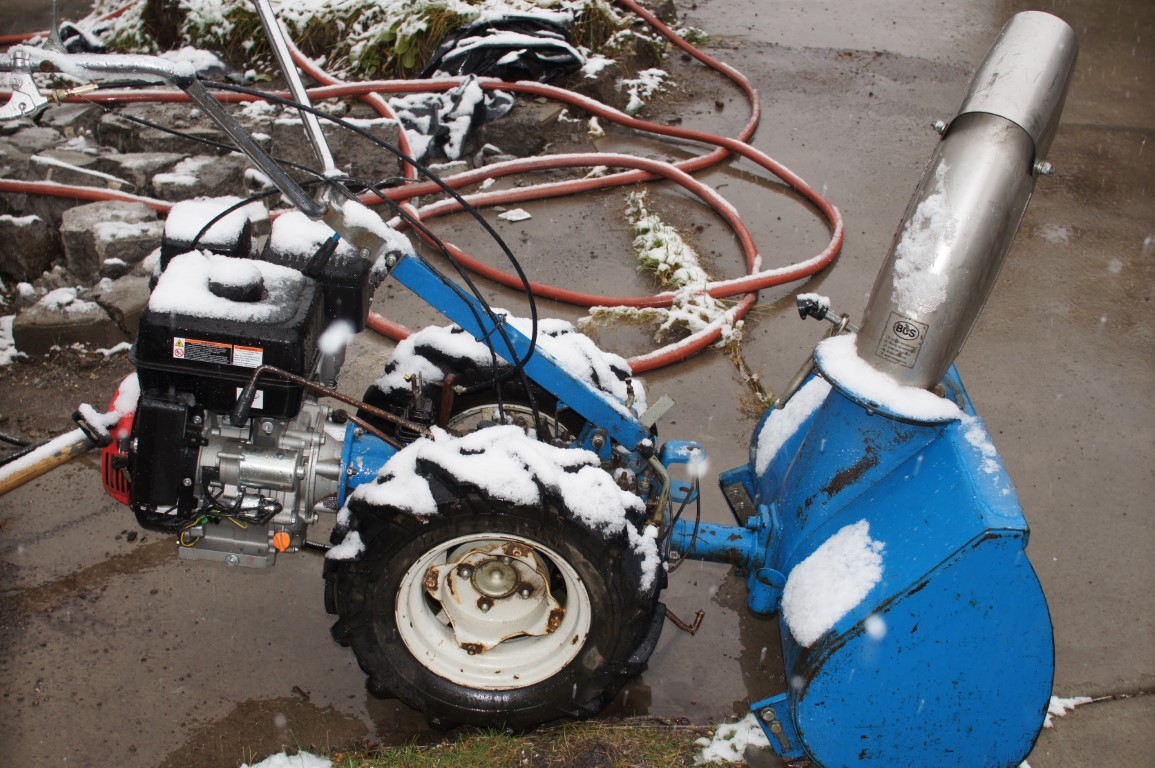

********************************** 735 ******************************************
Here is my first BCS, a Mainland 735 just in time for the first snow of the season today. I think it dates back to the 70's:
The original motor was an Acme 10hp. About 25 years ago I bought the engine swap kit and put a GX390 on it. A couple years ago the GX390 lost compression so I put a Predator 420 on it. Those extra CC's made a huge difference in how it handles the snow blower. The Predator 420 doesn't bog down like the GX390 did.
It is wearing the handles from a 715 which do not have a differential release lever or brake levers. Having the differential locked when blowing snow is a MAJOR disadvantage. This is the proper 735 handles:

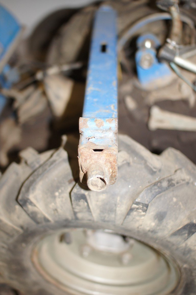

This is the control shaft from the 735. The internal rod and cone shaped piece rusted through. This is the control column:
I have welded it back together a couple times. I think it is time to make a whole new column with a new disconnect rod and new cone shaped piece.

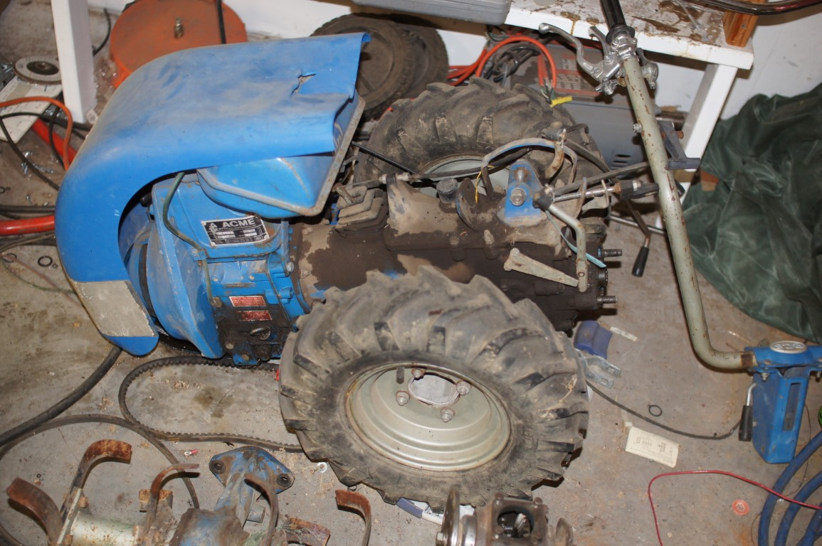

Here is the old 715 parts tractor still wearing its ACME 8hp engine. The ACME does run but has low power. A few years ago I scored a engine swap kit on ebay for a couple hundred dollars because I figured I could use it some day. I might put a new engine on this 715 and sell it.

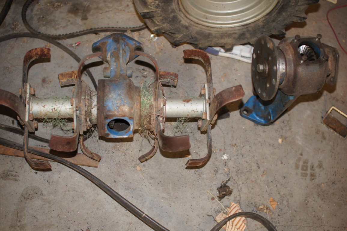

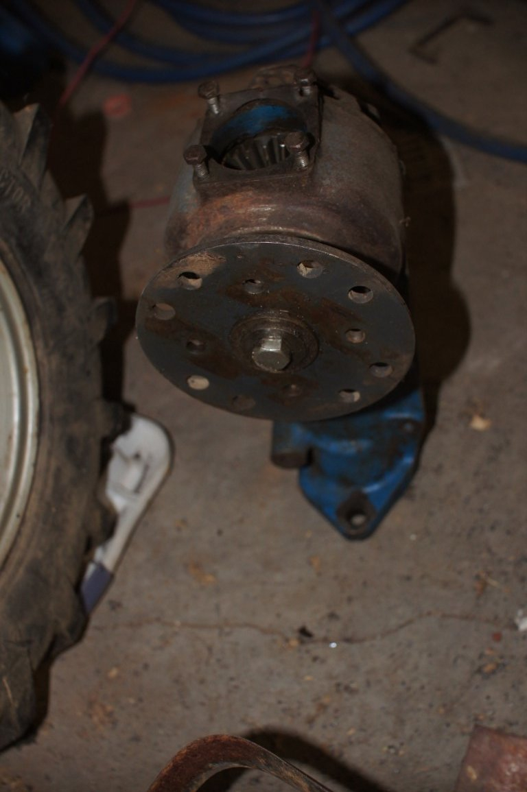

This is the tiller gear box from the 735:
There should be a similar stud on the other side of the gearbox but it snapped off several years ago. So I put the gear shaft in the lathe and drilled out the stud (not really a stud because it is cast as a single piece) so I could rep0lace it with a bolt:

You can put a heli-coul in valve cover bolt hole to fix that issue. Would be worthwhile to see if you can get the Honda working. If you had already budgeted for the other motor, put on the shelf if you get Honda running. Money in the bank down the road if it goes belly up on you. Who knows, another project may drop in your lap for the Predator motor. Great find and a beast of a 2 wheel tractor! Played with a lot of Gravelys and work on a couple BCS's with BS.
   / Replacement engine for BCS 948 tractor/tiller.
#14
Good advice. I had a heli-coil in the back of my mind. I have never done one before. I am a little worried about the compression release not working. I "think" that this might be fixed by adjusting the valves? I think it was over 40 years ago that my father showed my how to adjust the valves on out 63 Falcon but have never done it myself.

I just spent a couple hundred on cables and a dead man handle bar lever. They should be her next week.
All new cables should go a long way to getting her back in good shape. New motor and new cables should make is close to a new tiller.

3 of the studs were broken off of the engine adapter so there were only 3 left to hold the engine to the rest of the tractor. I drilled the broken studs out as carefully as I could but inevitably buggered some of the threads in the adapter plate. My local Napa fixed me up with some helicoils (or their version of them) and the proper metric replacement studs. That one guy on the end counter always goes out of his way to help me and was happy to dig through the parts shelves to find the right studs.
It took me a fair bit of Kroil and persuasion to get the screw out of the center of the clutch that holds it on to the GX390 motor shaft. To my horror I found that the shaft on the GX390 had a taper on it! I didn't know they made such a beast. Luckily I had a spare clutch for the straight shaft 459cc. I got it all put back together only to discover that I put the clutch too far onto motor shaft and the clutch lever was no where close to touching the clutch.
