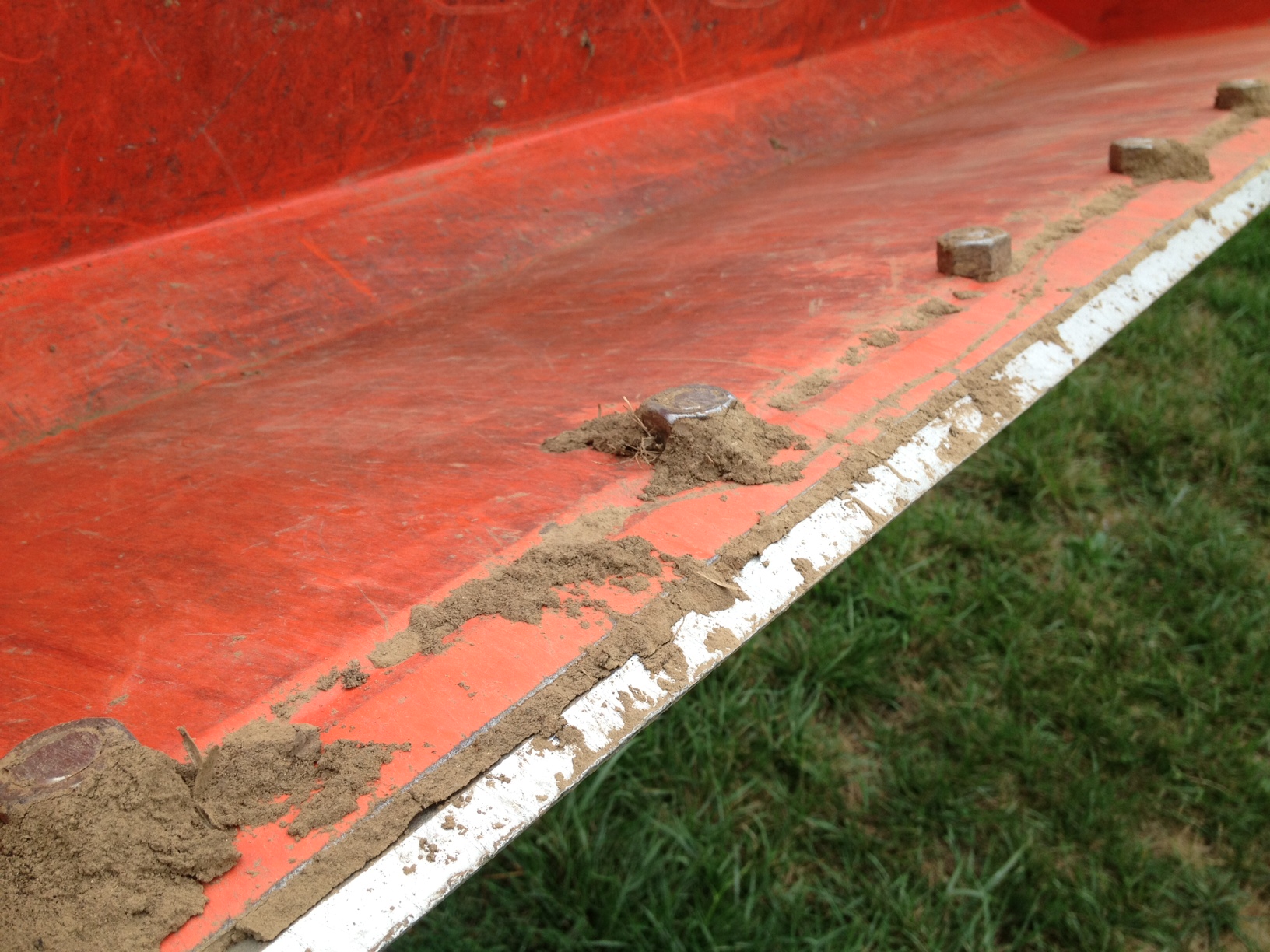

After seeing wear starting on the first Kubota in the first year of use, I made a bolt-on wear edge. That saved the factory edge from further damage for the next 9 years and was still OK when that tractor was replaced. This time I made the wear edge before beating up the factory edge. Here are a couple shots of it.
I don't see anything ugly about that one and it looks to stiffen up the bucket edge a lot. Of course if you wear away the original edge a bunch, it could look a lot different. I always prefer function over pretty if I have to choose just one.
Nice looking job was the factory edge drilled for the plow bolts or did you have to cut them
