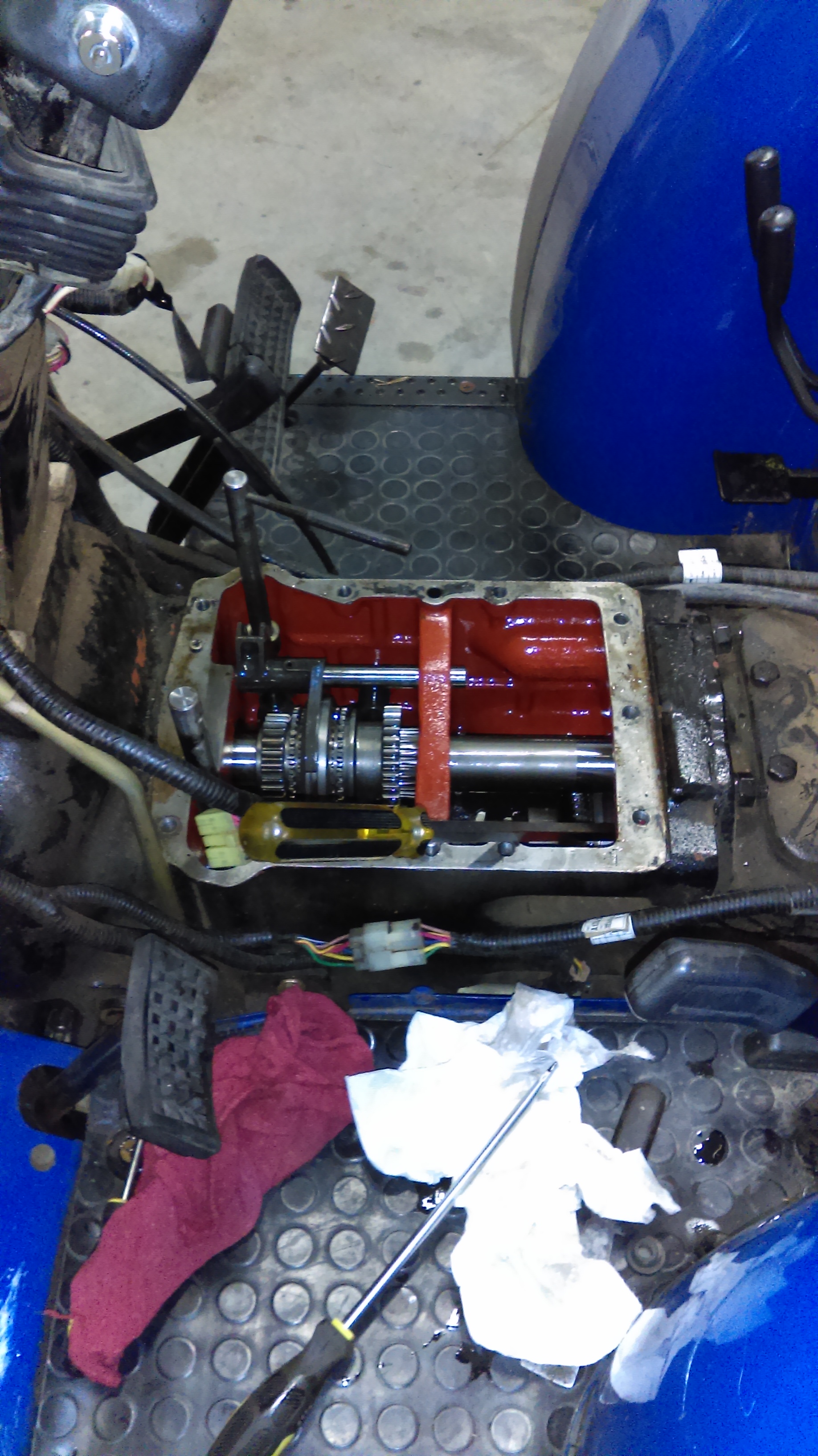

Thanks for all your help so far. I was not going to do this until I stumbled across you post with the pictures. Neither shifter is broken but the f/r is frozen in position. I have not ordered any parts yet, wanna wait until I get it apart and see whats up. I'll try to get some better pictures of that nut that backed off. Good luck with your cabin, I envy you that. I've been trying to get one going in North Carolina for years.

if your F-R shifter is stuck....its probably the cast iron ball at the end of your shiftier has popped out of its shiftier socket. the shiftier rod can rotate by hand as you move the lower shiftier rod with a screwdriver. it may find the pocket again.....look strait down the rod that connects to your hand shiftier and spin it....(oil has to be removed) to see the ball. In the proper position the ball should be aiming at the transmission wall seated fully in the lower shift rod pocket.
if you found a large nut...inside loose....this is alarming to me can you take a photo of it.....this maybe off the end of a shaft inside....this would leave your gears lose to slide around on the shaft and also bind up your shiftier..
   / Replacing the forward reverse shuttle in a montana 3040 and clutch #10
Excellent info ThankYou. The big nut is on the bottom center shaft and was completely loose when I took the cover off.It was not bouncing around, it has a shaft through the center of it.Ill get some pics tomorrow. If you blow this pic up, it's the piece of metal angled toward the rear of the tractor on the bottom with a shaft going through it.The screwdriver is covering most of it.
