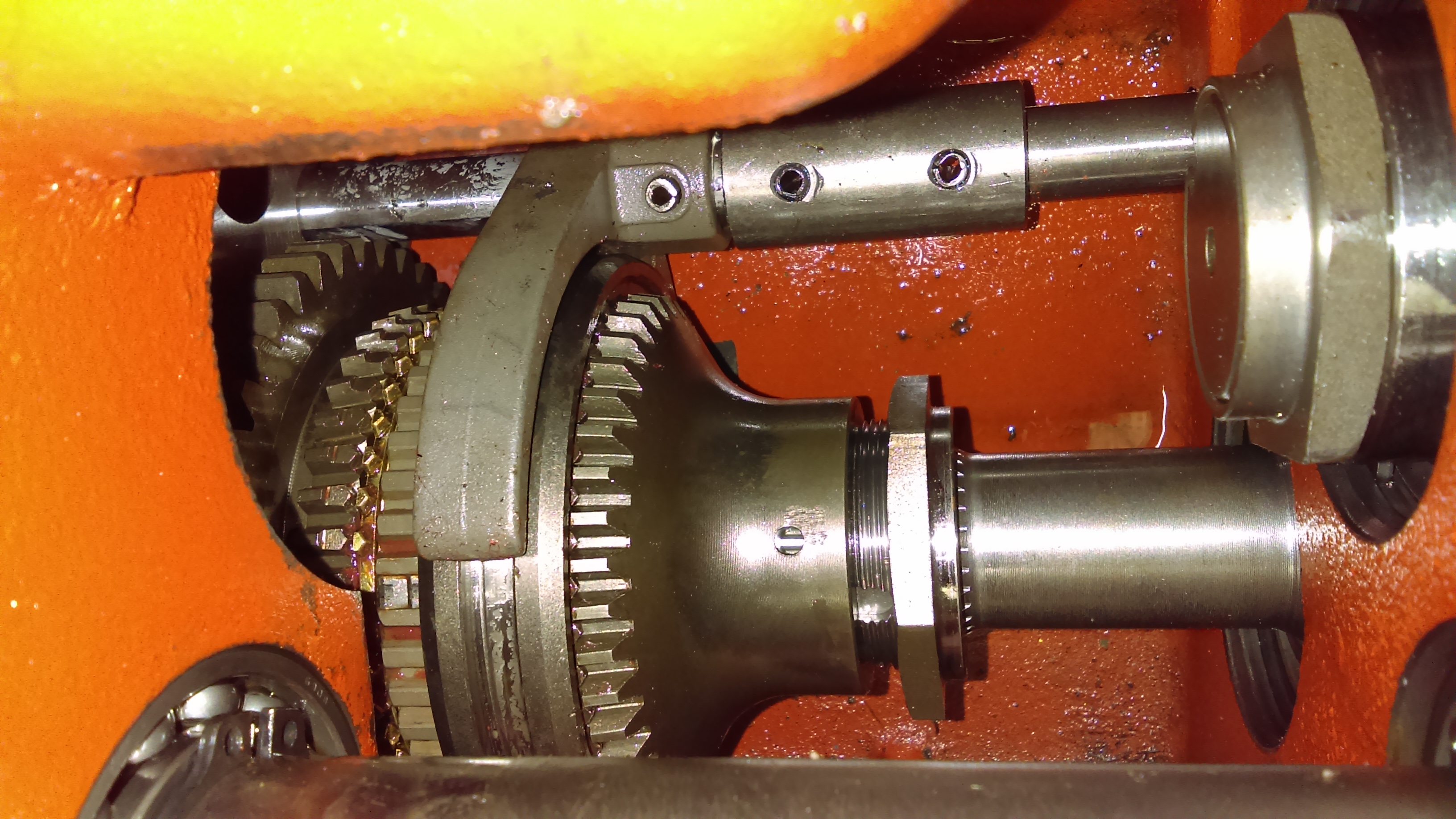

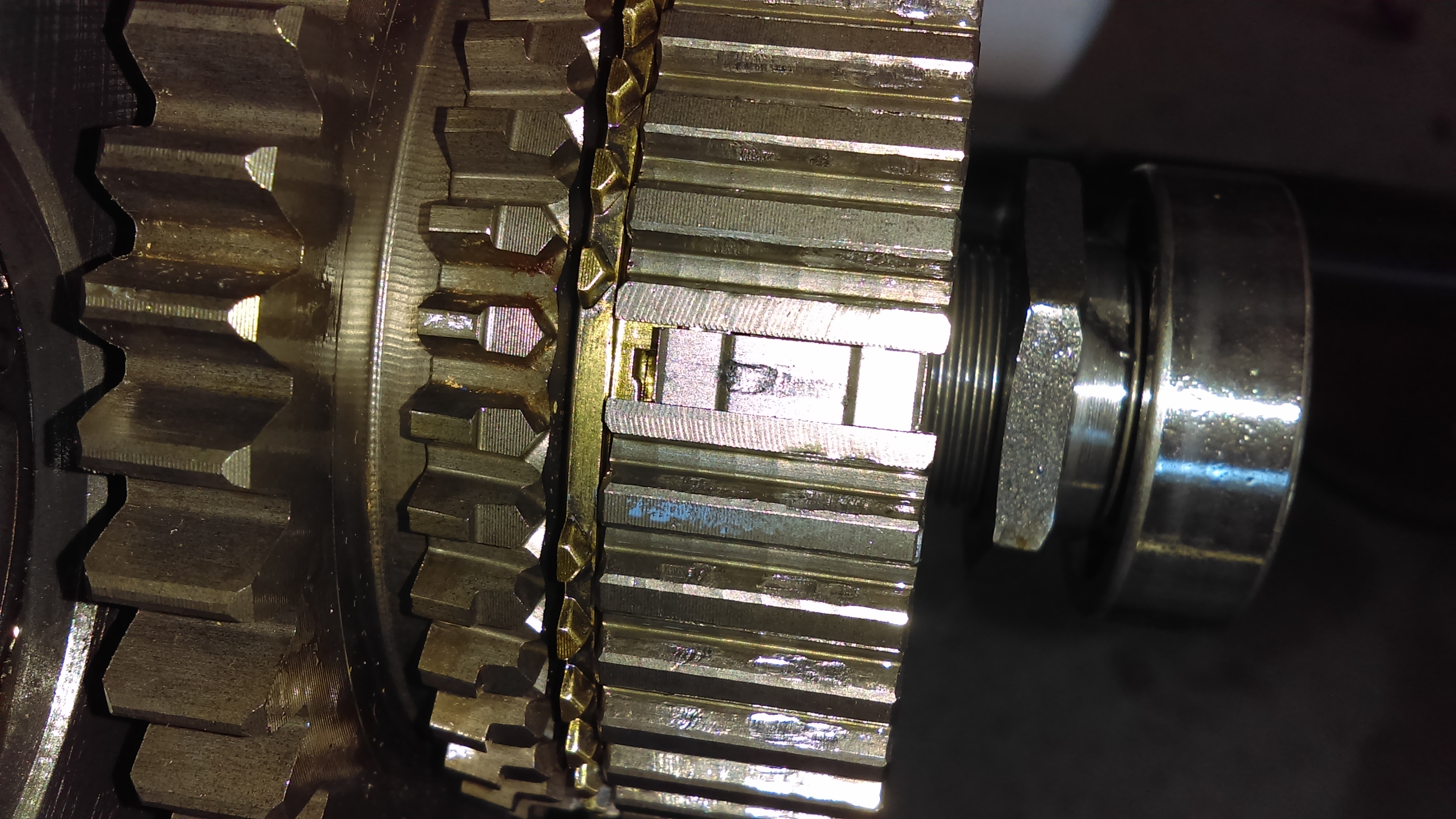

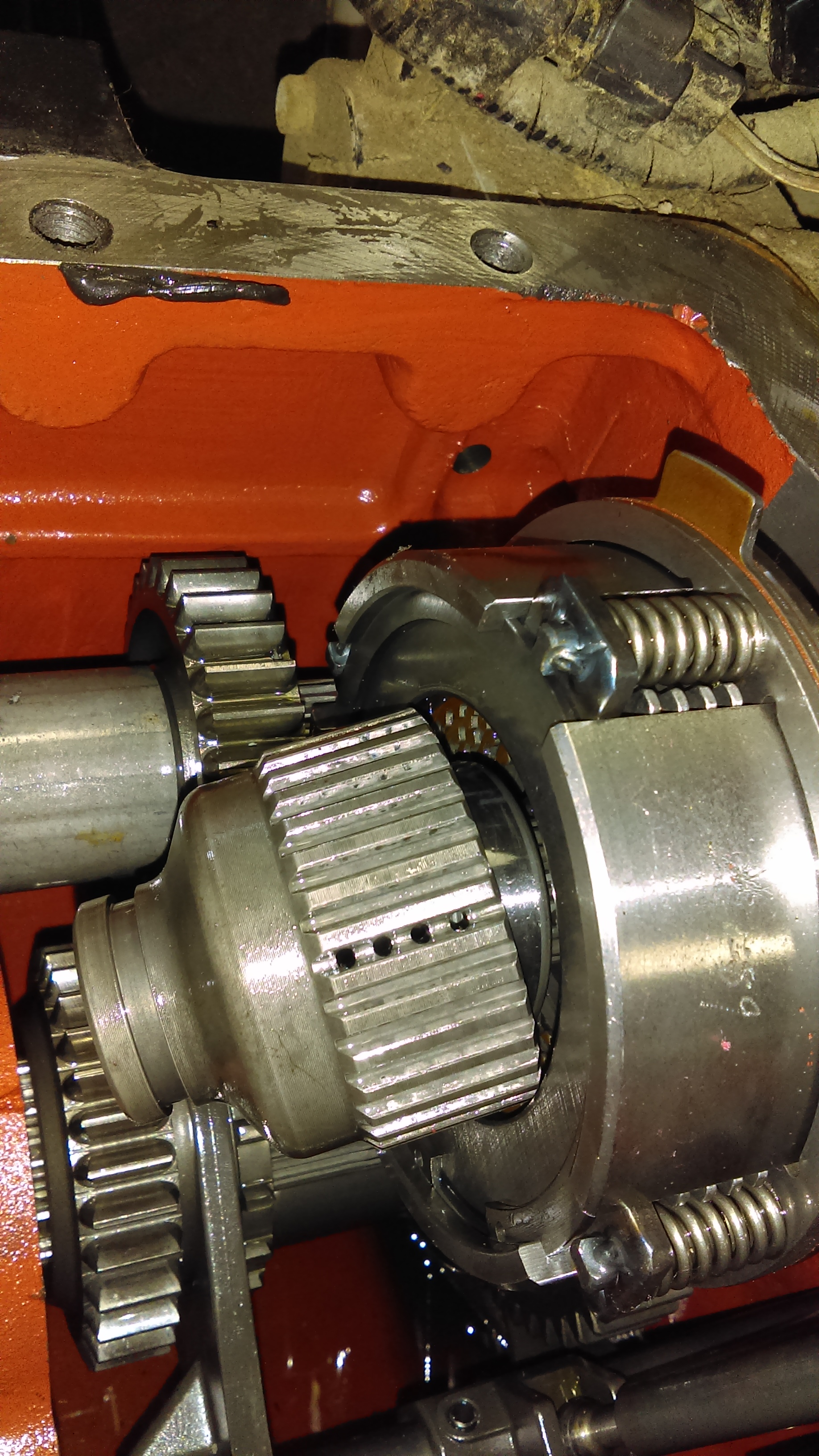

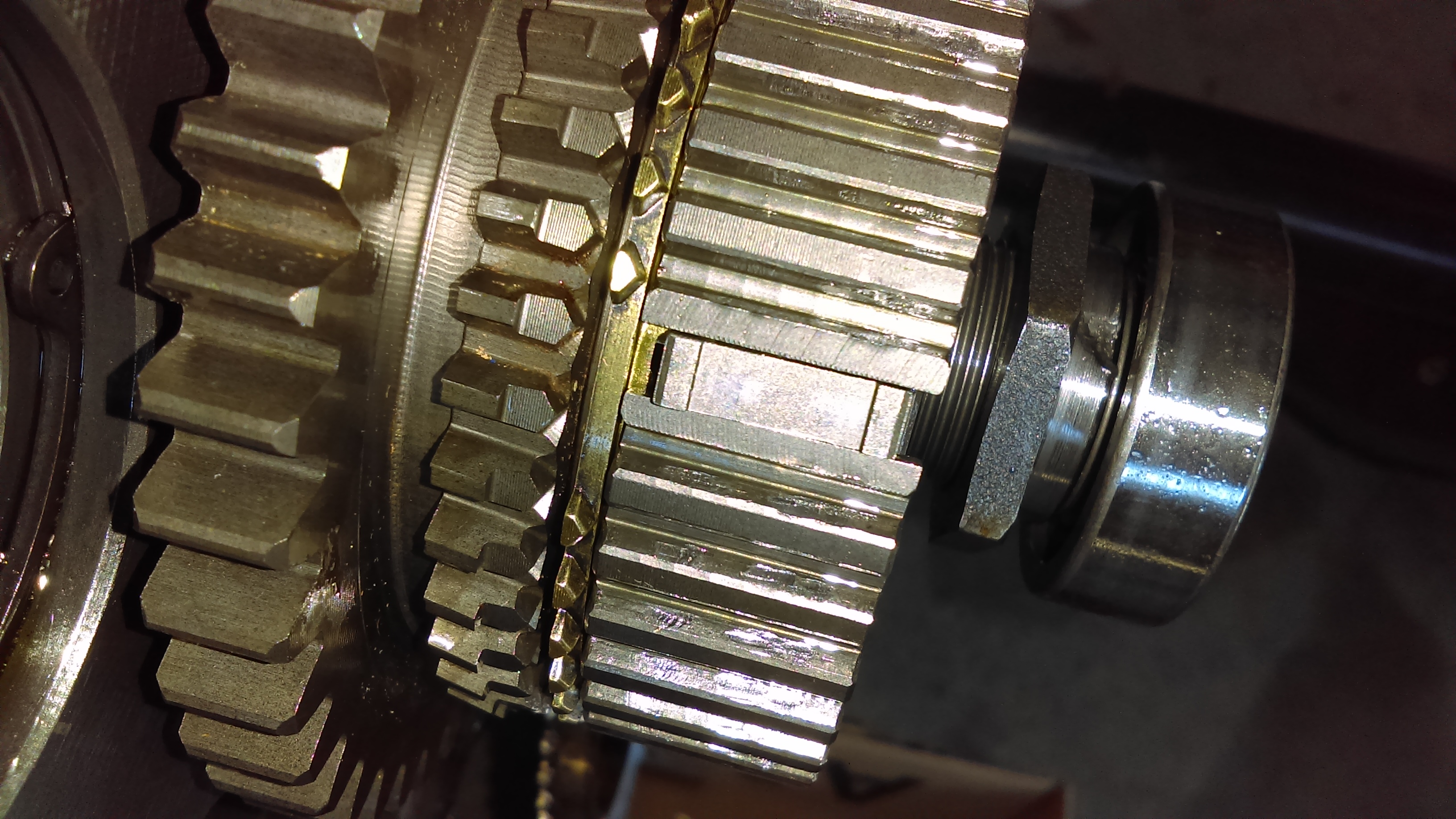

You might be able to compare my tractor job and the photos of the end of the shaft to the forward gear placement. just roll your nut up within ( a 1/8th inch) to load the trannys together..im sure it'll be fine. But before you roll shafts or shift gears this nut needs to be snugged tight then backed off...then re tightened to minimal tightness. 10-20 inch lbs. "DONT side load that spud bearing very much".
damit....its hard to see those shadow lines without magnifying glass on that nut. (still in a quandary how it stripped?) did you test the shaft movement forward and reverse in the rear axle
i don't think those shafts should move much ...the nut is supposed to drive the forward gear back just far enough to seat the roller bearing in its cup. They made this adjustable for the differences in gasket goo. its merely thousands of movement.
good job so far.....just move slow. I always move slow......simply because i was born in the 50s.LOL

12472497_1354571997889507_1783582702018566172_n.jpg nut setting.jpg hit the plus setting for instructions..in white type.

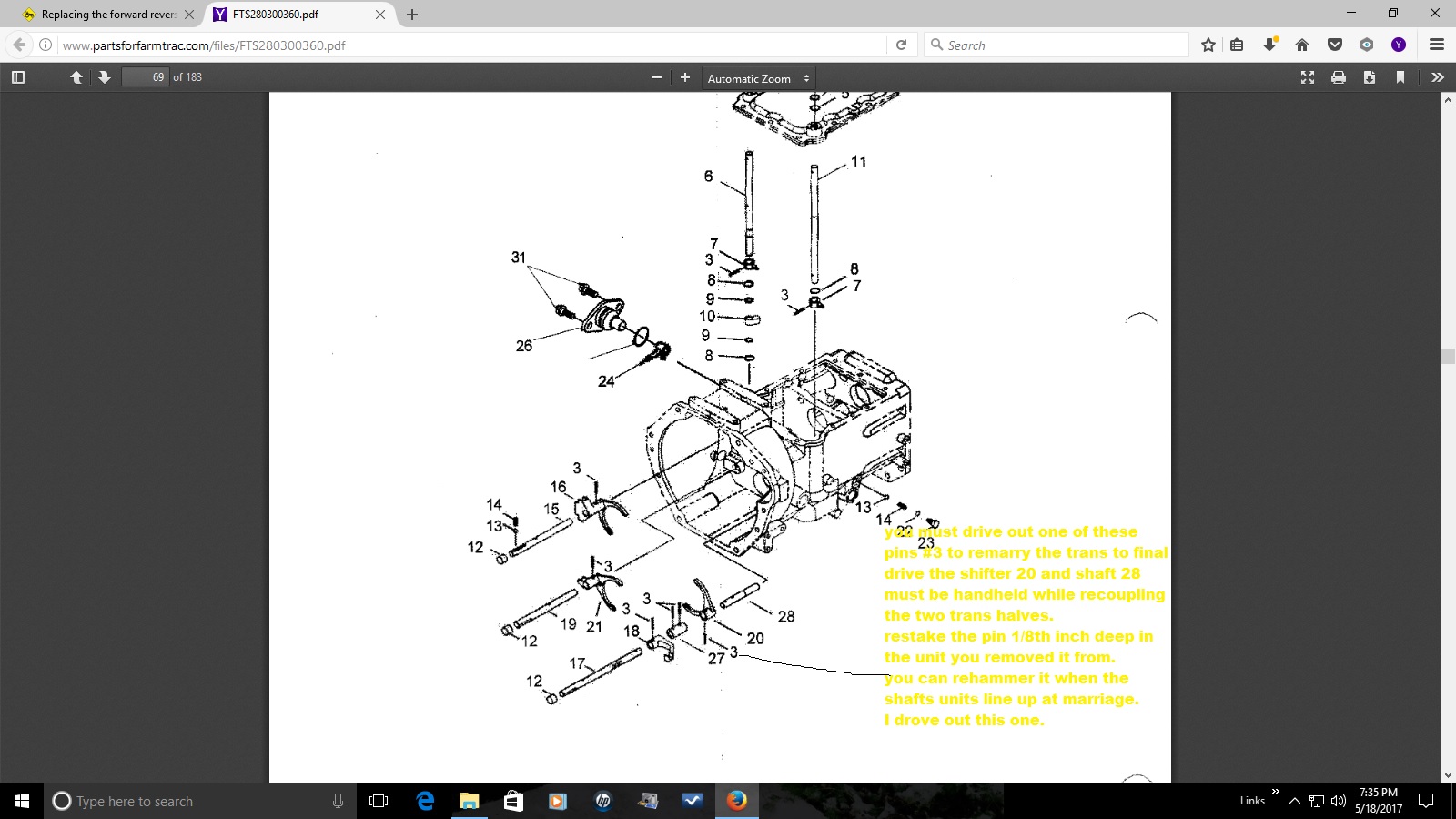

   / Replacing the forward reverse shuttle in a montana 3040 and clutch #44

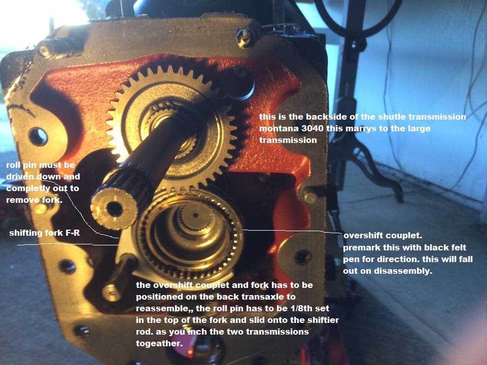

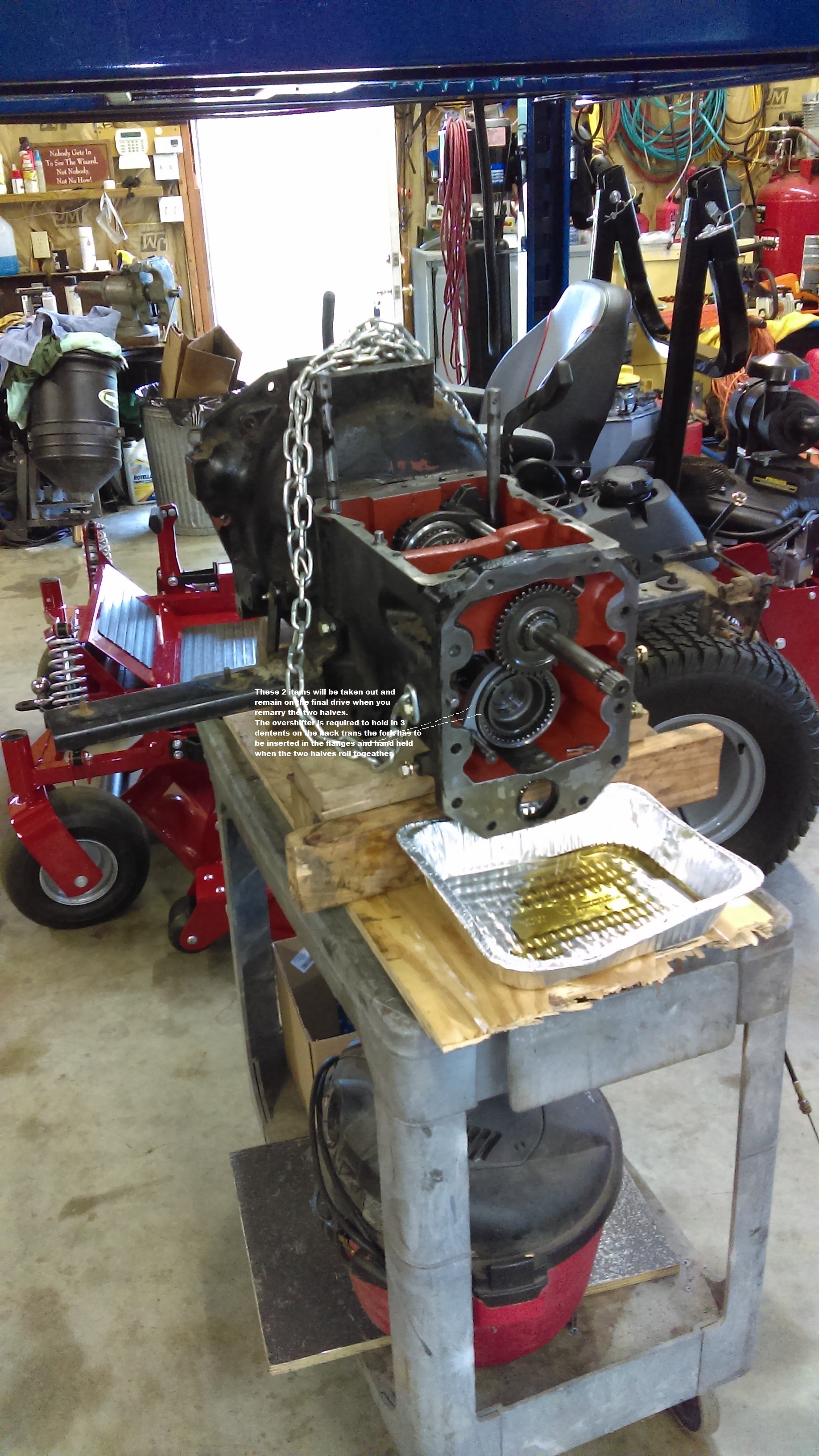

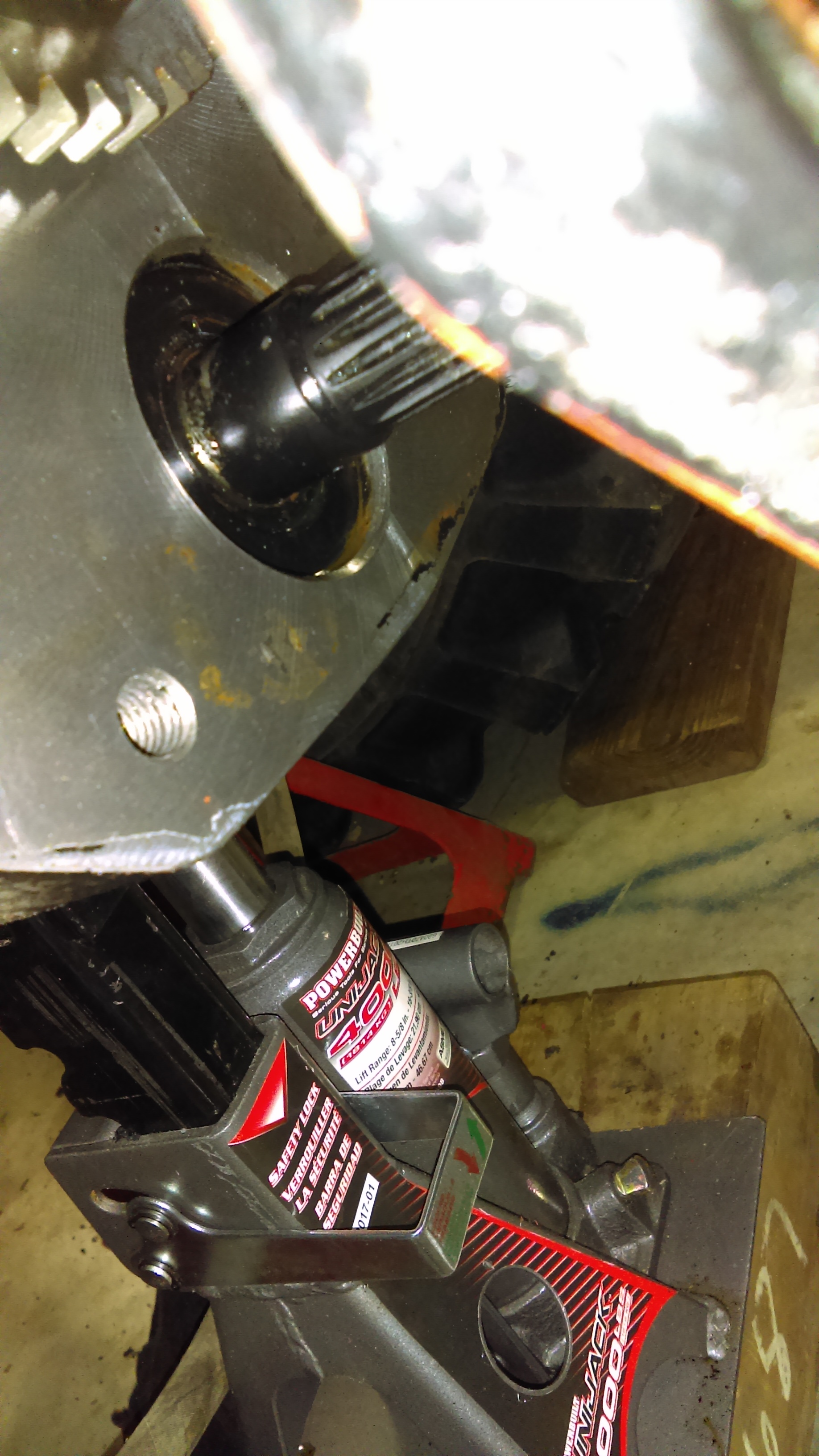

You were correct on that pto being cocked, it was.
new pic of it now
Also, did you put sealer around this large bottom hole that the 4wd shaft does through?. I see the seal at the shaft but mine had rtv black around the hole. I dont think its necessary.
#45
It may not be necessary...but BUT BUT........its a 20 hour tour if it leaks.
so yes put it there....
if you don't surround all surfaces with the silicone and then tighten the bolts it could crack the case where no sticky goo is placed. in this case......GOO is good. Try to keep it even.
be liberal with it use lots of it.....and don't start smearing it until everything to marry the 2 trannys is within hands reach.....atv sealer only has a certain working time it doesn't wait for scattered forks,, bolts,, wrenches or guys having to go to the bathroom. It'll skin over and then your screwed. (I had to peel mine once before we figured out the fork trick).
It depends on the weather I think you guys in Maryland or DC are much warmer over there.but you have roughly 15 minutes to spread the goo and marry the tyranny before it skins over.

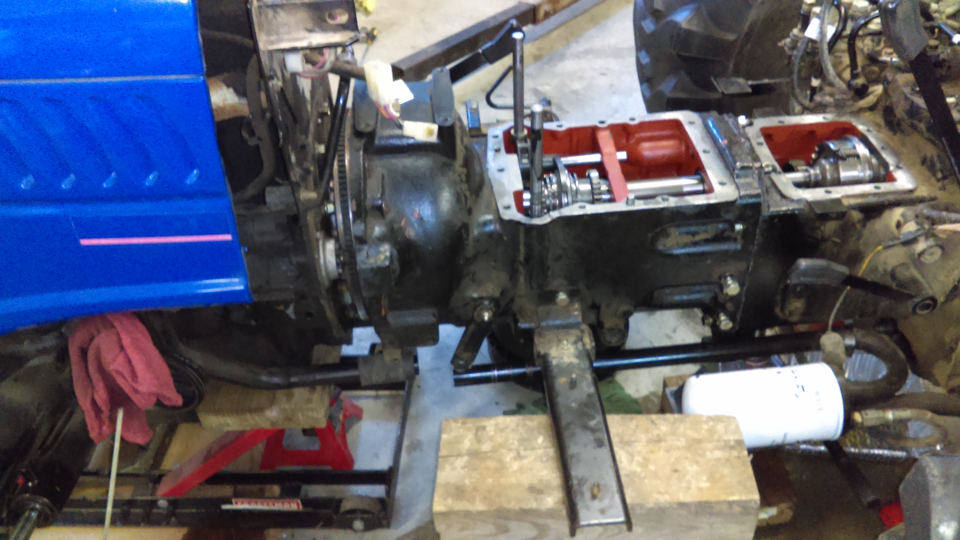

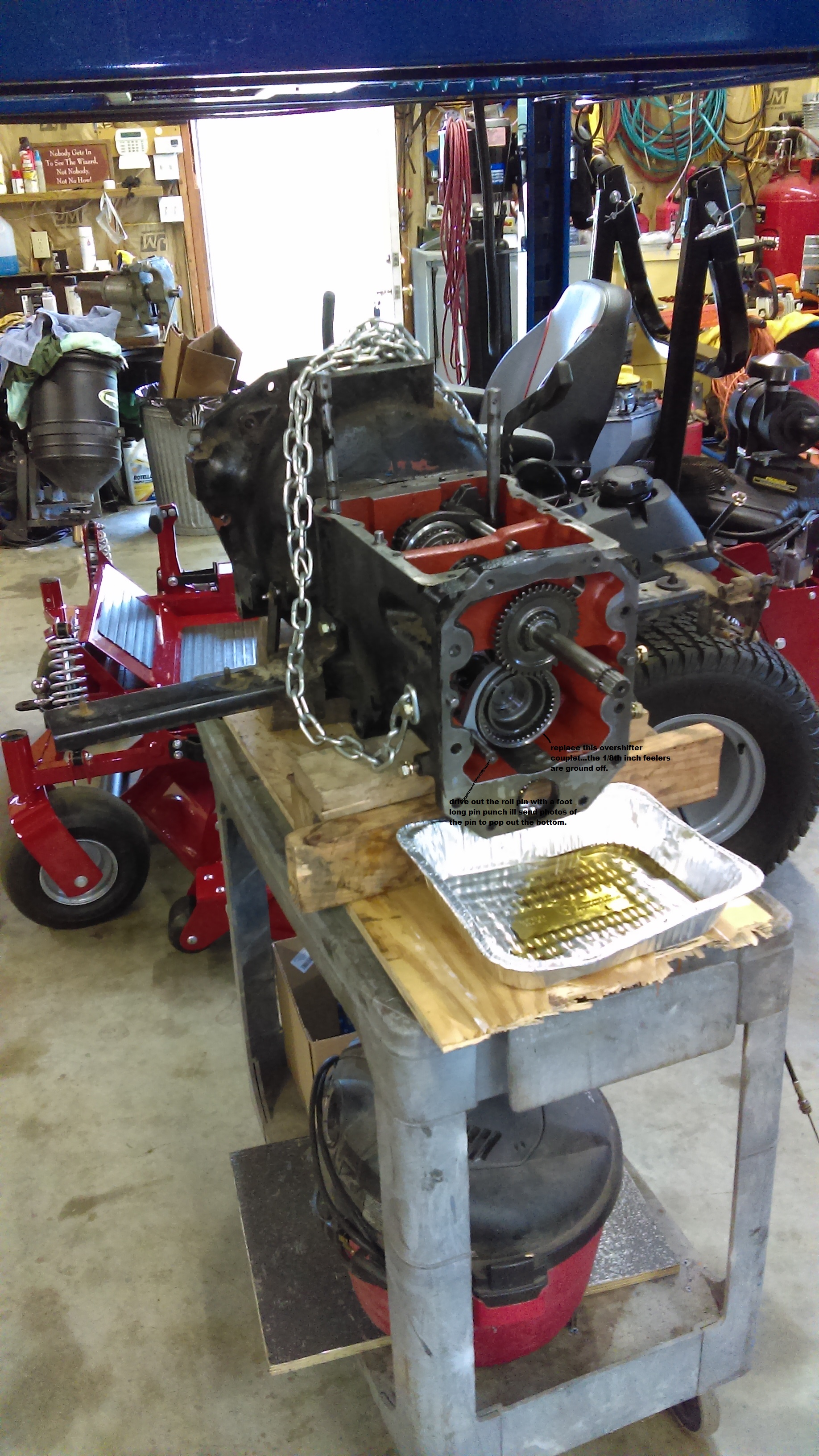

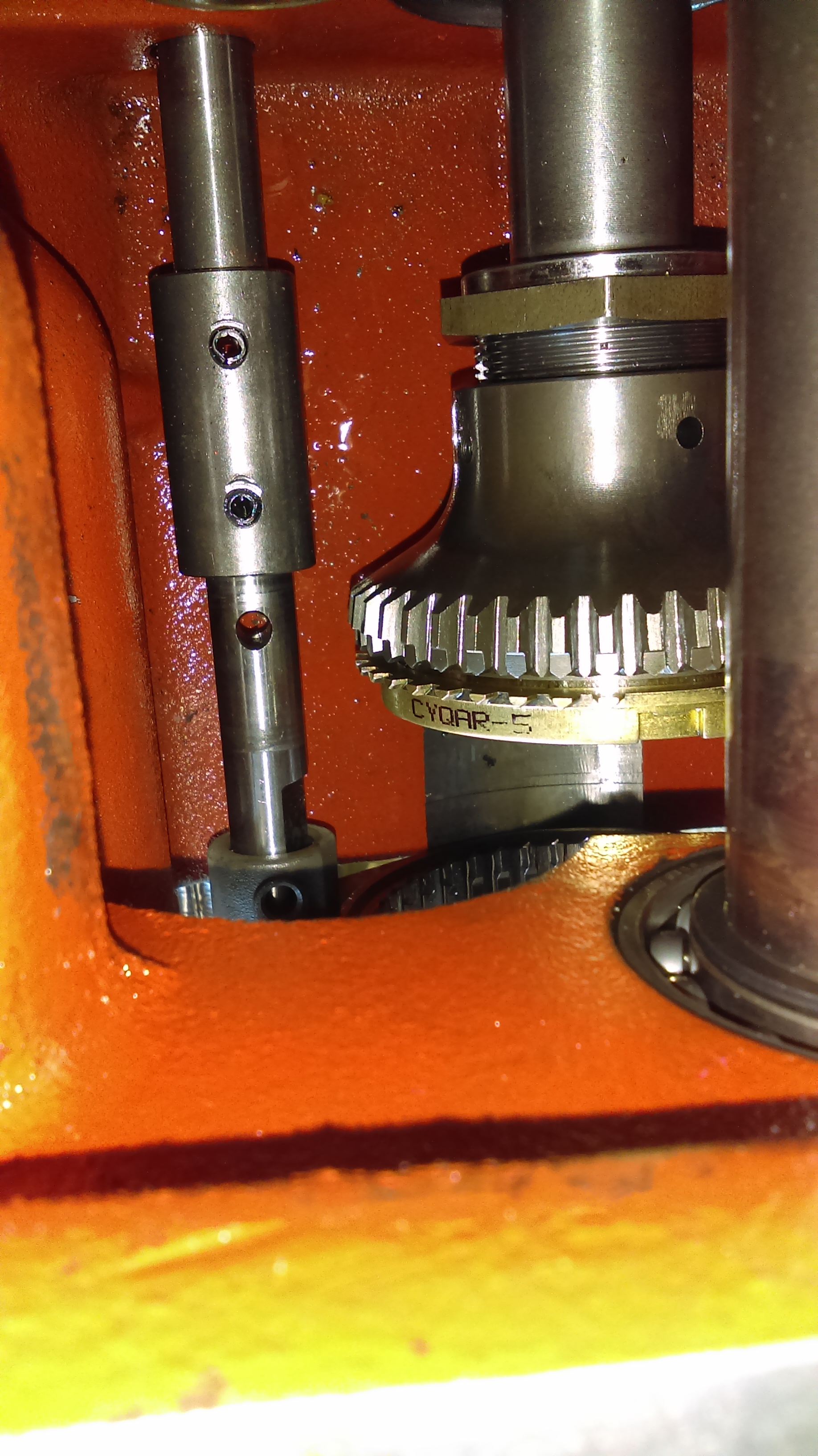

Got a little done today and with no helper it was a bit tricky. I next have to tighten that large nut next.
#47
Am i seeing what I see? its married?
you did that all by yourself.....Holy ****

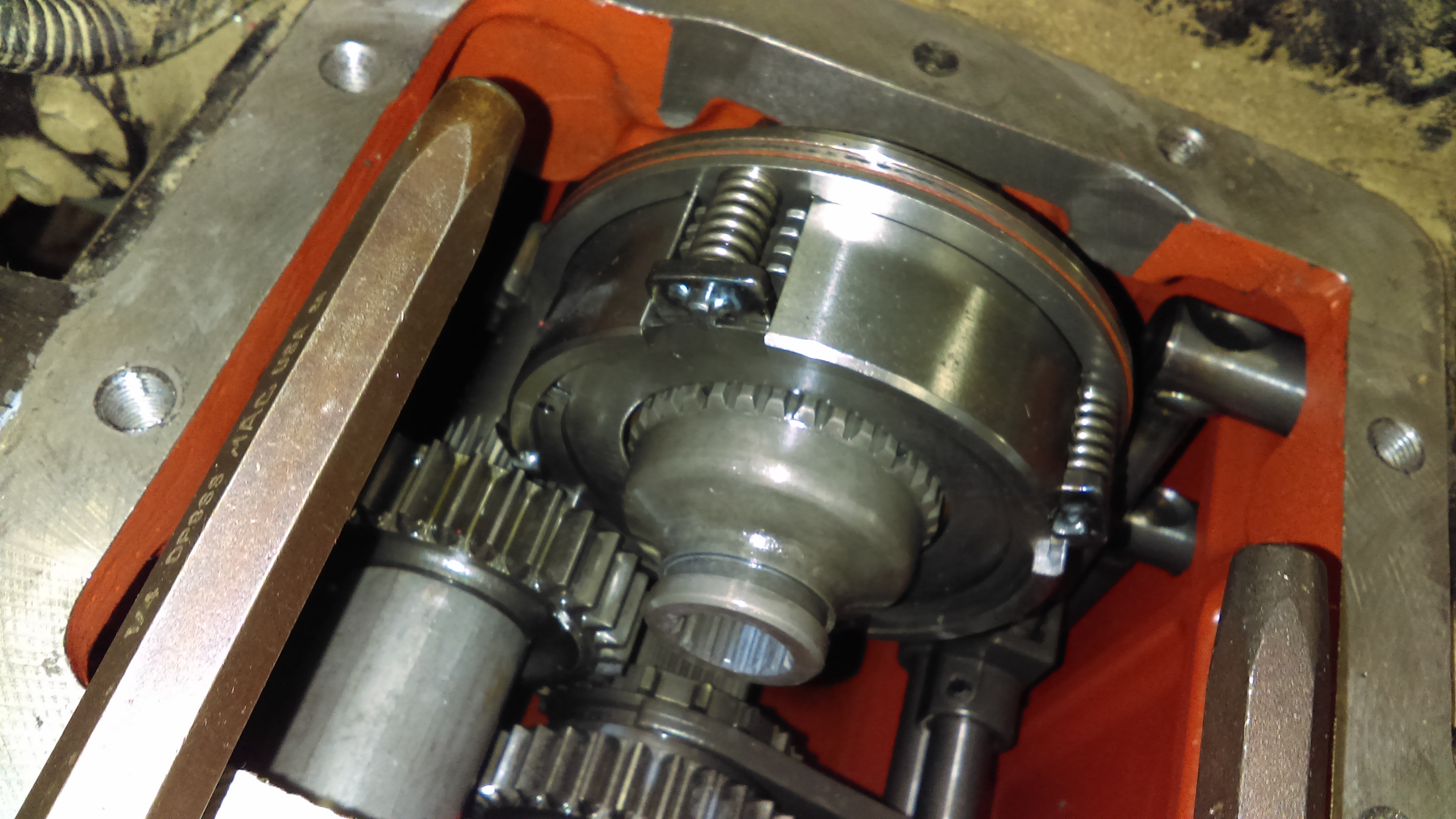

Well now for the big nut......tighten it down tight (but dont reef it.) roll the shaft a bit(shake and pry on it a little.) then crack the nut loose and then reverse course tighten again.take it down 10-20 inch lbs...just finger tight basically.
you can see the large groove in the shaft and the collar on the nut...this is where and when and how you stake it....take a nice thick roll pin punch and hit that collar into the groove.
then enjoy 20 more hours of assembly before your drive it ..LOL ill bet your seasoned warrior by now being your 2nd trip to splitting this thing.
Im impressed......good job well done bones.....

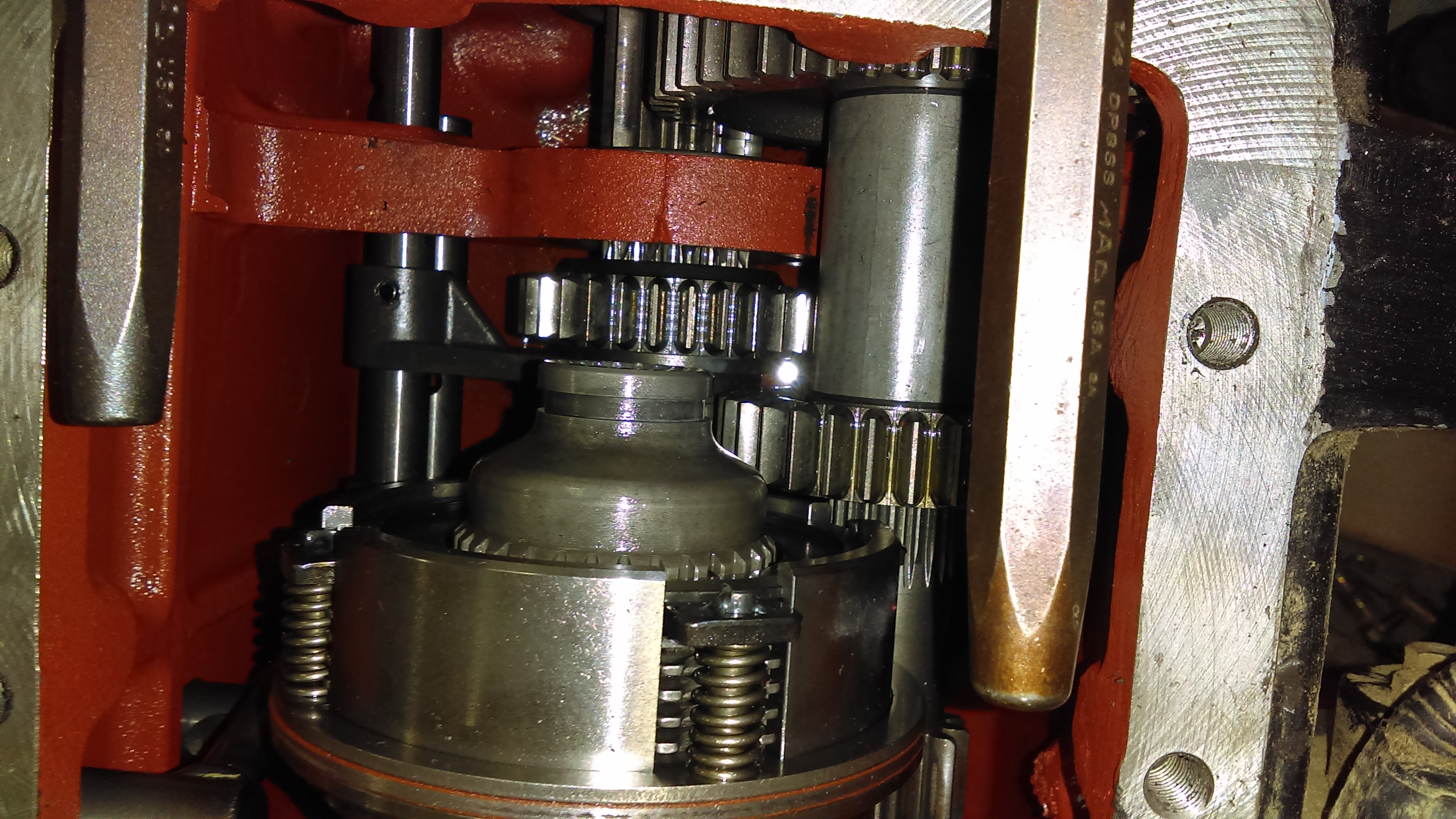

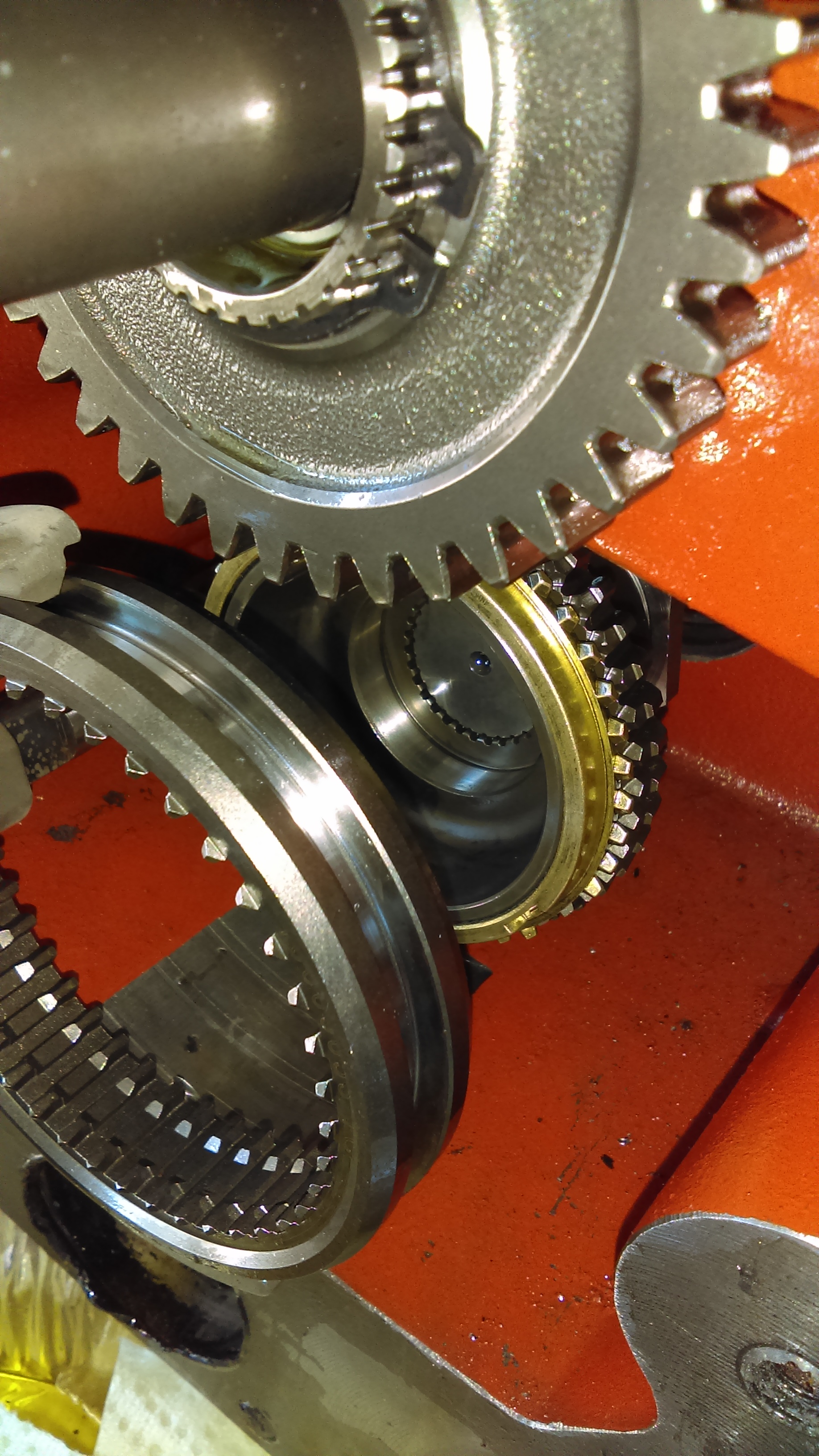

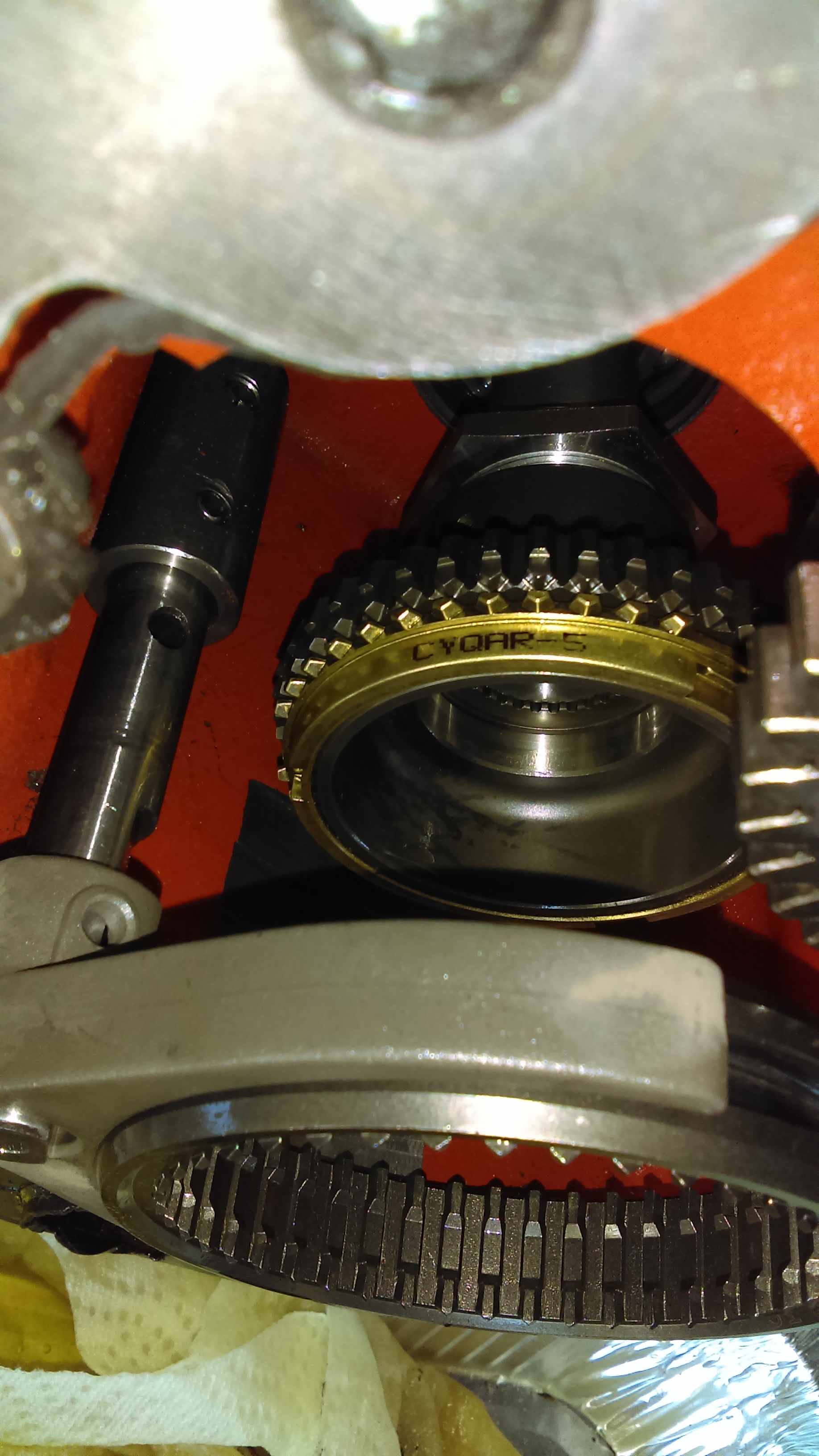

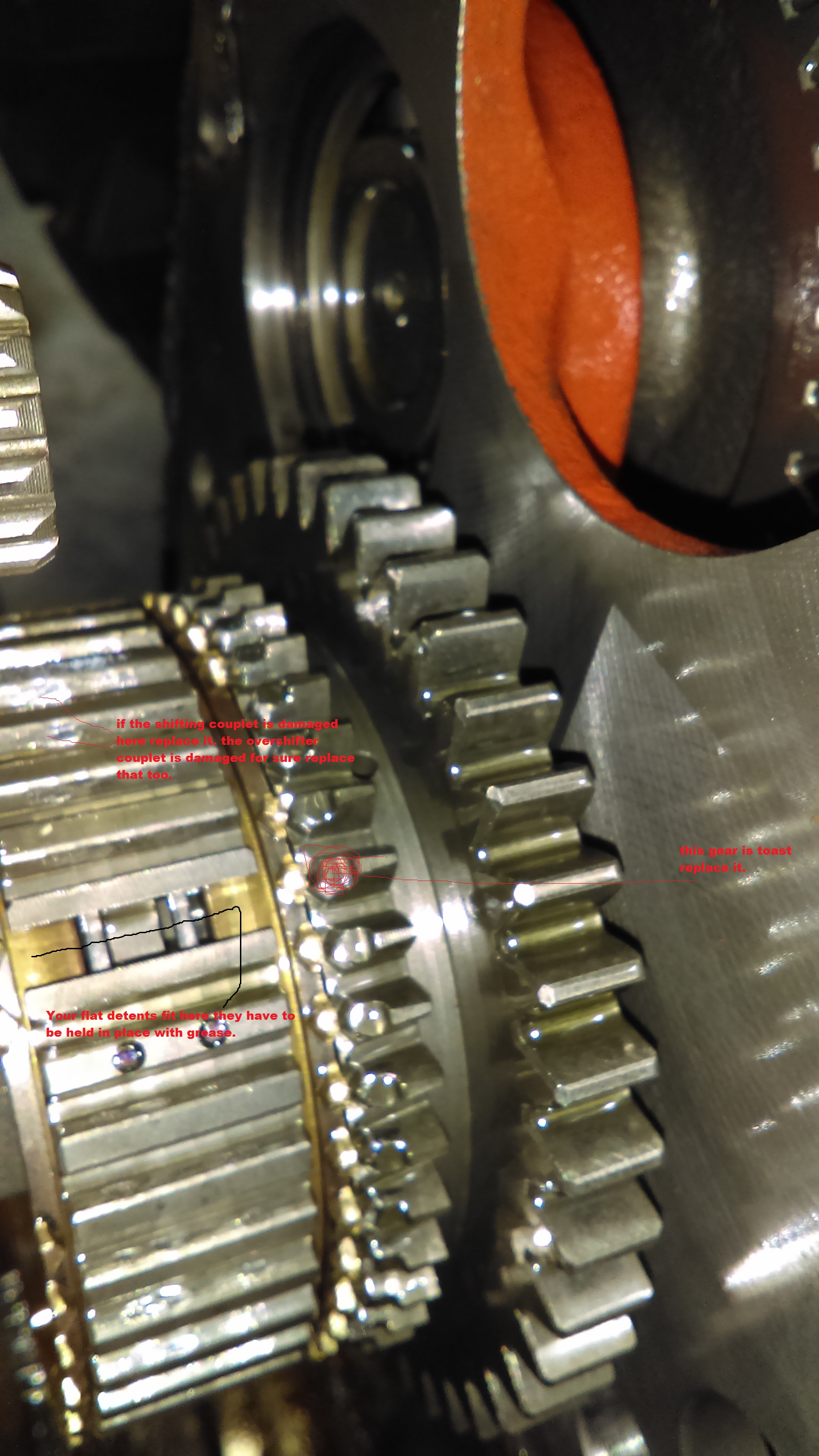

bones Id like for you to double check those detentes orientation.....in the photos you have the F-R shiftier in first gear it appears the horns are up..???.go to you top main shaft and click the range selector in gear and check the detentes on the top shaft....the bump should be up not the horns?
its been a long time since my tour thru the tranny...I could be wrong but please double check. are the detentes in backward....OMG?

Nothing should be rough...I specifically looked at your only detent showing it appeared horns up this leaves the center bump down.
the center bump detente is supposed to ride in the over-shift pocket center pocket to keep it in neutral.
please refer to your upper 1-2-3-4 shaft click a over shift in any speed gear and then compare the detentes it should look identical between the 2.
this is not a big deal to separate the tranny again should they be fouled. you don't have to walk the whole thing out....since you have the tops off you should be able to reach into the guts and flip the detentes should they be wrong.
but yes your silicone job is toast.. and yes you'll probably drive the pin out on the fork again......I assume this should take about 45 mins to a hour if its fouled up.
but re-staking that fork pin inside will be a doosey.

your post from 05-19-2017, 07:22 PM this should be in the right position..but my memory is spotty please check your top shaft.........you were flip flopping this during this post.
your probably going to have to jack one wheel off the ground and roll this shaft to check all 3.

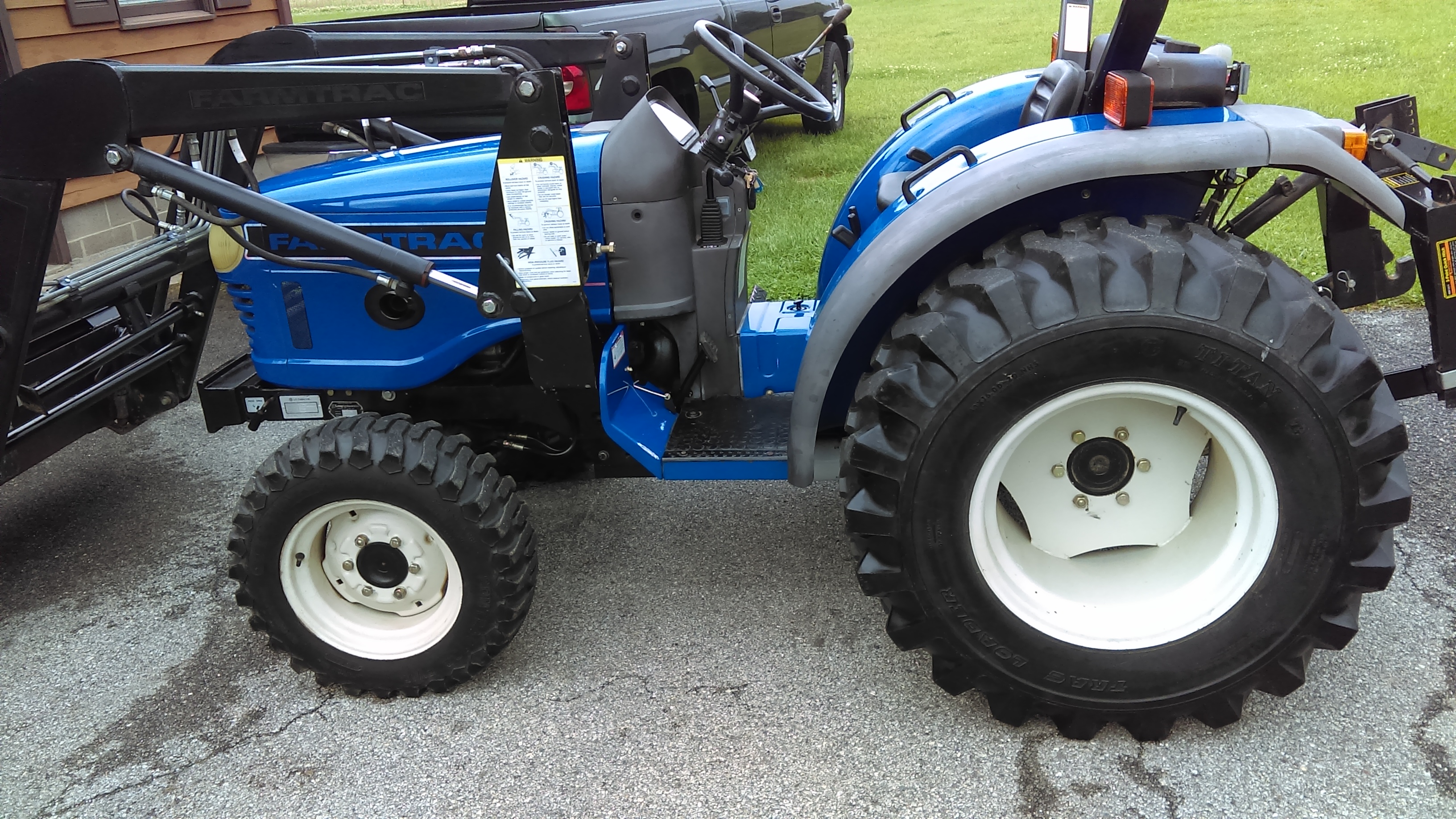

Got it all back together Saturday and it shifts like a brand new tractor.We'll see how long that big nut stays in place!. Many thanks to Spokane1 here on the forum as I could not have done this without his help and guidance, many thanks man! He is correct, you will need a couple years of wrenching to take on a job like this and be successful. Thanks again sir.
