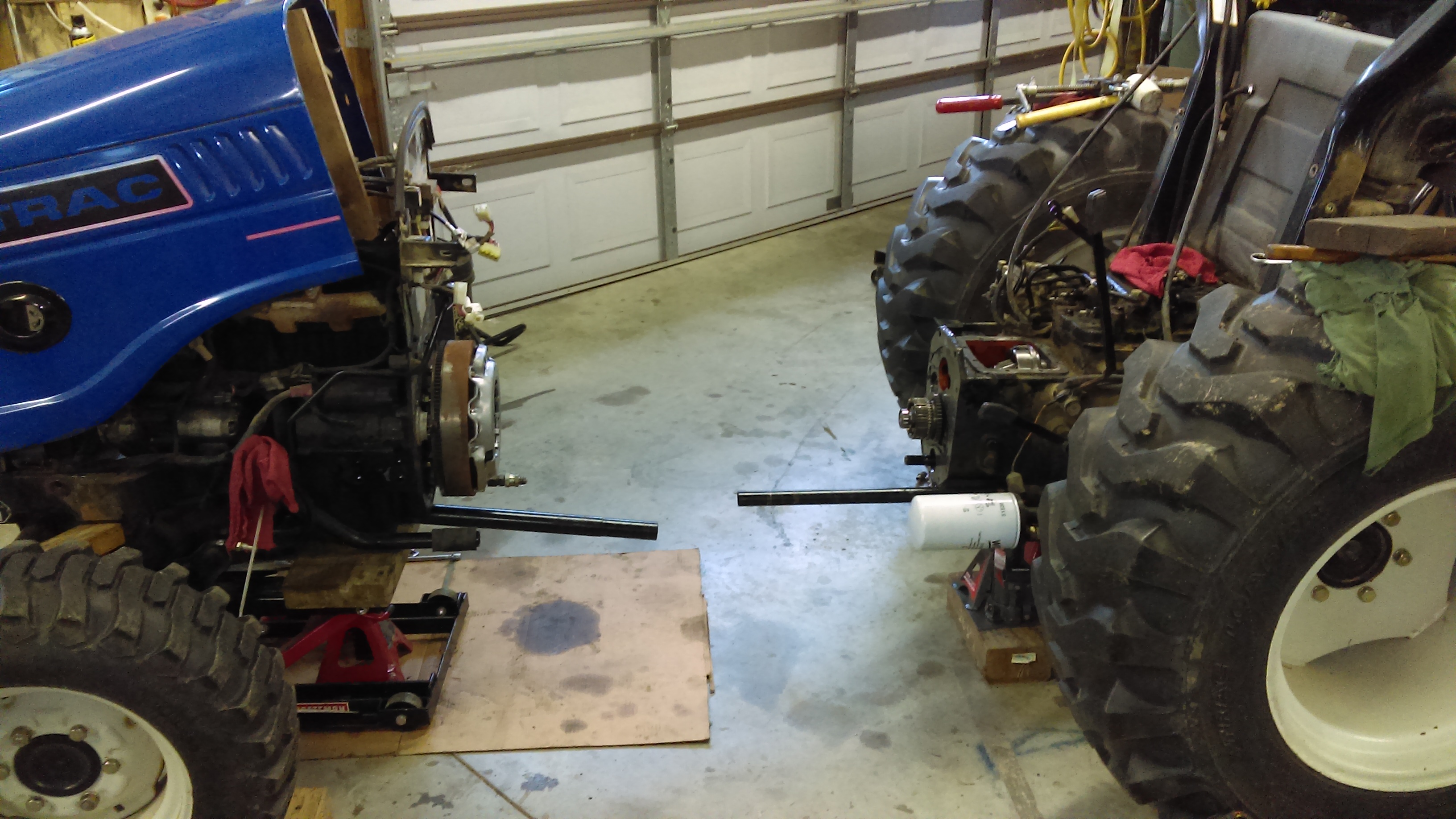

Getting slowly closer. Will try to separate the transmission from the transaxle Friday and see what happens.IMAG0490[1].jpg
I've got real floor jacks and a tranny jack for when I get serious about this.

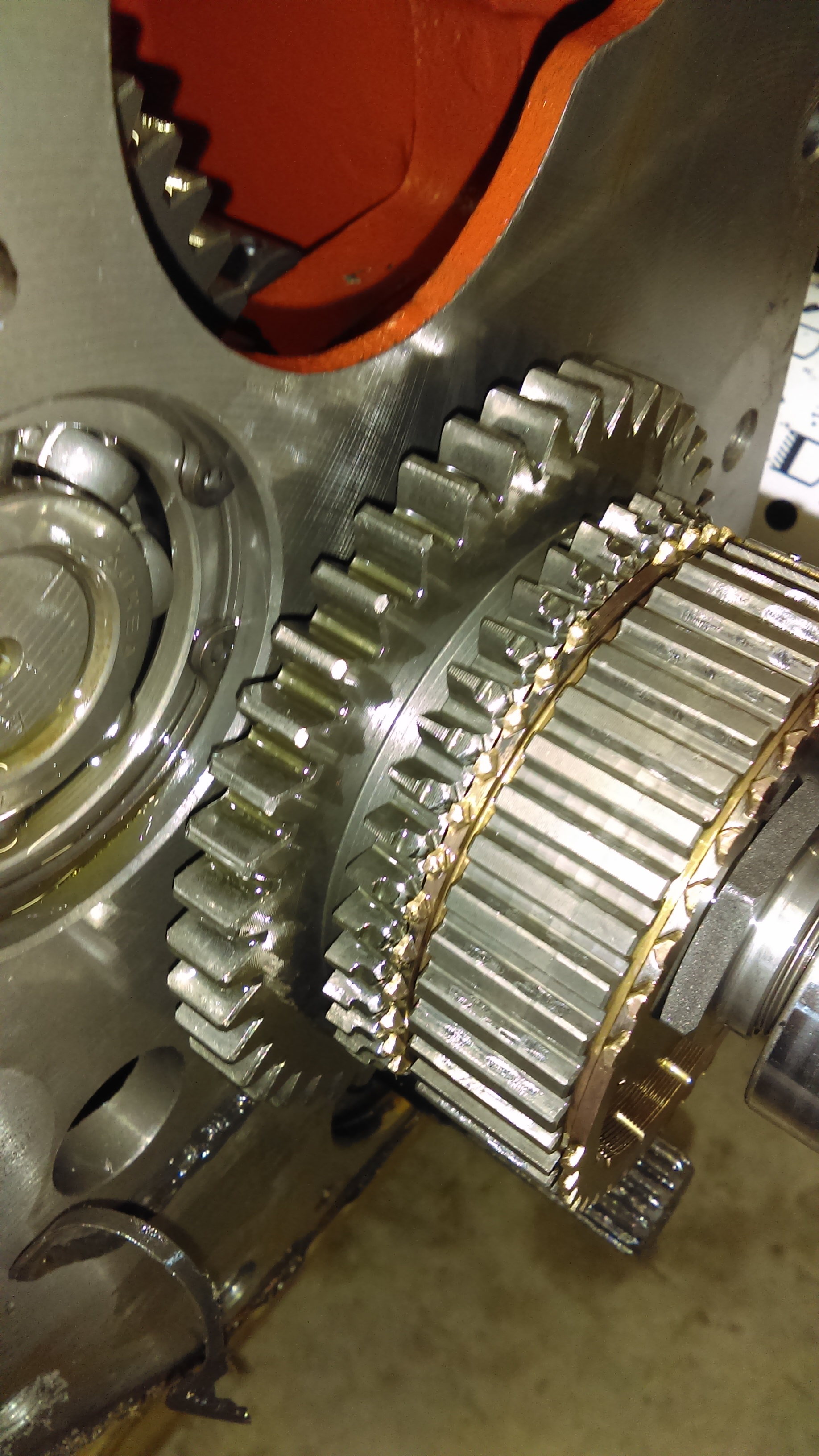

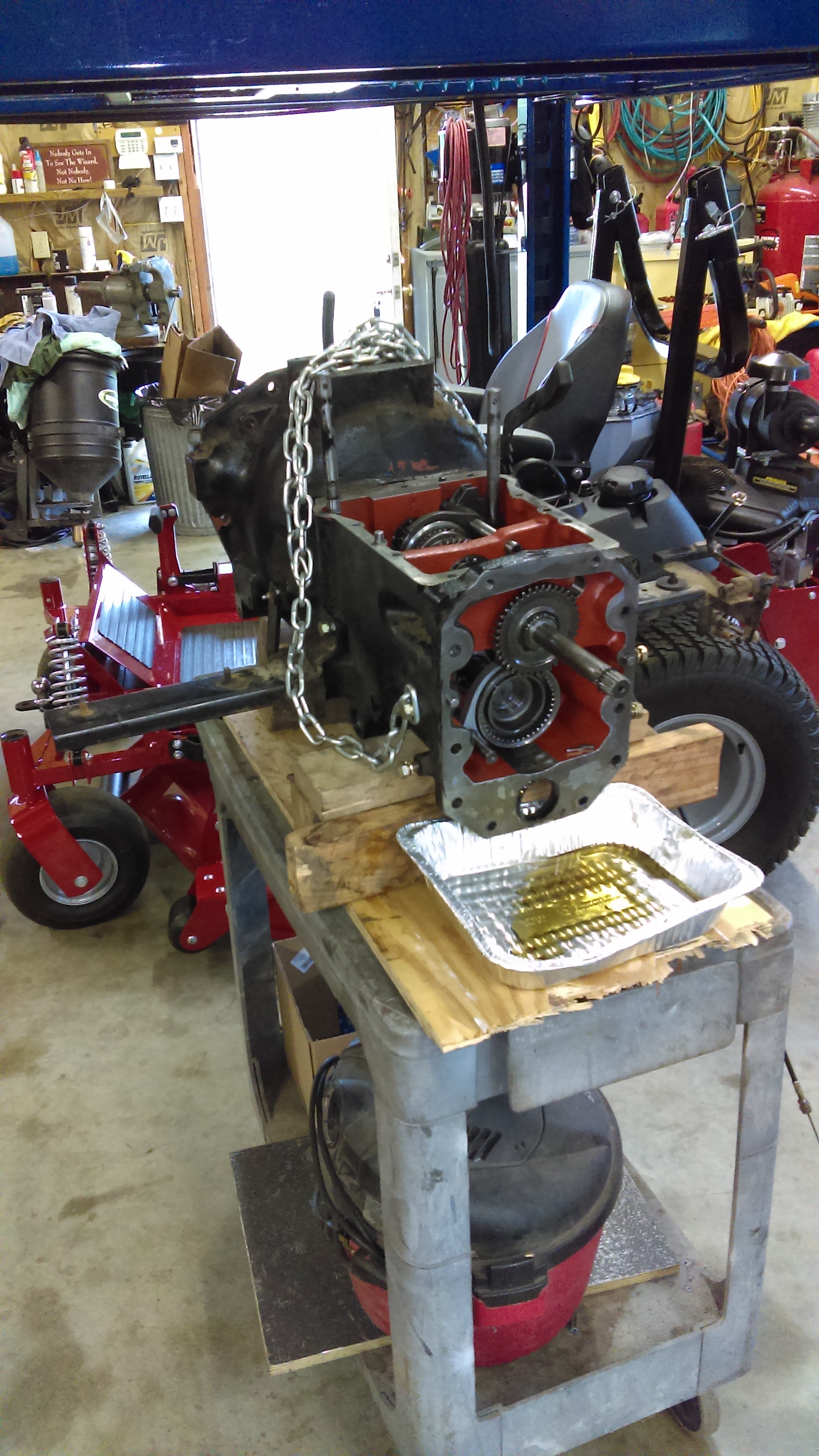

Got the transmission out today and have a few pics. I will need Spokane's wisdom before it's time to go back together.
