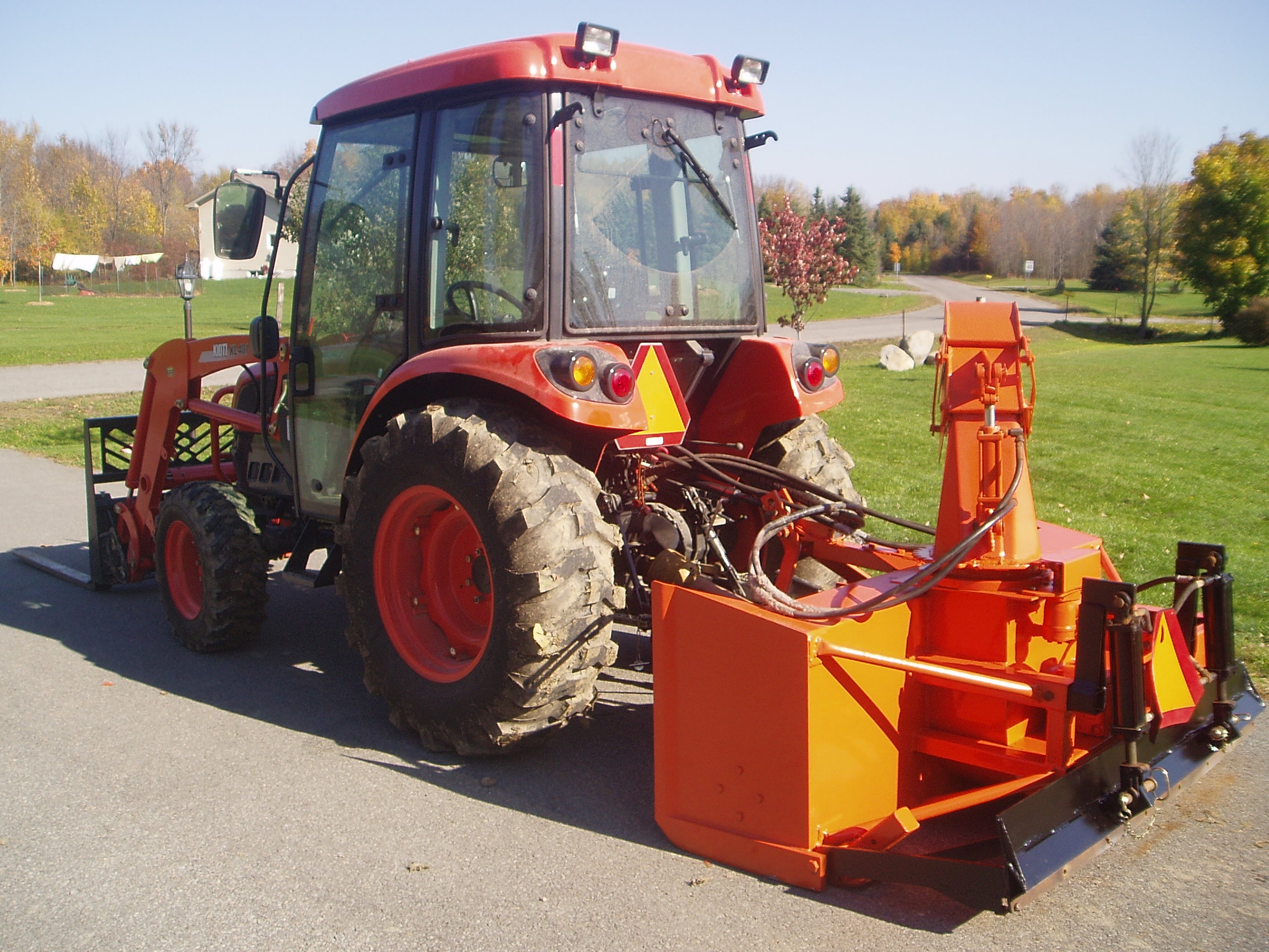

I have a set of 48" that I started using on my Kioti CK30 and now use on my Kioti DK45. I don't think the size of the forks matters very much, but they were too heavy for the CK30 to handle, it robbed too much of my lifting cap. They are perfect for my DK45, it handles them with ease.
I lift pallets full of firewood in special bags. Each bag is almost a face cord and weighs 1500+ lbs once dry. That weight is out a long way at the end of the loader. For that reason, I'm happy to have the forks extend right to end of the pallet. I think the longer forks also make it easier to see the tips of the forks which makes things a lot easier on uneven terain.
My advice, fairly heavy duty 48" forks. 60" will be clumsy and you won't lift much if it's that far from the loader anyway. Mine are Versatech.
Sorry, this is the only pic I have of them right now.
