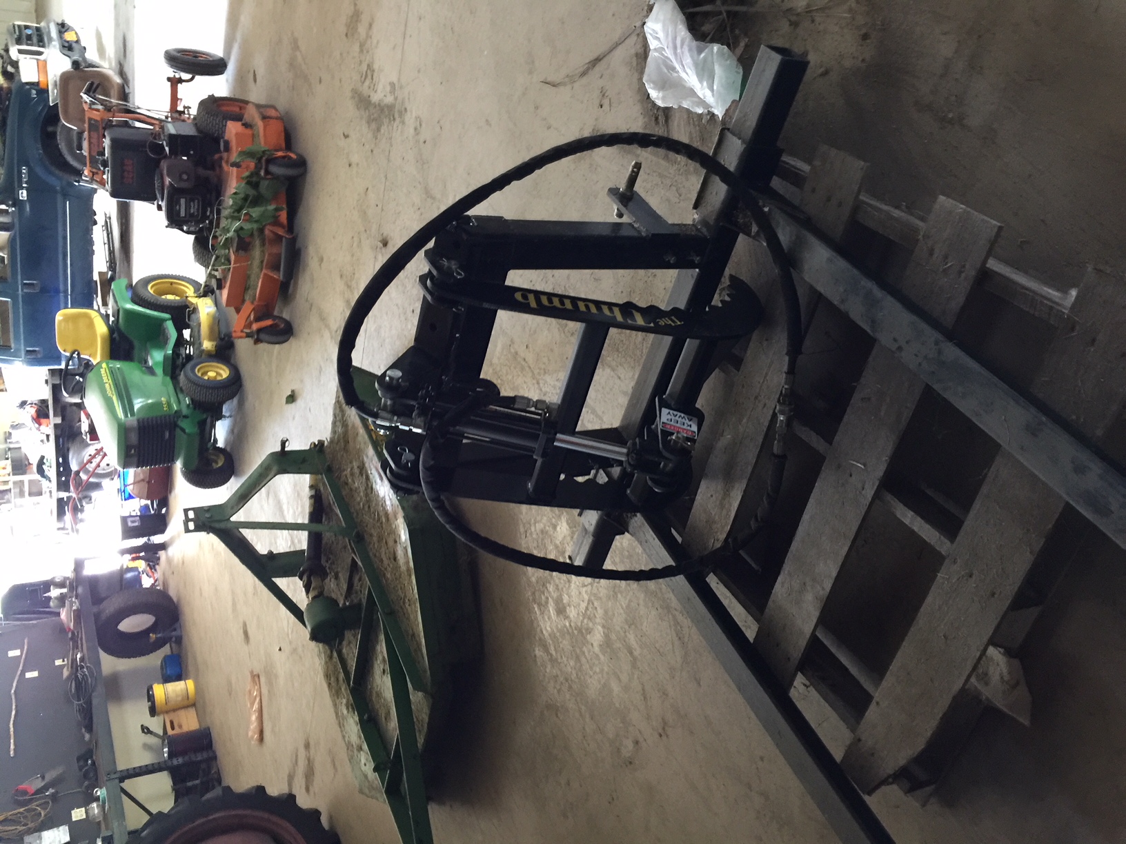

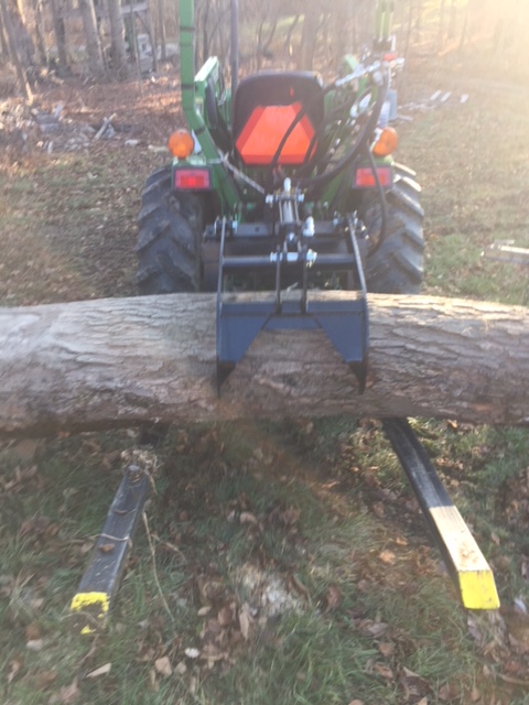

I needed a similar tool to get all my stuff out to the woods and also move pallets around and firewood containers so I put a set of 3PT pallet forks and then added a thumb so I could use the same piece for bucking logs at a comfortable working height. It worked very well since the 3PT can lift much more weight than my FEL

Nice setups in the pictures
